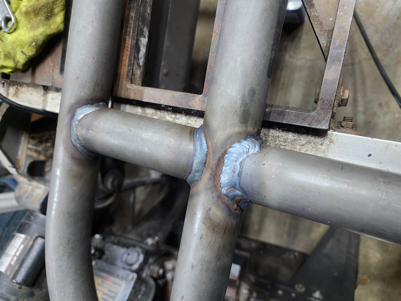

I have never welded before, but decided to just get after it to save some money once again, saving 500$ to go this route instead of bolt on route. I got some trail gear sliders for a good price, then some basic MIG lessons from my partner's dad, and went to town. Did my basic lessons and got them welded on within the same day. My measurements ended up making it look really stuck out, because I wanted both anterior-posterior bars reachable by foot and also flat for roof box access. I will probably revisit the fitment on these at some point, but already used them once during hunting season when I got the first flat since owning this 4runner on a regular gravel road and a perfectly shaped dagger rock so I'm glad I had them on when I did.

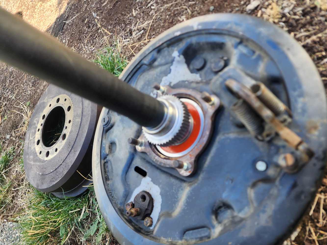

Rear axle seals
Both my brother and I both sprung a rear axle seal at the same time. We ordered Marlin Crawler kits
Rear Axle Service Kit, 1979'-'99 Pickup, 4Runner, Tacoma '-' Marlin Crawler Off'-'Road
I watched timmys video for this and I knew that sometimes this job doesn't go well with machine shops, but I don't have a press. Took a gamble on Clackamas Auto Parts machine shop near Portland. I've been beating on this thing for 5 weeks straight for western oregon deer season and leak seems to be fixed. Total cost was about 275$ to have both mine and my brothers done.

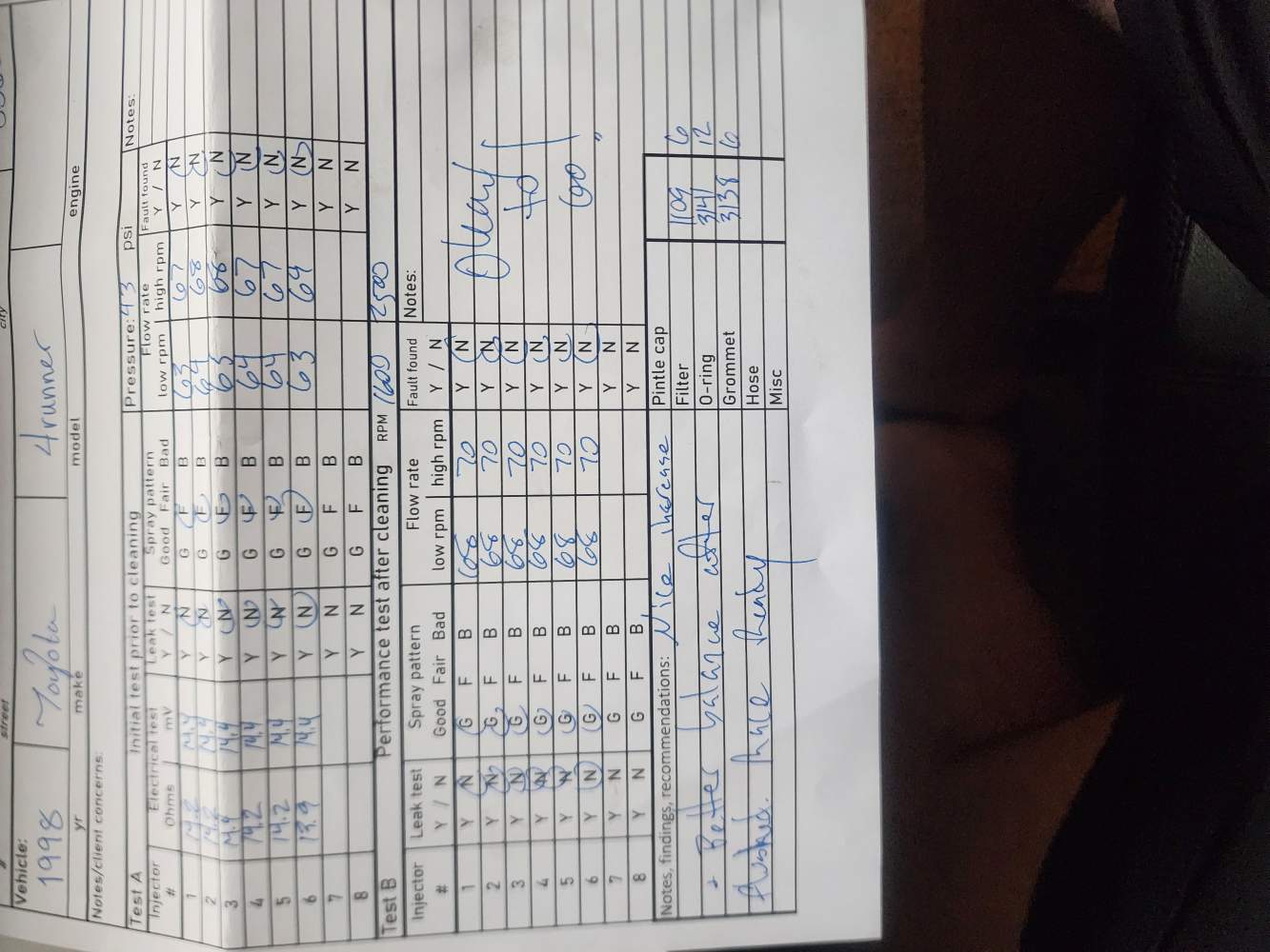

I have had a long standing issues of surging acceleration, only when going 55+, and only uphill. After doing a bunch of reading, I decided to try changing injectors. I picked up some metal style injectors used from facebook marketplace and had them rebuilt by injector masters in Clackamas, Oregon for 25$ each. I'll include the data sheet below.
150$ for metal style injector set, 150$ for rebuild.
I did the injectors yesterday, and not only does the truck no longer have the surging acceleration, it also idles FREAKY smooth.
When replacing injectors, I discovered that someone had messed with them before. I had 1 brown plastic style injector, and 5 metal style injectors. The brown plastic injector seemed relatively new, and the metal ones had some indicators of age.
I'm curious to see if injector masters will run a diagnostic on my old injectors to see what the output and flow difference is.

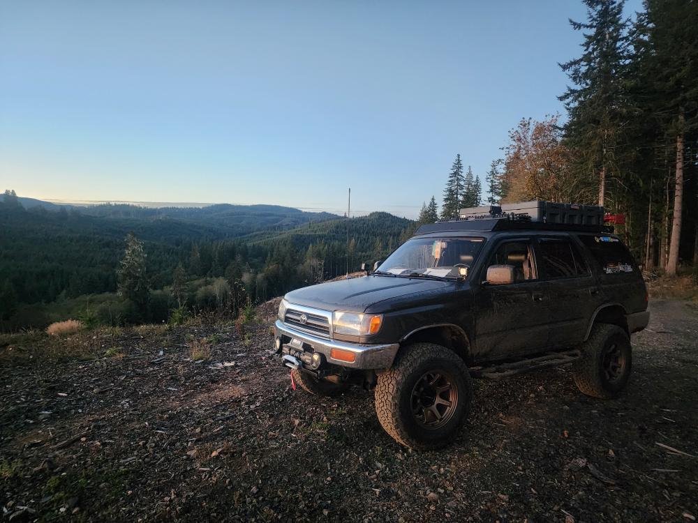

So here's finally a picture of how the truck stands after all the recent changes and a summary build sheet:

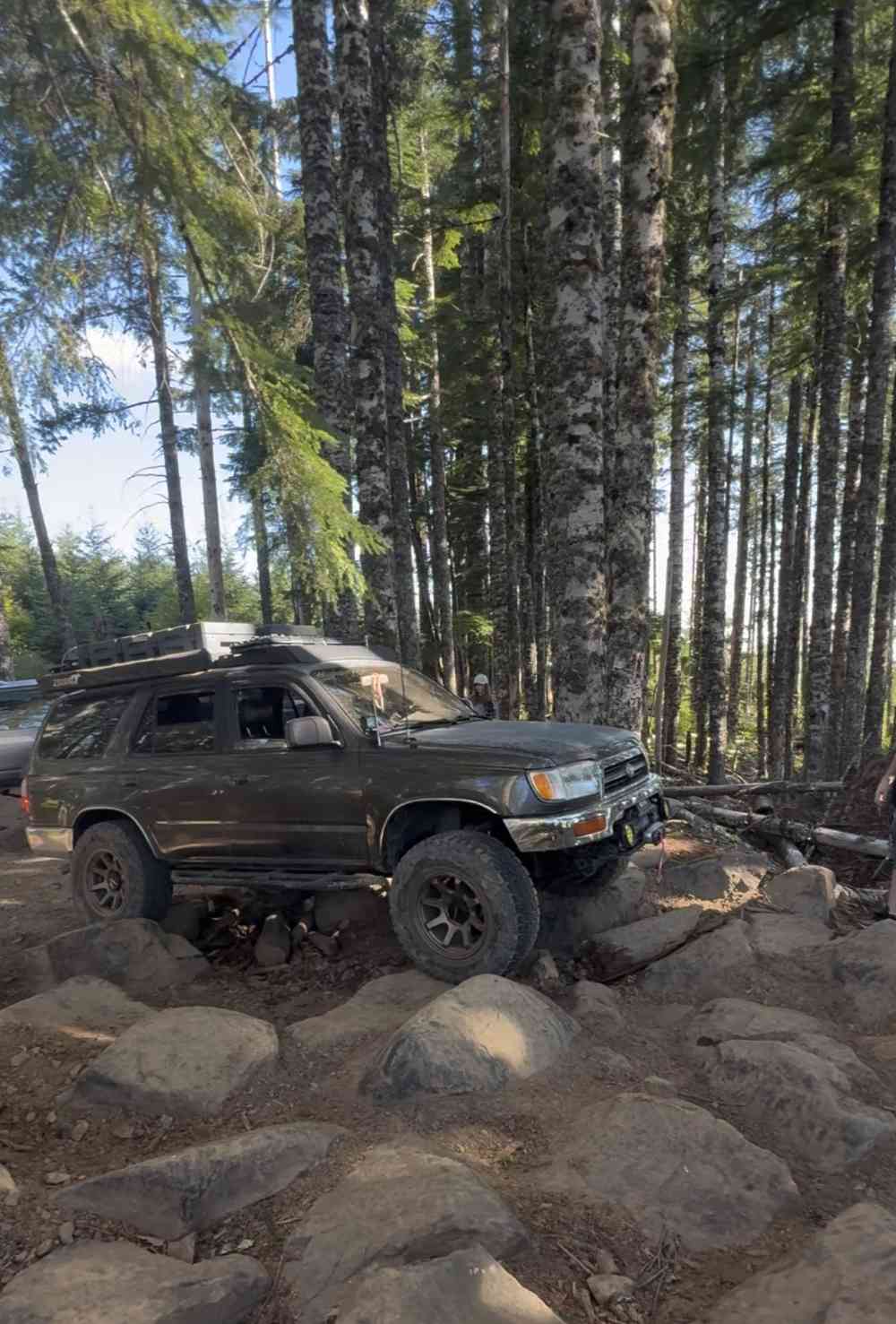

Offroad
-Badlands Apex 12k winch with hawse, synthetic, bluetooth with "custom" hidden winch mount aka harbor freight plate
- Trailgear 67" rock sliders gusseted to frame

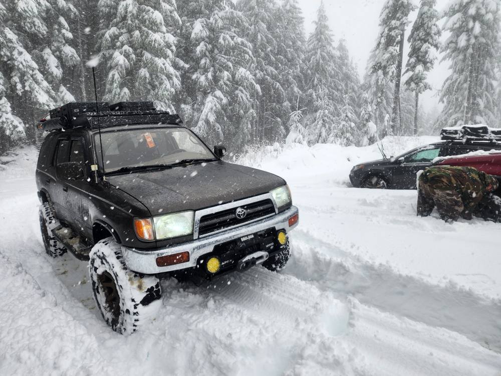

Buddy called for a rescue up in the snow. They were elk hunting and got hit by a bad snowstorm. Chim and I bombed out and made it up to get them off the mountain
Got to stretch the lockers legs a bit, but found having it on caused the whole rear to swing in the snow we were climbing
Overall handled some pretty deep snow pretty well and went smoothly

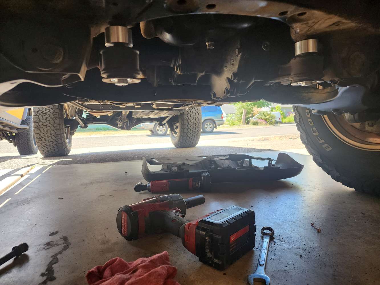

- SRQ diff drop kit ( I was able to bolt up factory skid plate, but tight)

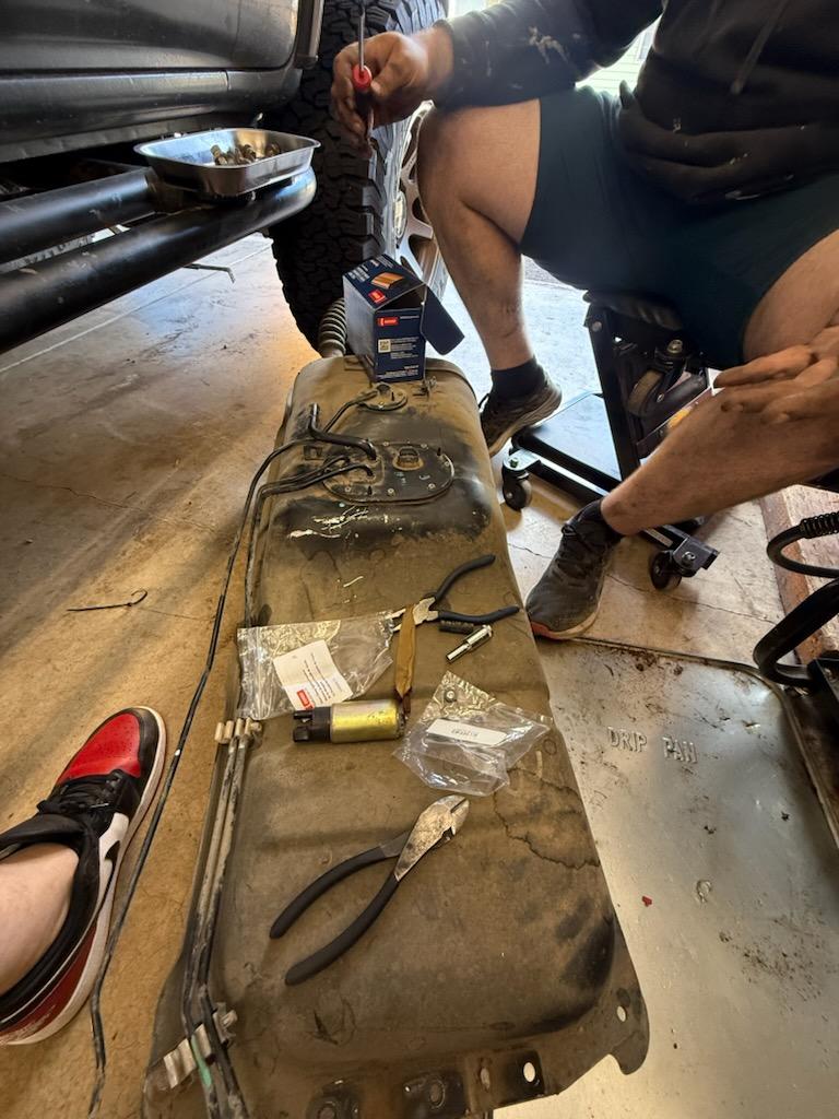

- Dropped tank and replaced fuel pump with denso unit. I started the project by cutting a larger access panel from the top based on TRQ's video () thinking I could avoid dropping the tank. Not so. Hard lines extend all the way down along the center side of the tank and do not disconnect from the top off of the sending unit. Ended up dropping the tank, not a horrible job since I have no rust. Also improved mileage a bit. Overall over 18mph right now, but every fuel system component has been replaced at this point.

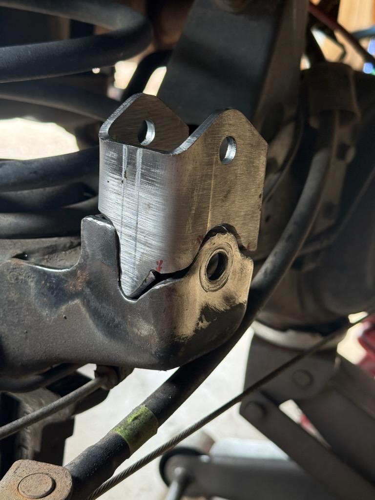

- Eimkeith Panhard correction kit. slapped it in and welded it up
- Welded in gussets on rock sliders. I use them for steps all the time for my boxes and wanted some reassurance against bending over time. I also wanted some peace of mind if I need to use my high lift jack. I've used it once so far, and it flexed the sliders pretty good. For the gussets I just cut 2.5 inch triangles, welded to top of bars and frame.

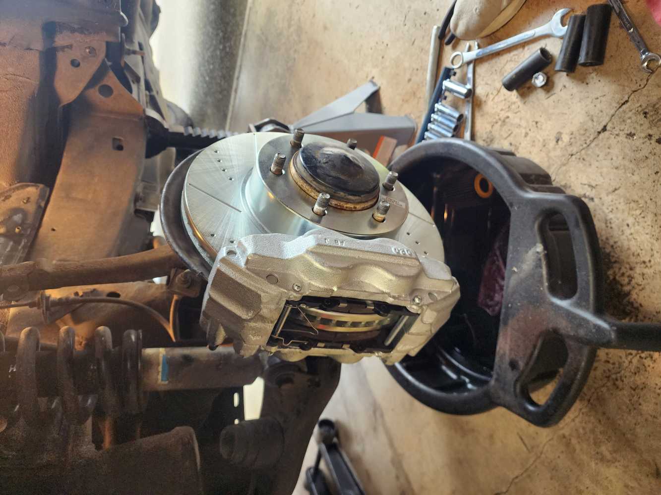

Tundra Brakes done
These things get really hot coming down from 3000 ish elevation for hunting season, but also perform much better.

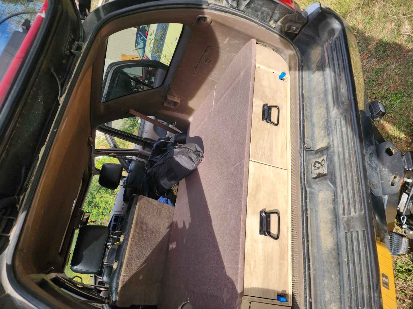

I bought rear platform plans off of etsy from WaveFormWoodworks and followed it to make a sleeping/drawer platform. I'm not a huge platform guy but camping 2 people is much much easier above the wheelwells. Supplies were a few hundred dollars but survived the hunting season well. If I had more time before needing to use it I wish I would have stained the wood before putting it in, as I have some mildew now - I have been using big amazon silica packs which seems to have cleared up the moisture issue.

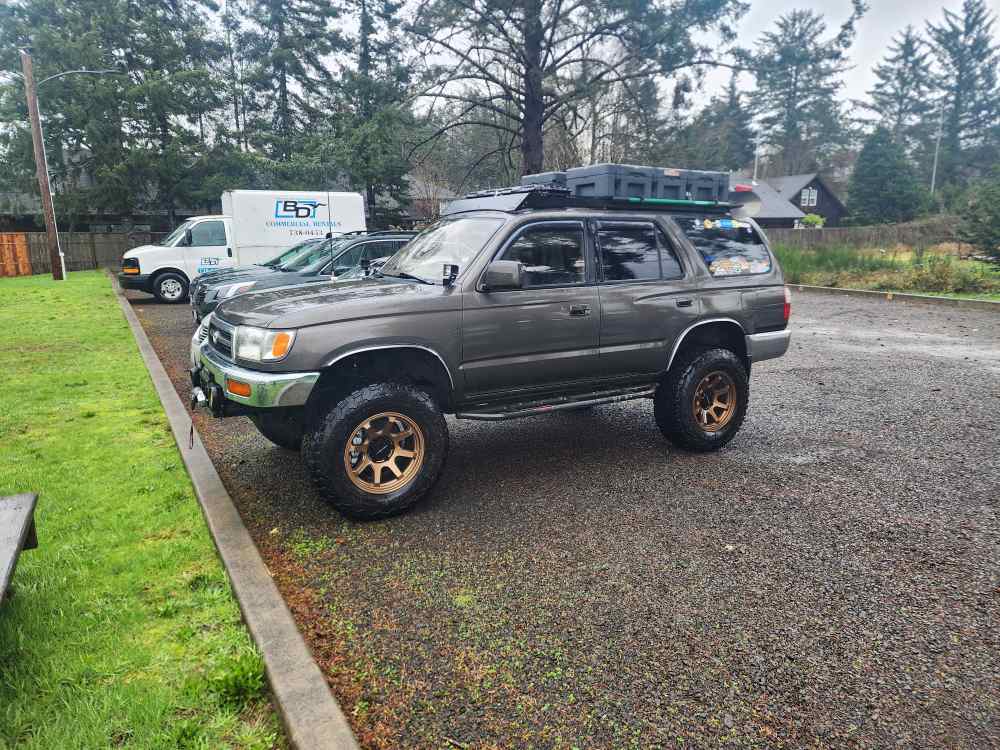

Finally got my front suspension leveled out
I had a previous 1.5 inch front rake with
1st gen tundra trd pro shocks - 883 OMEs
These shocks failed and wore a hole in the coilover top hat causing a loud clunk over bumps, but they were also of unknown age when I got them.
Super happy with change to new normal 3rd gen bilstein 5100 on 2nd to top perch with OME 883 matching the rear.
Front: OME 883 on bilstein 5100 (3rd gen version)
Rear: OME 891 with Bilstein 5100 (3rd gen version)

Nice looking rig! Nice mods too. Got to ask, how tall are the drawers? I'm about to start my platform quest soon and need ideas.
Box from top to bottom is 8.5 inches, the inside depth of the drawer is 5 7/8 inches.
Definitely brings the roof closer to your face but much nicer to have the extra width.
