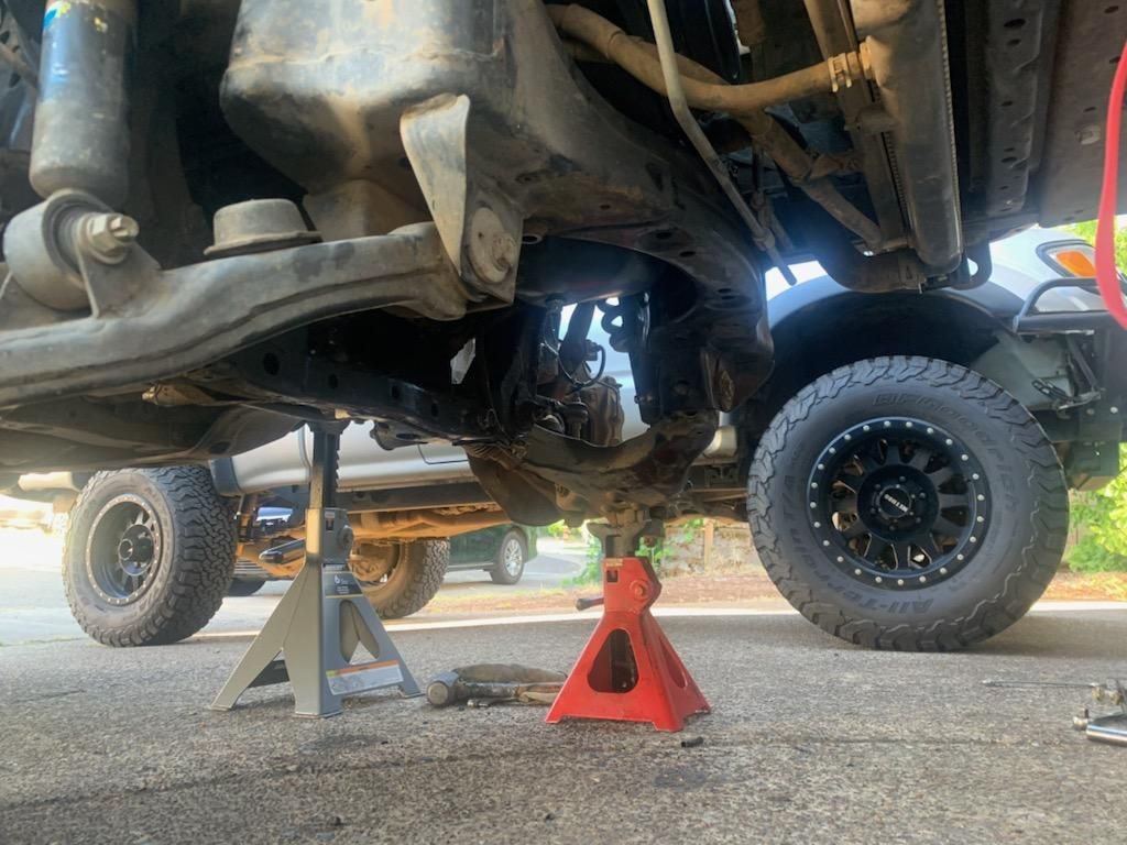

Got a cheap rack from Harbor Freight to hold farmers jack, some off-brand maxtracks, shovel, etc. Everything was feeling pretty wrapped up for the time being until felt some clunking last week and..... CV's toast. Not super surprised since it was working hard without a diff drop yet during the ice storm.
Decided to run the trakmotive extended CV's. They'll be in this week. Found some older threads about them with some mostly good reviews and some people saying they had to try a couple before they worked. We'll see how mine turn out.

Went the same route after mine kept tearing post lift. They’re a breeze to install. I pounded on em for ages with a dead blow and they didn’t want to go in. The telescoping portion would absorb the blow. If you have a buddy handy have them try and compress it as much as possible while you whack on it. I didn’t have a buddy and was able to just heave it in manually. Can’t really explain but if you give em a good shove they’ll go right in. Gettin them off is a little trickier than OEM but you can knock the dust cover off with a prybar and that’ll give you a good little ledge to pry from. I installed mine then immediately had to do the needle bearing. Save yourself the hassle and order the ECGS clamshell and do it it at the same time

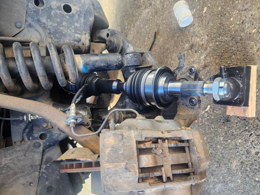

Passenger side CV is in. No needle bearing on this side to worry about. I like the idea of the ECGS mod so I'm gonna wait to do the other side until I can get the bushing. This job went pretty smoothly, just took my time with the axle seal and getting it seated just right, on the inner lip depth.

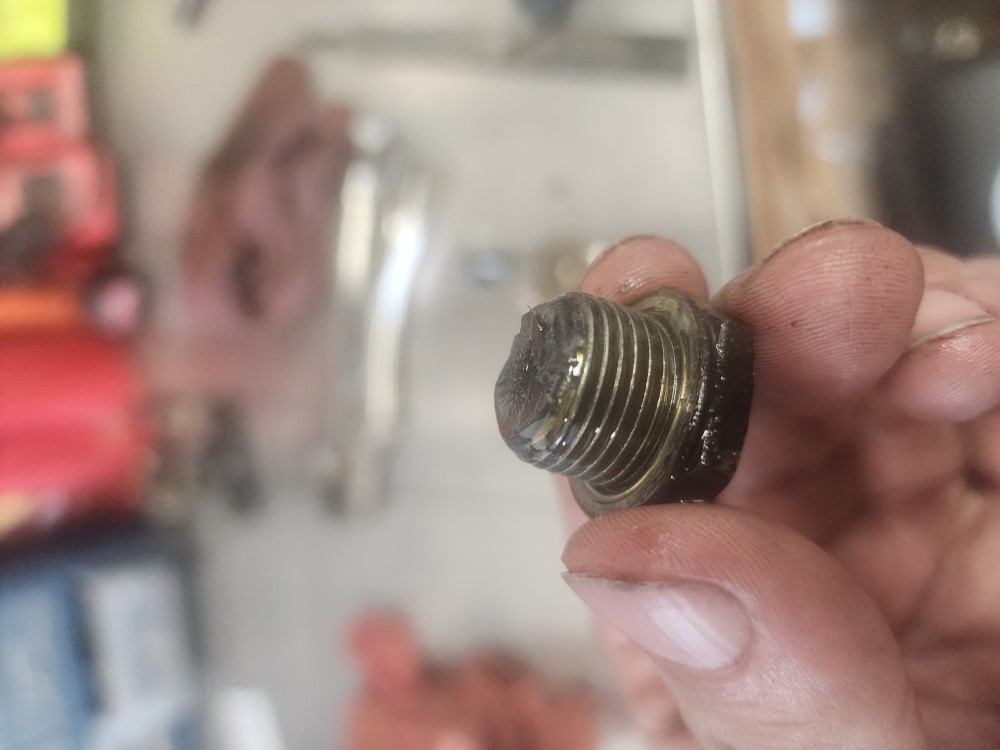

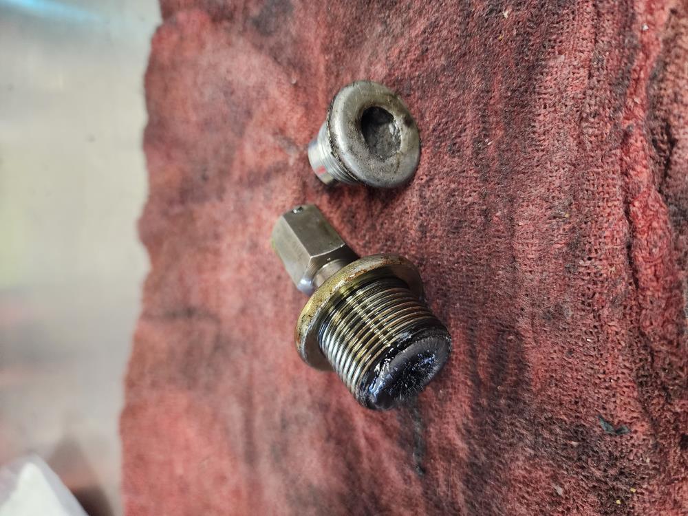

Went to change gear oils, front diff bottom allen bolt completely stripped. Gonna return to that after I get a new bolt to replace it with.
Almost caught up with my current set of parts/fluids!
Remember, pull the filler plug before the drain plug! If the drain plug comes out, great. If the filler plug doesn't come out, that drain plug just screwed you over, so to speak. Besides, if the drain plug is stripped out, what are the chances the filler plug is? Pretty good?

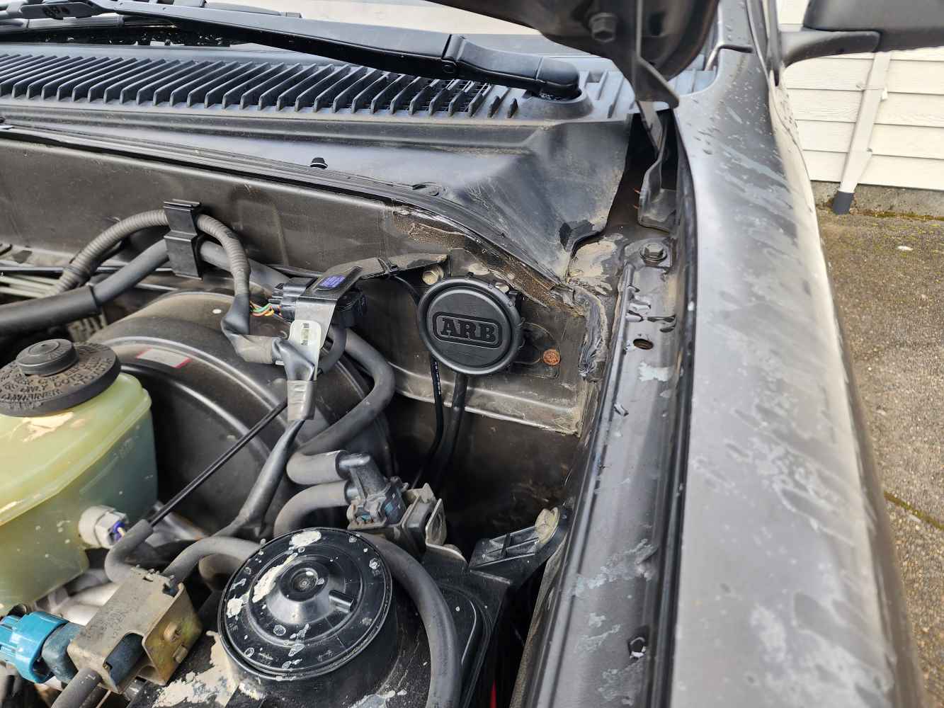

Dealt with my stripped diff bolts today, gonna put on my breather tomorrow! I'm not sure how long its been since diffs and transfer case have had their oil replaced. Generally no sparkles but oil was definitely dirty. Small metal residue on each magnetic drain bolt but doesn't seem too concerning.

Here's where I ended up running the rear diff breather. Not sure if the ARB kit was fully worth the 70$ but happy with how it turned out. FYI the kit comes with enough fittings to run two breather tubes, not all 4. I just hooked up rear diff for now.

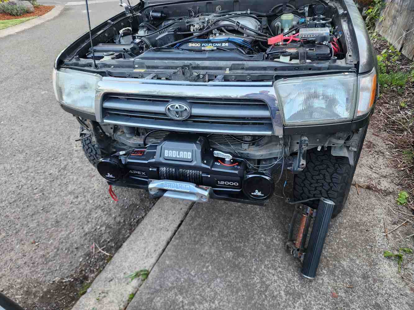

Super excited for the new winch. My homemade grandpa warn winch did save me 2x, but I wanted a little bit more peace of mind. Install was crazy easy. Also excited for this weekend, I am picking up a factory e locker setup from a wrecked 4runner. Going the method of changing both front and rear to the other truck's 4.30 gears and locker. I know I just did a bunch of differential stuff, but I've been keeping an eye out for a decent looking locker set up near me, and one finally came along so I'm sending it. Wish me luck!

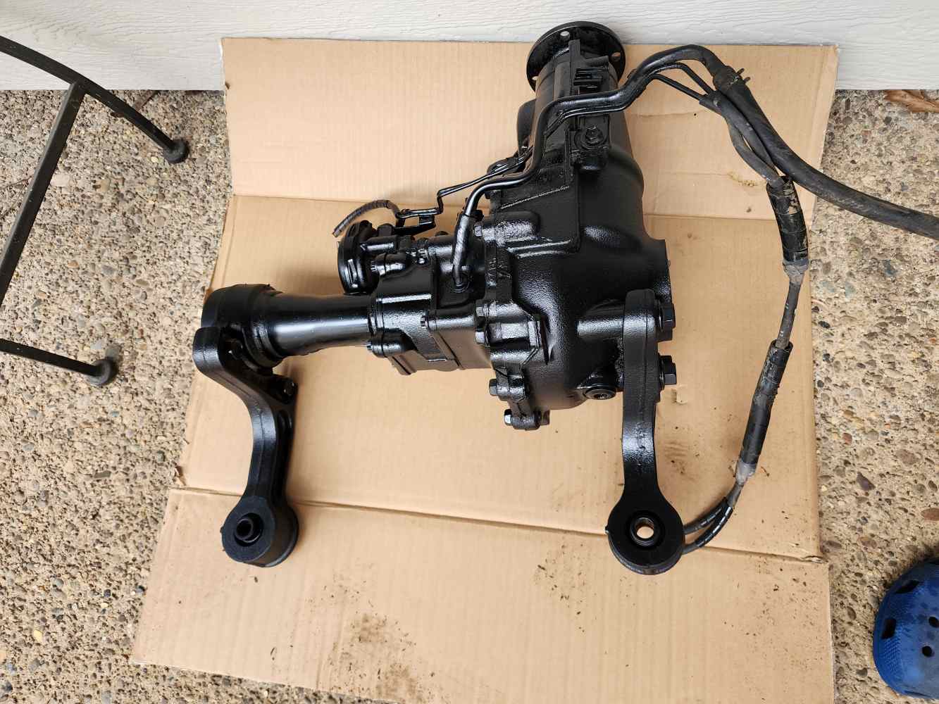

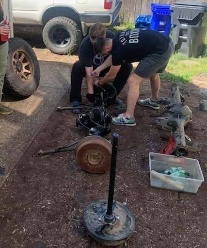

My truck did not come with the factory e locker, and I have been shopping around for different options on what would work best for my budget and driving. My original plan was to go with a yukon grizzly for the rear, but I called 3 local shops that were able to work on installing lockers in 3rd members, and even if I bought the locker, and removed the third member, they were quoting 2k-3k just for labor on install.
I picked up a front and rear axle swap from a guy on facebook marketplace that for 1k, that had the ecu and a harness. Harness ended up being completely wrong, so I had to build my own. I liked this plan because I got the benefit of both the locker and a gear ratio change from 4.10 to 4.30 in all one swoop.
It had some surface rust so I wire brushed down both units and painted them.
Then replaced front axle seals, and ECGS needle bearing. I bought both tools they offer to help the job, and it was very easy since I did it while the new front diff was still removed from the truck. I used Timmy's video and the diagram he showed to build my own harness, with brand new connectors from toyota, the part numbers for which are listed on the same wiring diagram.
I was able to swap the front diff, popped out the trakmotive axle with just a big heave, and finessed the diff out without having to use any tricks to improve clearance to fit it out. It sucked putting back in this way. It took a couple tries to configure the wires right because the pin layouts are not super intuitive on the direction facing if you have no original harness to work with.
Finally, got my actuator noises after chipping away at this job for a long time. Replaced the gear oil with 75-90 conventional. Bought new bolts for all drain and fill plugs from toyota. I decided not to worry about routing the breather to the front diff since the factory location is already high enough for what I need.
Said and done, this took about 1300$ and a lot of work to do myself, but I'm happy I was able to save a couple thousand $ and complete the process.
