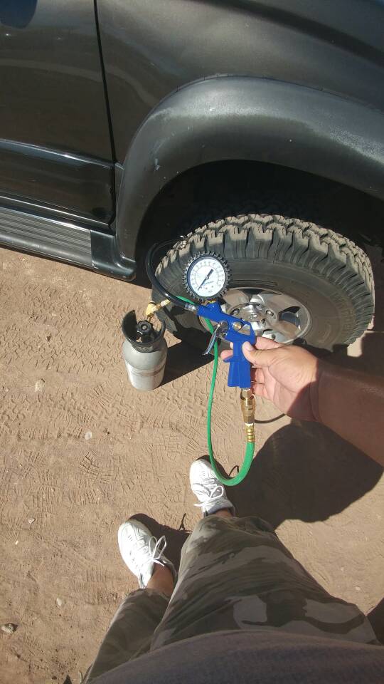

Its amazing. I aired up my tire from 20 psi to 40 psi in about 40 seconds.
I went to my local airgas and got the bottle for $127, they filled it for $6 first time n $20 after, and the 150 psi fixed regulator was about $66. So in total I spent $219. I could have gotten stuff a lil cheaper online but I was impatient lol

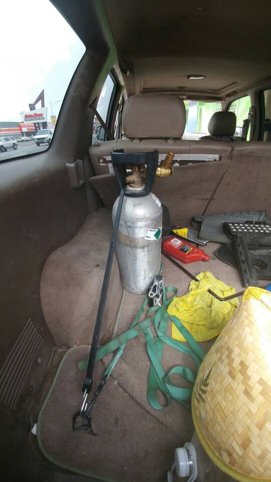

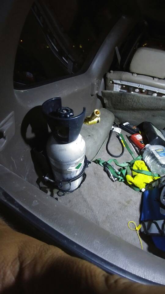

any idea on where to mount it with the quick fist? ive seen a lot op people mount it horizontally but when they need to use it they take it out. i will be taking it out to use it as well. the sides of the cargo area seem all plastic
This might help

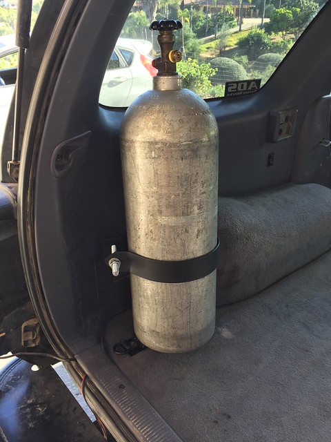

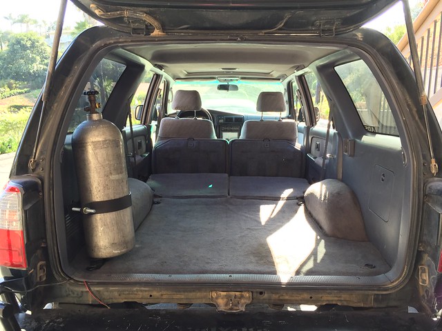

Built my CO2 tank mount over the past few days. Basically, behind the plastic, I welded in a cross member that this bolts into. You can basically just spin the actual clamp part off in about 15 seconds and it will be as if nothing was ever there before. Super beefy, hoping it doesn't move. All I have to do is roll down the rear window to air up.
Untitled by Connor Rhoades, on Flickr

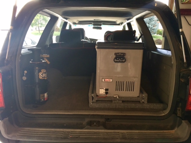

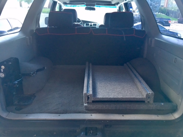

Here is how I mounted mine.
did you drill it into the floor? or make a mount to the side? and where did you get that bracket?
The bracket came with the tank when I ordered it. I think I ordered it all from TRDPARTS4U and it is made by "The Source".
It is drilled into the plastic panel and then it has two fairly stout pieces of metal that go behind the panel that act as a brace. I believe I then put one screw in the floor so it would keep the bottom from moving around and loosening up the side mount.
sounds like a plan. i think i will go this route. thank you for your help mountain mike
still trying to figure out what he welded. ill try and figure it out and post results here.
Behind that interior plastic piece, you'll see a metal brace near the fuel filler, and then you have the wheel well. I welded in a boxed piece of steel in-between those 2 pieces of metal and that is what my CO2 mount screws on to.
I should have taken more pictures, my bad.
no problem. i pretty much just bolted it to the floor. it seems solid. if it gives me any problems ill have to figures something else out. im taking it out to ocotillo this weekend so we shall see thank you all for the help
