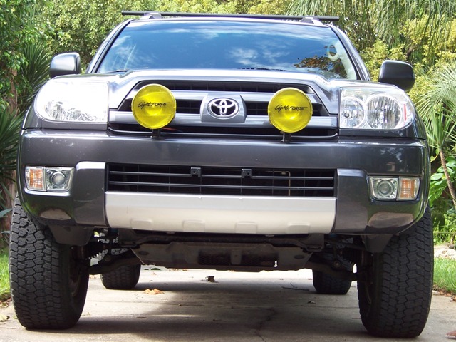

I work over by Riddle. Let me know if you want to check out my set up. I put them directly on the bumper.
I also run 2 side lights off the frame and a back up light. Electrical stuff comes pretty easy for me.
I put these LF's on back in early 04. Yet to have an issue.
I was thinking about adding a 3rd in the center - I like that look and it would throw some mad light. You should go for 3.

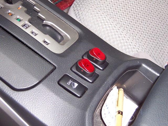

I used the blanks for the switch. The inner on is for the front lights and the outside for the side lights on the frame. Got the switch from Raido Shack - they light up red when on.
The back up switch is in the blank lower left of the dash.

I have the clears as well - only put on the yellow during bad weather. No worries - there are a few here that put the lights directly on the bumper like I did. I like sharing ideas but.....Step up your game and run 3 across the front.

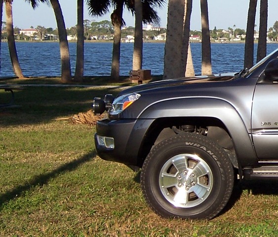

Not the best side shot? Vibes are not and issue.
