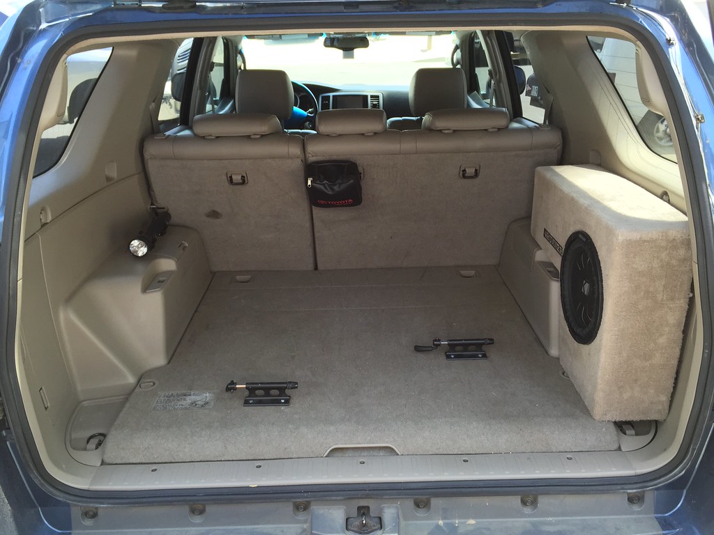

Here is my custom box i made.
It's like the same as the one above
This is the best picture I have. I'm in school right now its essentially an L with an angled piece next to the wheel well.
i used L brackets to mount mine. honestly velcro might do a decent job holding parts of it if you don't want to drill

I made a bracket on the front of mine that bolted to the place where the tie down was located on the floor. Then I made a bracket that screwed to the back of the box that bolted to the wall where the bungie tie down was located. You can see it partially on the top. That pulls out and has a square hole. Perfect for a carraige bolt. Hope that helps.
I ended up mounting it to the old tie down location for now. I still need to make a bracket for the top. I'll post pics later.
