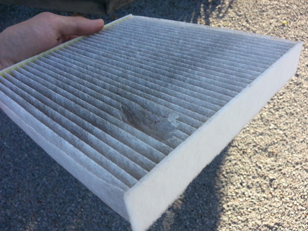

Thanks for the responses. They chewed half way through the cabin filter and left droppings in it that I've been breathing in for a week now. I'll be trying a combo of trunk cat and bounce sheets next time :)
