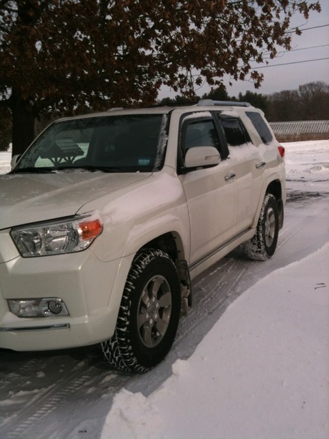

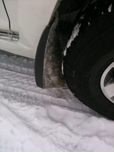

Husky's Lifetime Warranty!
They fit perfectly and keeps the sides clean in the rain and mud!
My SR5 came with the factory running boards installed. If you slide the boards back 1 1/2" on each side the front guards will mount. It will look a lot better if you just cut 1 1/2" from each running board...
It took some time, but it is well worth the effort. Very easy if you have a miter saw with a metal cutting blade. Cut off 1 1/2" in a 27 degree angle clean up the burrs and cut back the rubber mat 3" from the longest end in a 90 degree angle to reinstall the end cap.

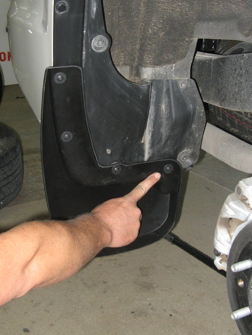

Installation question
I have the OEM mud guard kit and if anybody has installed them, do you then put the liner back over the mud guard after you attach it?
Thanks
