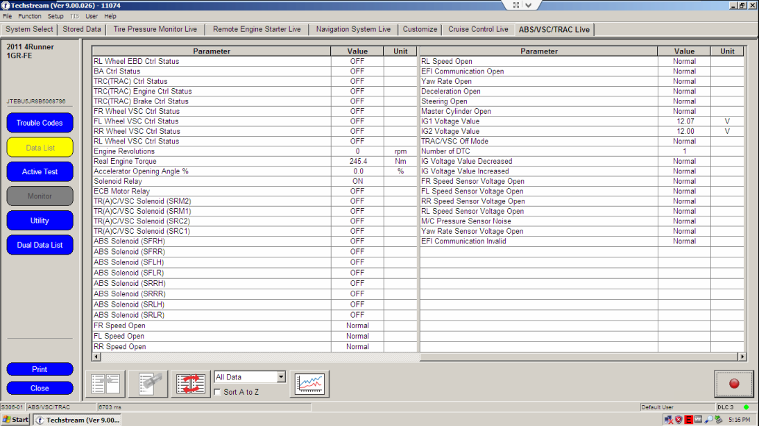

Those lights you see on the dash are your error code. The error is in the ABS/VSC/TRAC module, which unless you have a very advanced scan tool that speaks CAN and knows Toyotas, you won't have access to. It's not an OBD2 error that most scan tools can read, you'll need Techstream.
Most likely what you would see in Techstream on the real time data screen is one the Speed Sensors in an abnormal condition.
