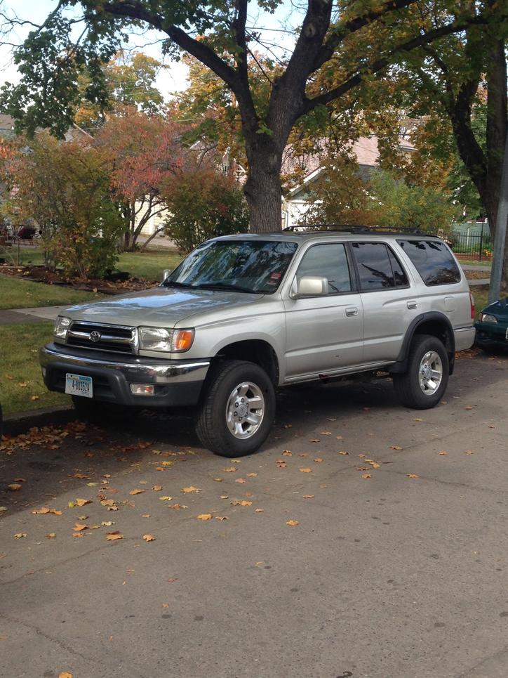

The rig in question, before any mods were done to it. It has a rebuilt title (carfax showed 2 different wrecks, a minor front end bender and a sideswipe, both with no resulting frame damage) and has about 250k miles...Still runs like a champ
