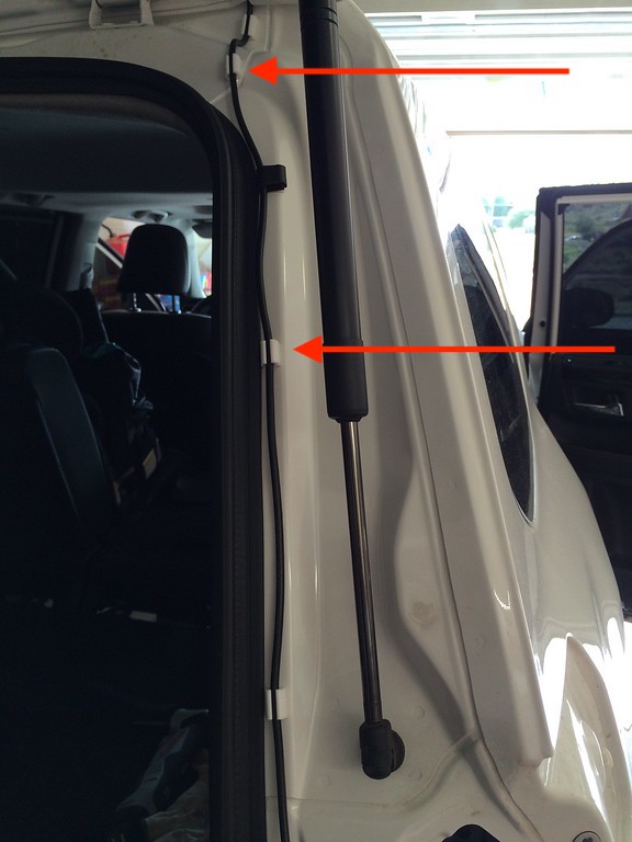

Backing up in time a little bit to update my 5th gen's progess, I installed a Midland handheld CB radio and Wilson Lil' Wil antenna. The install was pretty simple and it works pretty good as well.
Ran the coax down the rear door sill and through the tail light housing opening.
Hey gm350reratliff,
First off, NICE rig! I have a new super white myself, thanks for the inspiration.
Sorry for this blast from the past but do you happen to have a link to those white cable guides that you used?
Thanks
Colt
Hey gm350reratliff,
Thanks
Colt
Sorry for the late reply, I don’t frequent the forums much anymore.
If I remember correctly, those white cable holders are either from amazon or ikea. Yes, ikea and I’ve only had one come loose in over 4 years. I really just used what I had in the garage at the time and that’s what I had.
Thank you
