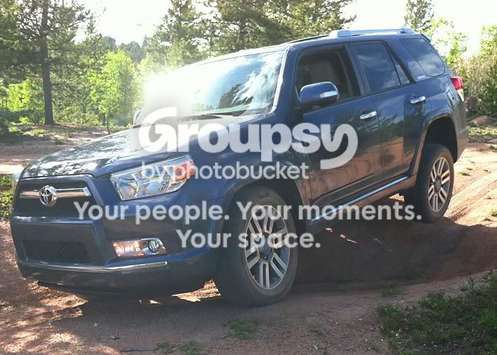

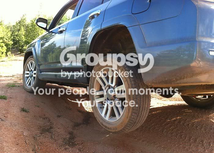

The bigger issue is ytf I'm going off-road with stock Yokos.
