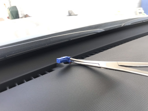

My $5 mod in 5 mins.
Looks like you bought the wrong sensor
Negative. Someone posted this picture awhile back of a 2019. Clearly a different connector with 6 pins.

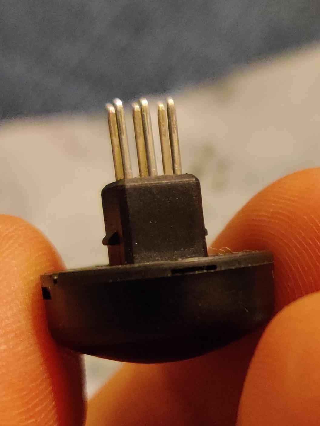

I tried this mod... It cost me my entire evening. After struggling to remove the dummy sensor, I installed the new sensor and it didn't work. In an attempt to fix it, I tried taking it out again and the head of the sensor popped out byitself :rant:
What a joke. Now I have the other half of the sensor stuck in my dash! Unlikely to ever be removed without taking out the entire dash.
Here is the broken piece that snapped off. Other half is lost and attached to the factory cable.

Well shit, I received a defective light sensor and when I tried to remote it the top popped off with ZERO pressure and the plug has now fallen back down inside the dash. I have no idea how I'm goin to get it out short of removing the window or the dash. Removing the stereo just exposes the vents...

Hey everyone so I had this same problem, but I have a solution. First, Find a sturdy paper clip and bend it like a small fish hook. Next you want to fish out the wires that connect to the back of your broken plastic. Then slowly guide the clip out in reverse (you may want to tape a mirror to your windshield to see plus a little led light). The clip gives less resistance in reverse. Continue using the paper clip until you are sure it's angled properly then use gentle force to pull it out with the paper clip hook.
Next, for those that didn't use electrical tape. The trick to remove this cheap sensor is to pull it up straight up. Pushing up at one angle will replicate my problem I and others have had on this thread (making you loose your head, literally). So use floss and wrap it around then whip it up like a noose. Good luck guys
