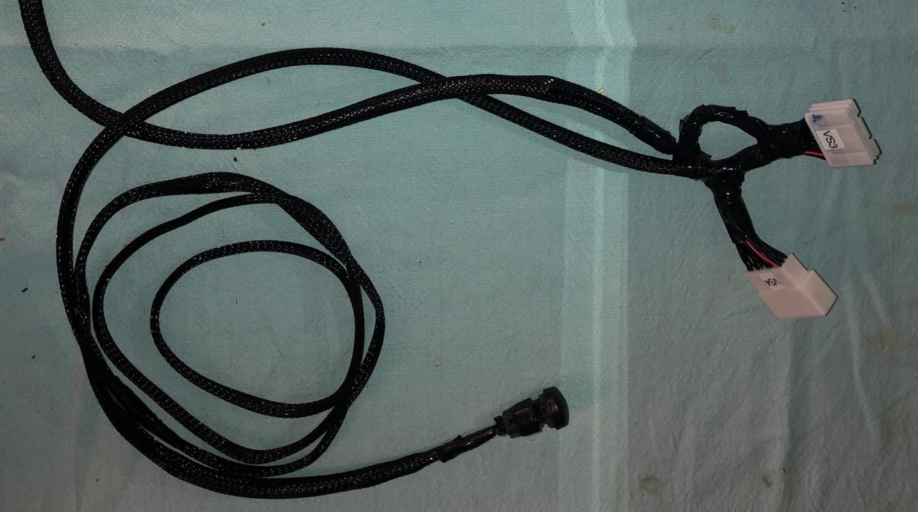

iDatalink makes two different T-Harnesses for the 5th Gen 4Runner - ADS-THR-TL5 and ADS-THR-TL7. From the marketing info, you may notice the TL5 is for the G-Key model 4Runners, and the TL7 is for the "Push To Start" models. What they don’t say however is that the TL7 is the only one which includes the F9 connectors. The TL5 has the T-Harness for the steering column and OBD2 connector and expects you to tap into the F9 connector.
Since I was doing a remote start - I bought both (Bestbuy sells them for $30 each). If you are only looking to add the pins to the F9 connector, you need the TL7 harness, regardless if you have the G-Key or PTS model, they both use the same F9 connector.
The T-Harness has a bunch of connections coming off, meant to go to a remote starter. I cleaned this up considerably, and soldered everything directly through (pin 1 to pin 1, pin 2 to pin 2, etc.), and took just pins 20, 21 and 22 to the Lexus harness above (plus 3 more to the remote starter).
Pin mapping:
Light sensor Pin 6 - Body ECU Connector F9, Pin 20
Light sensor Pin 5 - Body ECU Connector F9, Pin 21
Light sensor Pin 3 - Body ECU Connector F9, Pin 22
Attached is a picture of the finished harness. Ignore the wireless going up to the top left, they are for the remote starter. If your not doing the remote starter, you would just have the light sensor and T-Harness.

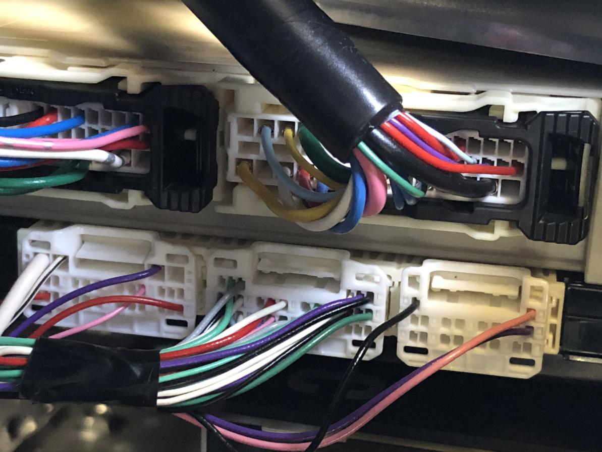

The BCM is located behind the left side of the driver kick panel (behind the inverter on / heated windshield buttons).

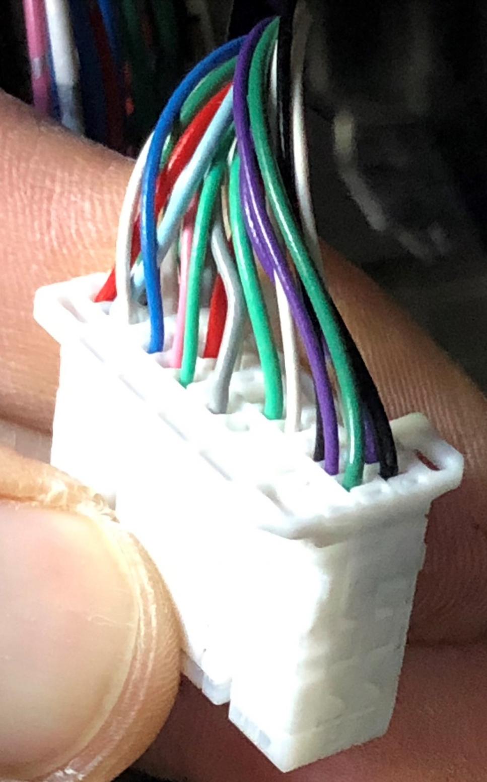

Attached is a picture of the connectors going into the BCM (the F9 connector is the middle connector of the row of three connectors). The second picture is of the F9 connector removed. The front most corner with an empty terminal is pin 19, with four more empty terminals (20, 21, 22 and 23) beside it.
If you have the sensor on the dash, but are missing the pins in the BCM, then you would need to either fill on the connections on the FG1 connector (not previously mentioned, but appears to be buried behind the dash against the firewall), or splice the wires from the sensor and patch them directly into the BCM.
I would suggest not messing with the wiring harness unless you’re comfortable with it. An incorrect connection could leave you needing a new BCM or worse.

Sorry, need to correct my previous post, pins 20-22 are the ones you need. But yes, the pins you have circled is the area of interest. Specifically the pins you have circled in that picture from the corner are 19, 20 and 21. What you cant see in that picture is pins 22 and 23 which were also empty on mine.
