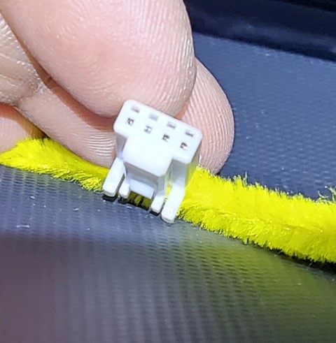

Bought the 89121-30020 sensor on eBay. I made on offer and knocked off $6 and he took it. Paid $68.99, free shipping. I have a 2020 ORP. Wire was pretty short, so I tied a shoelace to it before I released the dummy sensor. New sensor plugged right in. Tested and works great before I pushed sensor back in the hole. Love the results. Much better to see when lights are on during the day for bad weather. Thanks to all for the info. Mike

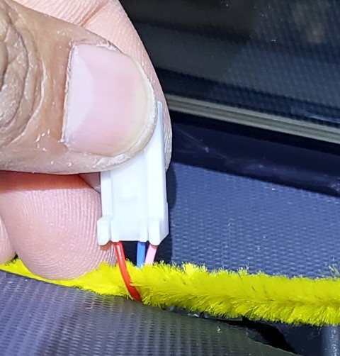

2020 TRD Off Road Premium. This mod does NOT work. The wiring harness in the 2020 is attached to a blank which easily pops out, but the connector is a 4 pin connector. The sensor that I received has 6 pins.
After popping out the blank, already visually different from photos posted in this thread.
Sensor, part # 89121-50020
The wiring connector to the dash
Oh well not much wasted on a $5 part. Everything snapped back in quicker than it came out.

2020 SR5 Premium here.
I popped the plug and found the wire below. The connector was the flat 4 prong version. I ordered the Lexus part # 89121-30020 from a seller on Ebay that took it out of a car. The price was $85 w/ tax & shipping.
I installed it on Monday and it fit correctly and snapped into place. Highly recommend this mod since the Carplay screen is too bright at night when the interior lights are set to max.
After adjusting the interior light setting to just under Max setting, the sensor works dimming the radio during the day and increasing brightness at night.

Attached is a picture of the connectors going into the BCM (the F9 connector is the middle connector of the row of three connectors). The second picture is of the F9 connector removed. The front most corner with an empty terminal is pin 19, with four more empty terminals (20, 21, 22 and 23) beside it.
If you have the sensor on the dash, but are missing the pins in the BCM, then you would need to either fill on the connections on the FG1 connector (not previously mentioned, but appears to be buried behind the dash against the firewall), or splice the wires from the sensor and patch them directly into the BCM.
This is exactly the situation in my 2018 SR5. F9 connector is missing wires in positions 20-22. I'll have to get my eyes on the FG1 connector to see how I want to handle this.
A simple solution for adding the terminals is to fold over the end of a new solid wire (opposed to stranded). The folded end supposedly locks into the connector cavity similar to a terminal. I wouldn’t consider this a permanent solution, but perhaps is sufficient to prove that you bcm will react to the sensor as expected.

I've already ordered the iDatalink t-harness from Best Buy. Thanks for the tip on that! And it seems that I already have the wires to the light sensor itself, but I haven't looked for the FG1 connector yet. My guess is that it's a dead end. I'll probably just end up tapping into the light sensor's wire harness (between the sensor and FG1) and running a jumper over to the new T-harness.
I looked for quite a while trying to find the terminal part numbers with no success - I don't think anyone has figured them out. If your able to find the correct, I would be quite interested.
Well, this is odd. The F9 connector lacks the tiny 5-digit number that (up until now I thought) every Toyota connector has on it. I checked mine this past weekend. So no joy on the terminals :ohwell:
