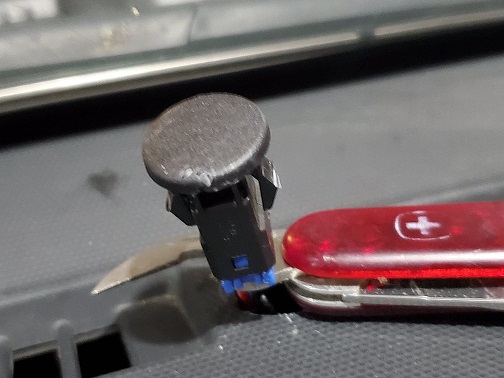

My $5 mod in 5 mins.
Finally installed this, a year later. Found a Swiss Army Knife Can Opener worked better than a credit card.

Did this in my 19 ORP and it took about 2 minutes with one of those plastic panel removal tools. Didn’t scrape any of the plastic and popped the new one in. Works well. Thanks for the post OP!

A “sub thread” seems pretty useless? Just ask the question in here. Multiple people responded with how easy it was to remove the blank with several different tools. OP uses a plastic trim tool, dollars to donuts that’s what Toyota would use if they had to swap this out. I don’t see why doing this super simple modification needs a procedure from Toyota?
I’m sure you could take your 4Runner to the dealership and have them do it for you for a few hundred dollars if you’re that concerned about somehow messing your dash up?
I used a small plastic trim tool on mine. I placed a microfiber rag under the tool so as not to scratch the dash. After a few tries, it popped right out. Don't overthink this one.
facepalm
Taking out the dummy plug is very easy.
Now, if you need to remove the actual light sensor after installation, *that* will be a royal PIA.
The locking tabs are different and need to be depressed from under the dash to push out the sensor. Be sure to test your sensor before snapping it into place.
