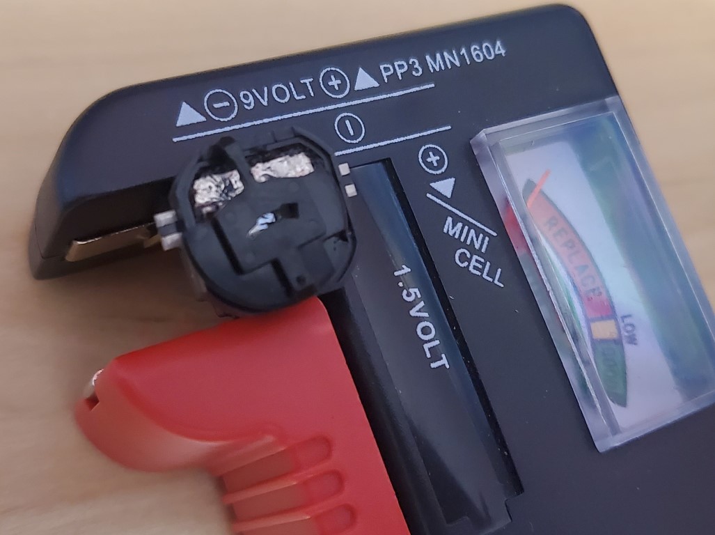

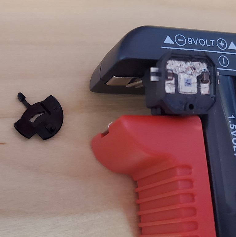

My $5 mod in 5 mins.
This is what used
Old card with 15mm hole drilled and cut open, Worked like a charm.

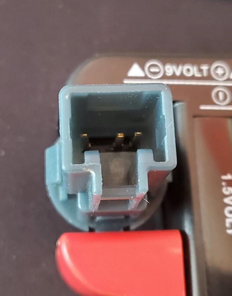

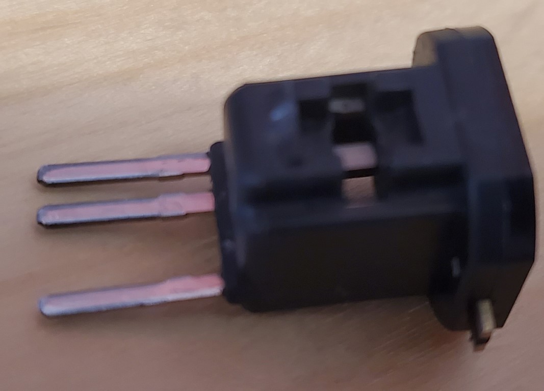

For my 2020 ORP

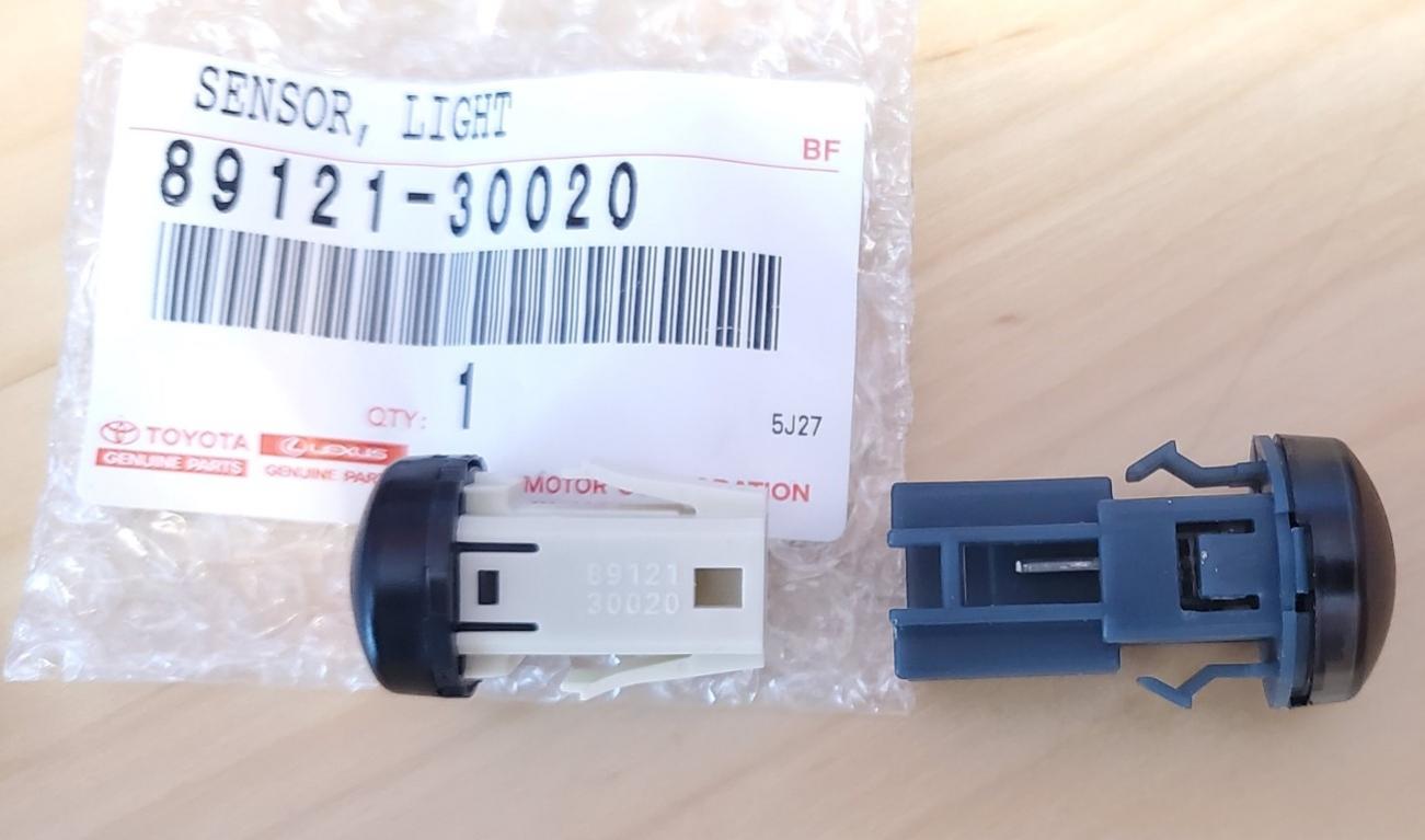

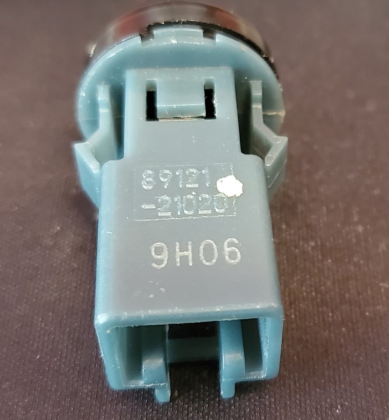

I wanted to try a cheaper option, so bought 98121-21020 hoping it would fit, or I can Jerry rig it to make it work.
2020 ORP part has 3 pins straight, and does the 98121-21020

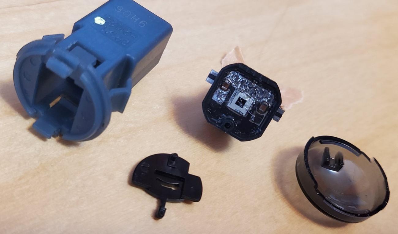

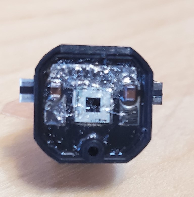

When, it arrived, it is too big. Opened it to see if I could somehow connect it, I think its possible cause sensor is sensor, nothing more. I did not want to have a unfinished sensor right in front of me. Here is what it looks like inside if someone is interested.
I bought one form earlier link Colt posted. Last pic is the part that I just got vs the big 98121-21020
