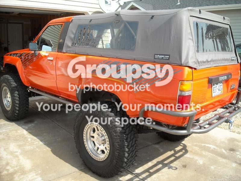

My '87 Daily driver
I love my bj spacers. I have my t-bars relaxed and I am able to run 33x10.50 bfg km2s. It rides great and handles really well. Very easy to install. I have a set of ome n98 shocks on order for the front which should make it ride a little better.
I run the same bj spacer and addaleafs with my 4"pro comp kit it is awesome. It gives me the little extra hight and with the tbars relaxed I get great ride quality on road and off

You mentioned in an earlier post that you were going to paint it next year. Are you going for the same color?
It seems that nearly every T4R around here is either white, silver, or gray. I want something a little different.
Maybe this color?
