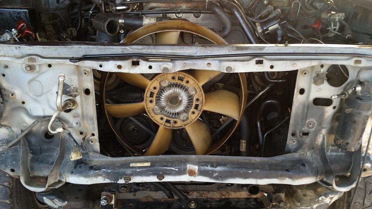

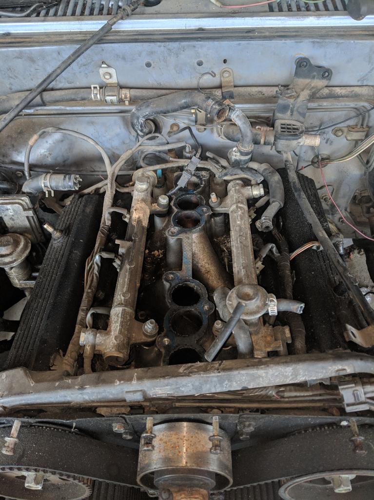

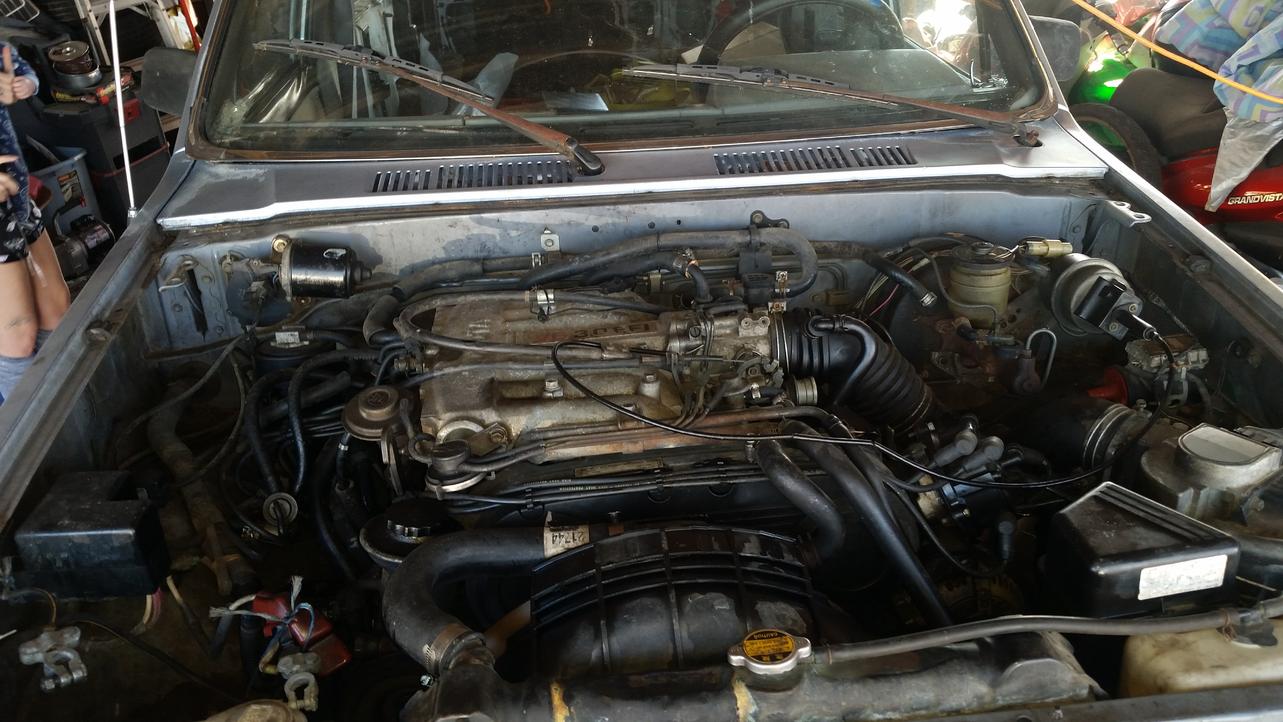

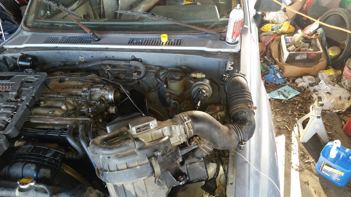

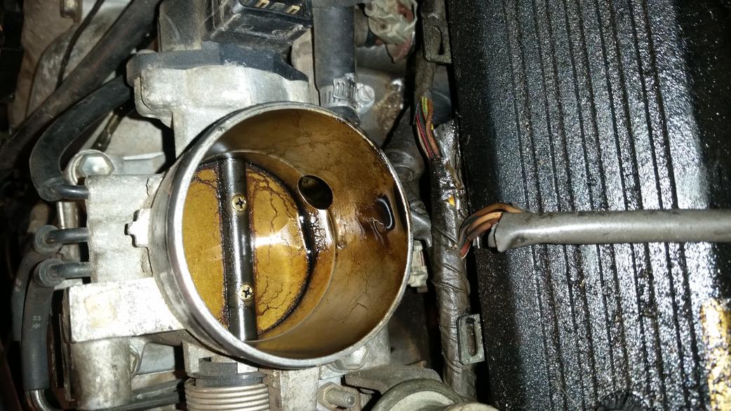

So I took the intake off, to find it was full of oil. Got the radiator out. Now working on getting all the vaccine hoses, and eletctric all cords disconnected.
I had wondered why it spat so much white smoke LOL

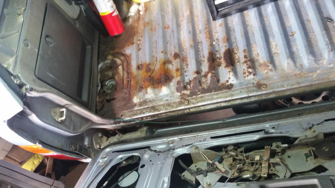

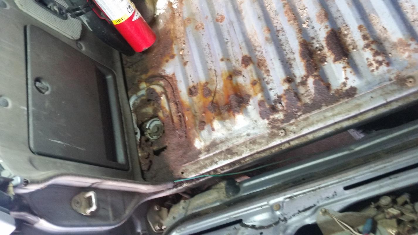

As for progress today, I'm taking my wife and kids to ohio today, won't be back until wednesday/thursday. But in the mean time. Here's a picture of "ye olde rusty hole" in the cargo bay. Seeing as how it's so close to where the leafs mount. Anyone have any ideas on the best way to chop it up and put a new price of metal in there?
I honestly want to cut the entire bed out and replace it with a sheet of stainless.

I don't have any pics of mine, but that's a tough spot. If you plan on keeping this for a long time, I adopt the attitude of "doing it right the first time". A sheet of stainless would not only be sweet, but you'd avoid that issues again. It would be a pretty huge project to do with the experience I do have. I always check the body mounts and what they're connected to to gauge how big a rust issue actually is. Cosmetic is normally just cut out and weld back in. But I'd caution that because the gas tank is so close. Unless removed I never feel comfy doing that. But ultimately, if it rusted there once, It has the potential to again.
Edit* the gas tank is close ish, not super close obviously. Just something to think about.
Yeah I definitely want to do it right the first time:dancin:. And the deeper I dive. I'm starting to realize it may take me until next summER to have it actually drivable ke the way I want it:faint:. Which SUCKS! But I want everything to be as good as it can be.

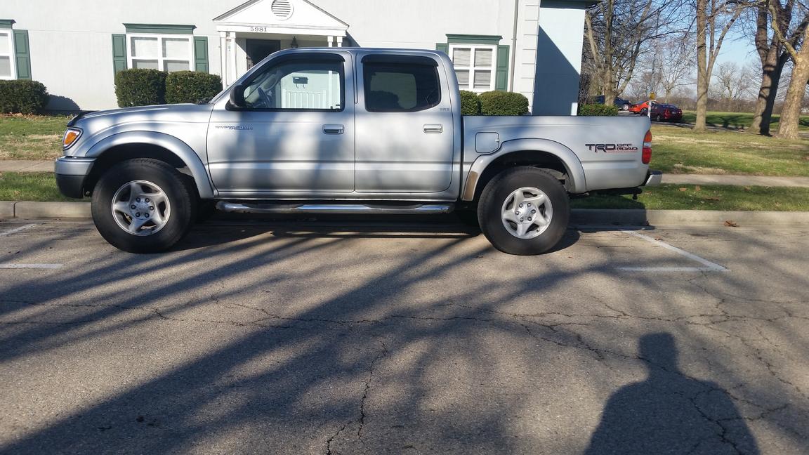

Enough of this morning rant, lol. Here's my tacoma since I'm not at home right now.

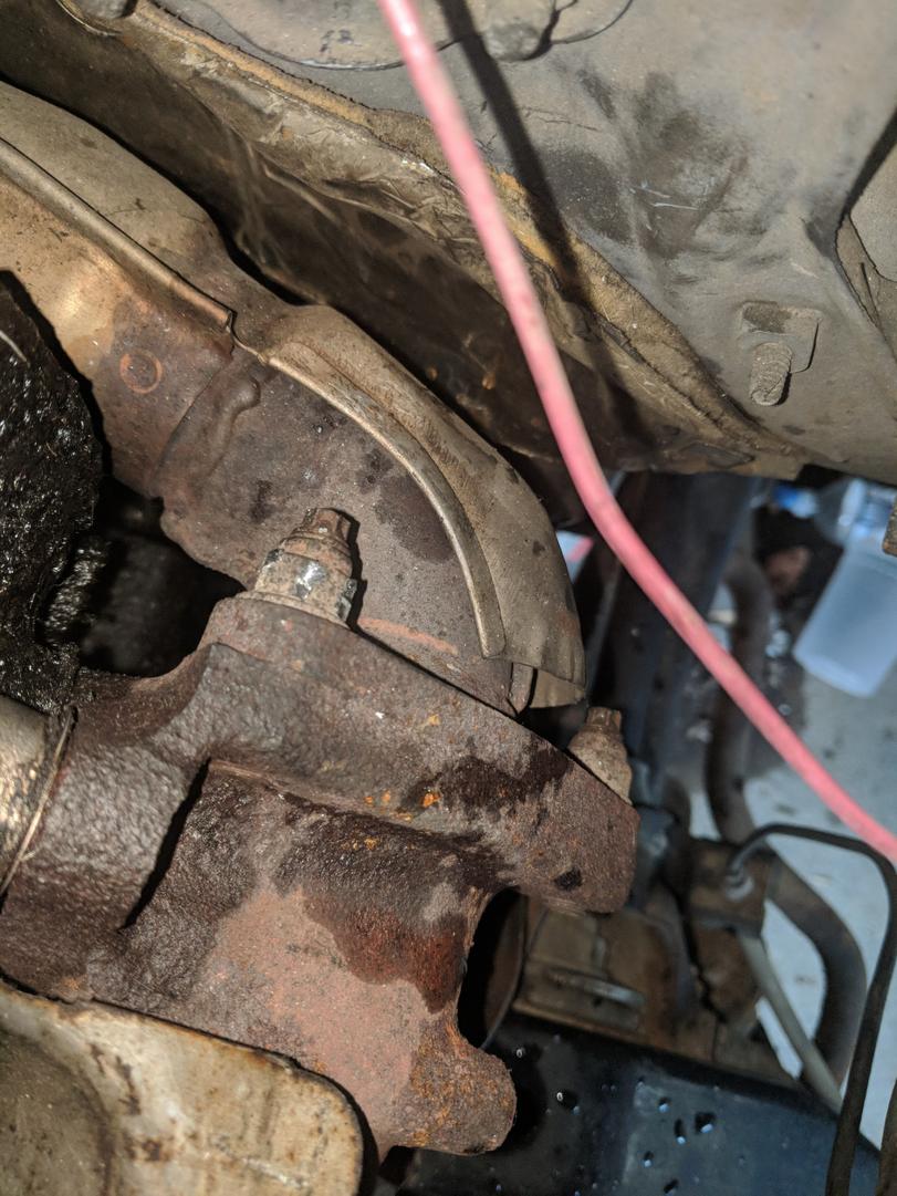

So I've got the exhaust off, and the rest of the intake.
About to remove the wire harness from the engine.here are a few pictures,

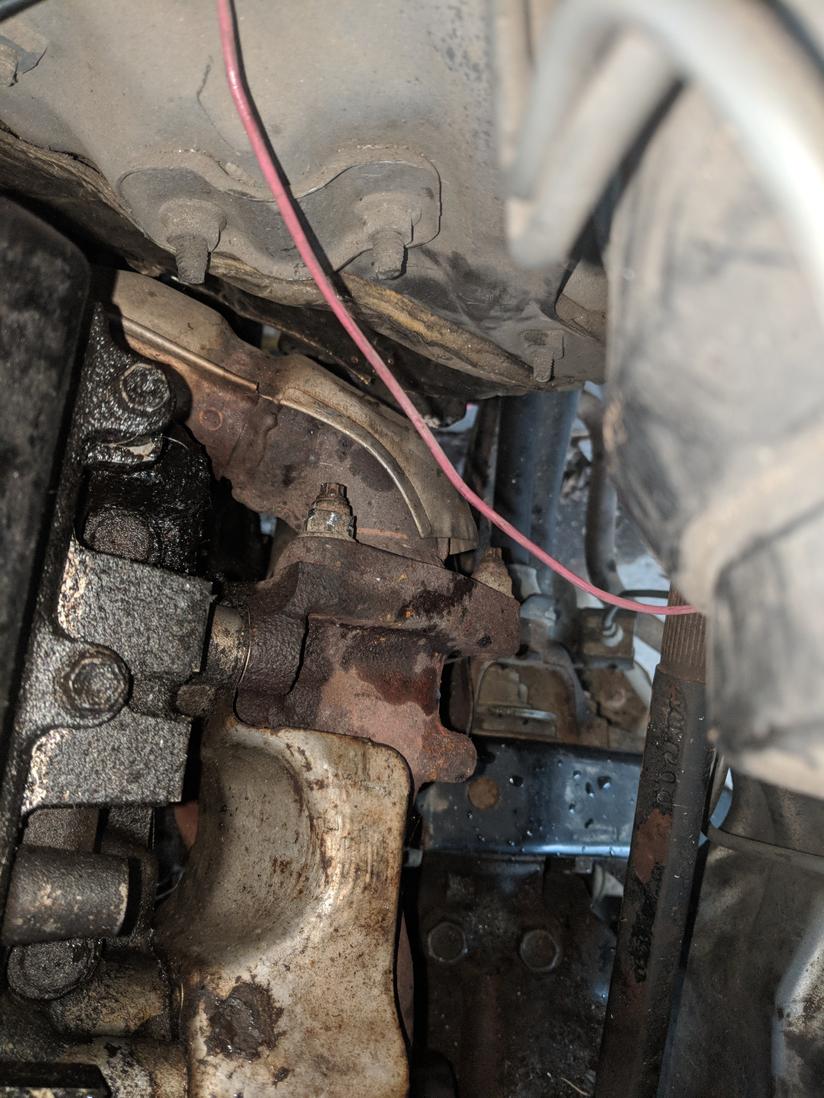

About the exhaust, the pictures shown are of the crossover pipe, these aren't actually what is supposed to be removed for an easy engine pull.
Just a bit further down the pipe, take the flange apart from the exhaust pipe after the merge.
You'll need a 2ft extension, universal socket, and a lot of penetrating oil.
