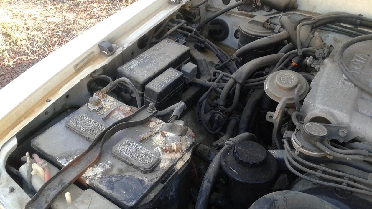

So for questions I have, I need to know if I should just go and tap the brakes with a hammer or what for unsticking them? Because they probably aren't stuck BADLY but I can't move it with it stuck as it is. I also need to know what the best way to go around getting the AC working eventually (Not REALLY important but necessary, I live in a desert). For the battery terminals, they are really quite bad (Seriously the only way to describe their condition is with pictures) But I believe it is mainly visual (Dug some of the stuff out from around them, they are intact), So how would I clean them?

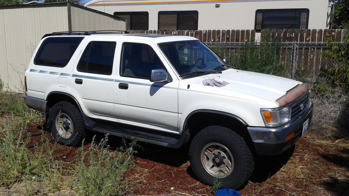

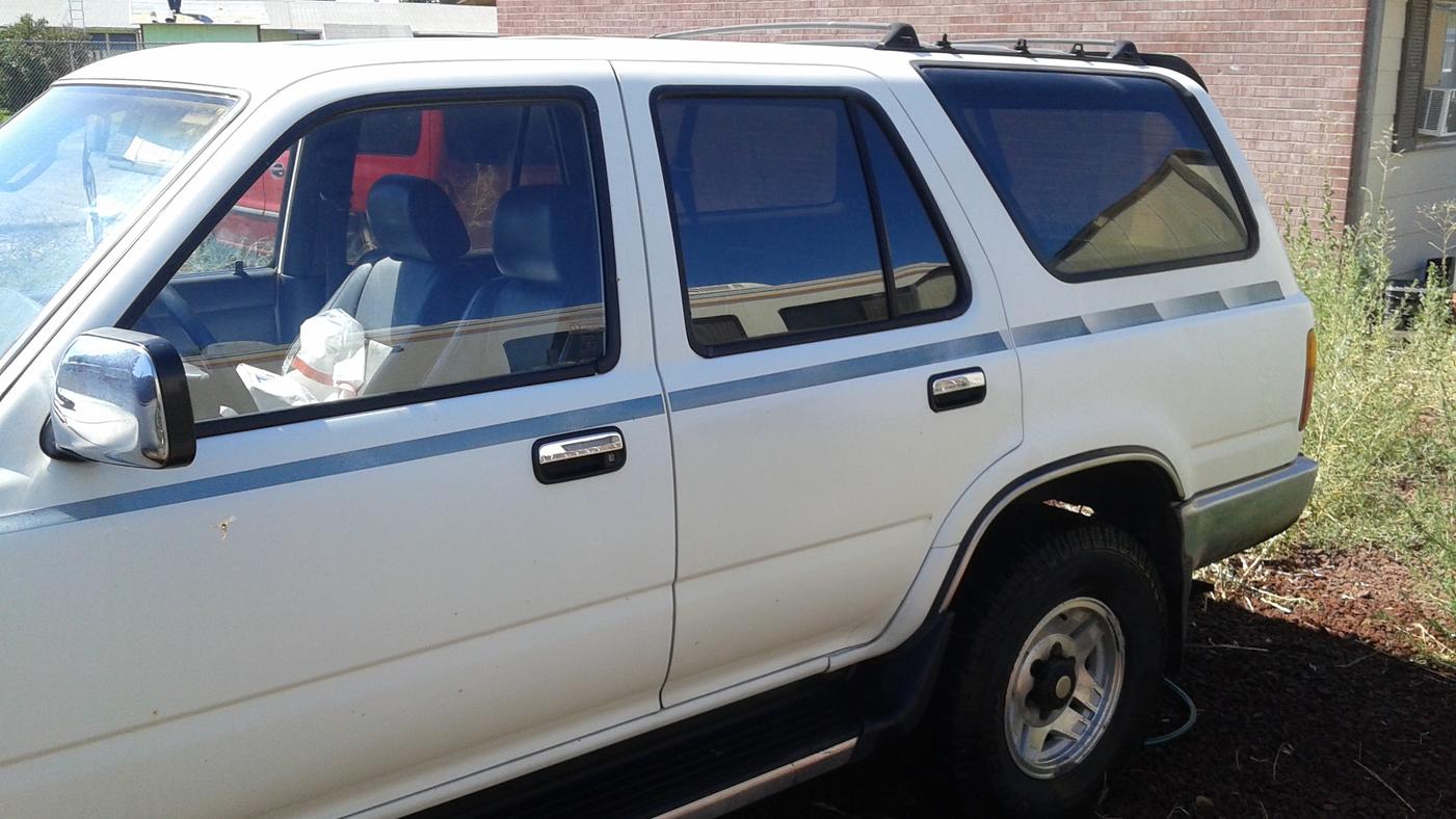

Pictures! (Engine and suspension will follow within a day, god forbid we get GOOD weather.) Just finished cleaning up the exterior roughly. Don't really need super clean at the moment just not having it be an off grey color is good for me!

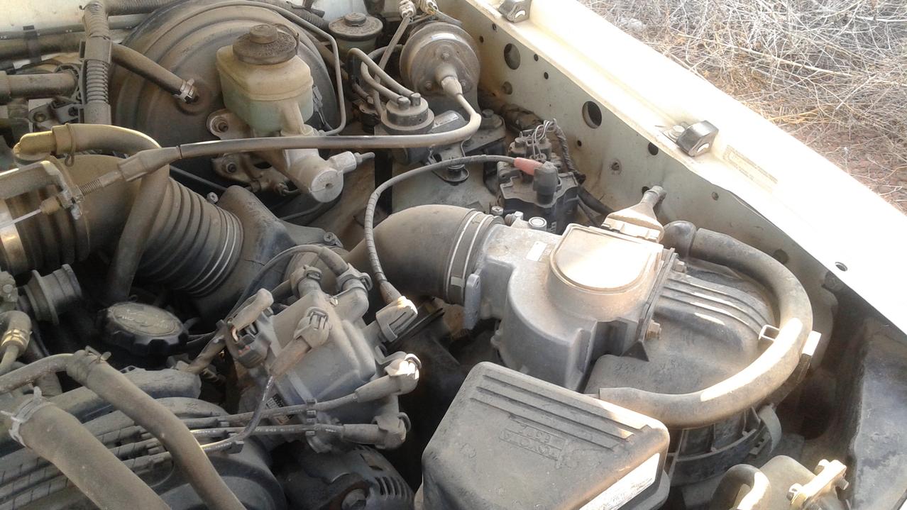

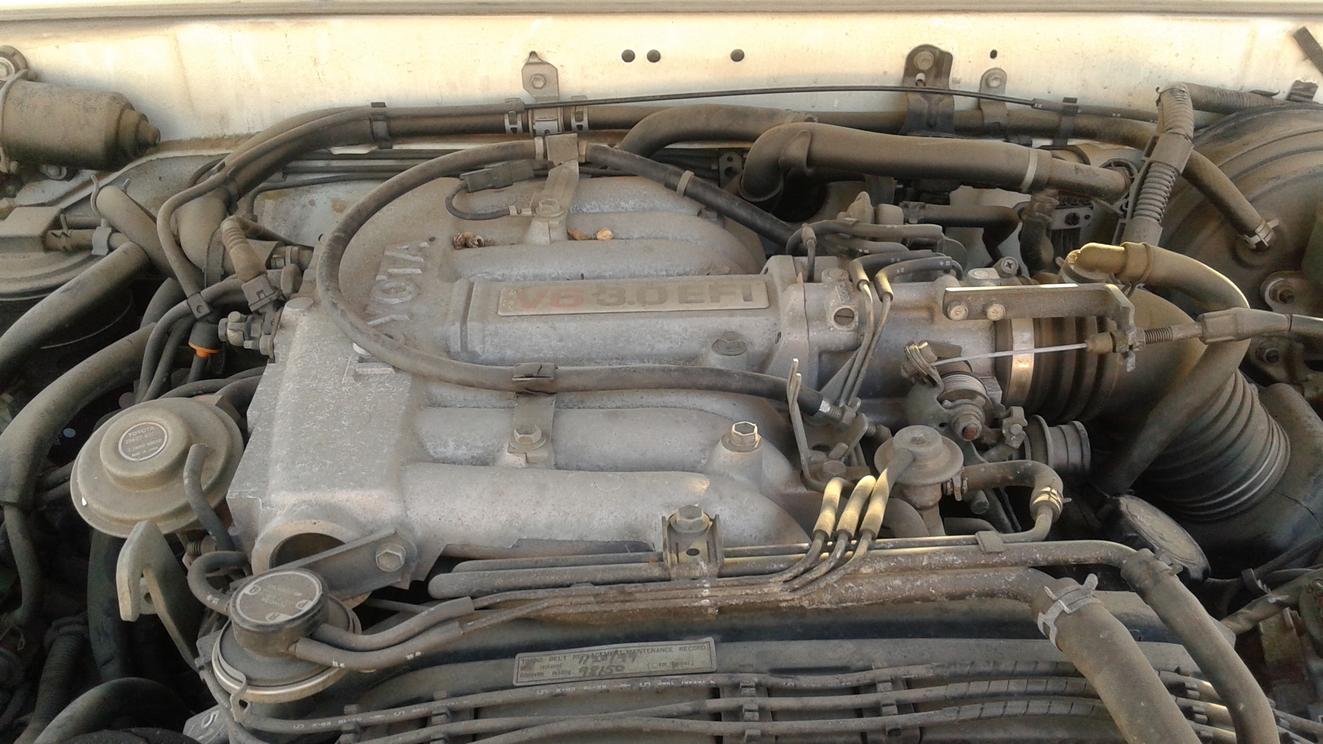

Alright so I finally remembered to get engine pics! (The suspension is cloaked in shadow and my flash is weak) But yeah, take a look at my mess

So, the 4Runner (Open to suggestions on names for her) is no longer in the gravel patch, and that extra corroded battery is gone. I found a shop that my buddy's El Camino can pull me to (Literally around the corner. My GMa's neighbors are great people :) ) I am stuck on how to get the pin out of the power steering pump though. We removed the bolts that had it bracketed onto the engine, but there is this pesky pin behind the pulley that won't let go, because the pulley is in the way! I can't take the pulley off (Just spent an hour and a half down that hole) And we can't just rotate it down and out of the way! Help would be appreciated here.

for your power steering pump removal: Hose that thing down in some PB Plaster, then hose it down again. Throw some heat on with a torch, then get a strap wrench on that pulley like this: https://www.amazon.com/OTC-4475-Stinger-Grooved-Pulley/dp/B005J3KZPS and a big wrench and give it hell!!
If that doesn't work, might have to get a grinder on it and sacrifice the pump input shaft.
Not as familiar with the V6 3.0's, but on the 22RE you can get the entire pump bracket removed from the head by pulling 4 bolts that hold the bracket on. Might be an option for you as well-
