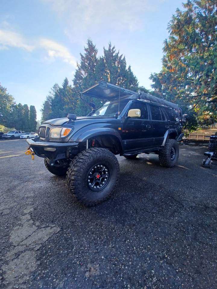

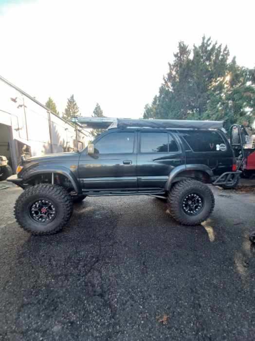

Introducing my 1st 3rd gen. Not new to Toyota, but built a whole lot of Hilux/Runners/Landcruiser in my life from geared, locked, SAS, duals, etc.
Originally From Oahu, HI and moved to WA. New beginning to make new memories. Now on to this T4R, bought this truck last Thursday and been tinkering with it since.

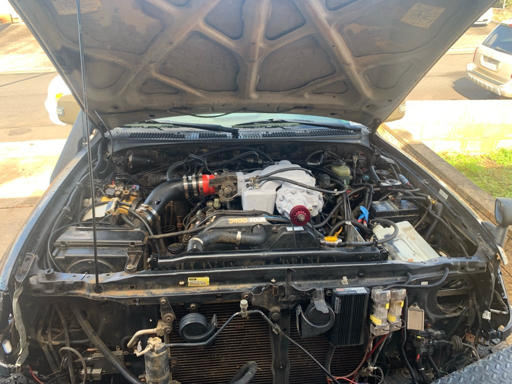

ENGINE
3.4 V6 stock
TRD 1ST GEN BLOWER
URD ALUMINUM CRANKSHAFT PULLEY/2.2 PULLEY
URD billet crankshaft pulley
295cc (6pcs) injectors
Deckplate mod
TRD HEADERS (MODIFIED)
Big 6 Wire Mod 1/0 AWG OFC
GENUINE TOYOTA Alternator
COLOMBIA OVERLAND dual battery tray
2 ODYSSEY ODY35-PC1400T
IBS Intelligent Dual Battery System
IBS Relay Booster Module
INJEN IS300 modified cold air intake
OEM TEQ oil cap
REDARC1225D
SUNFLARE 105W Solar Panel
OVERLAND SOLAR 130W Solar Panel
TJM HD compressor

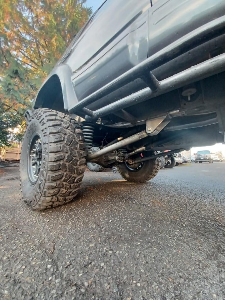

SUSPENSION
F/R FAB WORK WAS DONE BY OUTLAW OVERLAND IN WA
F SAS 3”TG LEAFS TG LH DROP HOUSING
YOTAMASTERS 8” LONG SPLINE KIT
DRIVELINES NW driveshaft
NITRO 5.29 GEARS
ARB AIR LOCKER
MARLIN CRAWLER 6 STUD HIGH STEER/25MM STEERING PIN
TG 6 SHOOTER KNUCKLES
BOBBY LONGS AXLES
FRONTRANGE OFFROAD big brake mounting kit 231mm
FOX RESI SHOCKS 12”
R SLEE OFF ROAD 6” FRONT FZJ80 COILS
(FACTORY 4LINK DELETE) 3LINK W/1.25HEIMS
STOCK DRIVESHAFT
NITRO 5.29 GEARS
STOCK E-LOCKER
FOX RESI SOCKS 10”
R ROCKJOCK Antirock Sway Bar
R Adjustable panhard bar .875 HEIMS (MADE BY OUTLAW OVERLAND)
R panhard extensions (MADE BY OUTLAW OVERLAND)

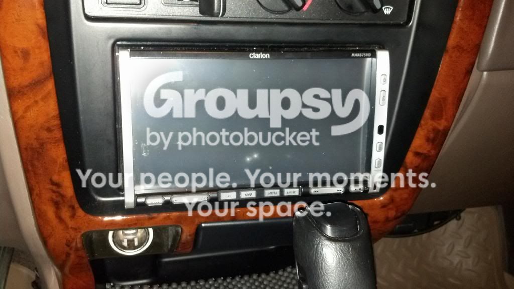

Clarion MAX675 DVD/CD headunit

As Mike Tyson exclaims in The Hangover, "Nice!" Quite clean.
Welcome. Here, we help you quickly spend your birthday money.
Wow. Clean looking truck. I'm jealous. Welcome aboard.
Thanks! The only reason I'm keeping it clean is to stay IFS. Comfort and less hard lines will keep it a beauty. If I start cutting/grinding/welding, I'm going to bust it like my past rigs.

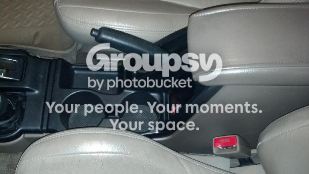

While my 4 yr old took his nap, I installed the 99 R rear larger storage compartment. Took me 45 min from start to finish. My original oak panels were all scratched up from the PO dog. These tan panels have no scratches at all from top to bottom. The rear looks brand new. I was looking at the colors when I finished the install, Toyota should of made it tan from front to back. I also had to cut the rear sheet metal to make it the lenth of the bigger opening. For the life of me, i miss placed the tan cig thingy. Had to put the oak untill I get another tan one.

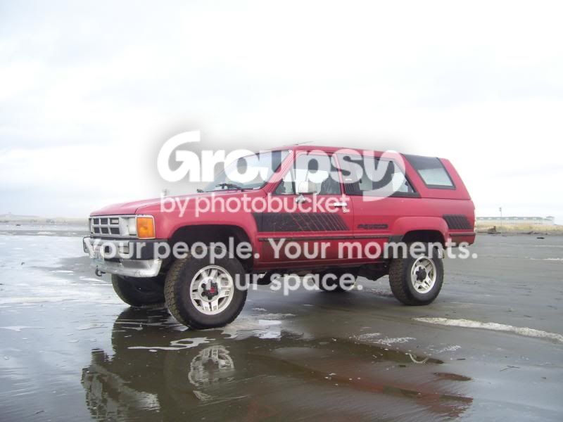

Last is my 1st truck when moving here is a 86 Toyota 4runner.

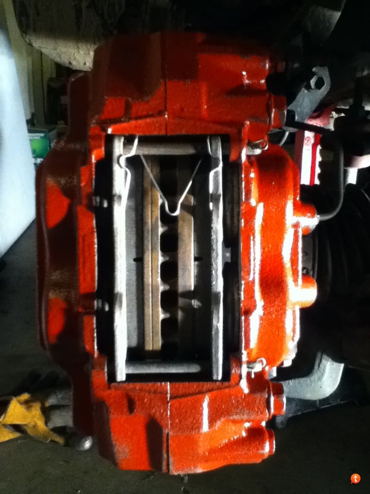

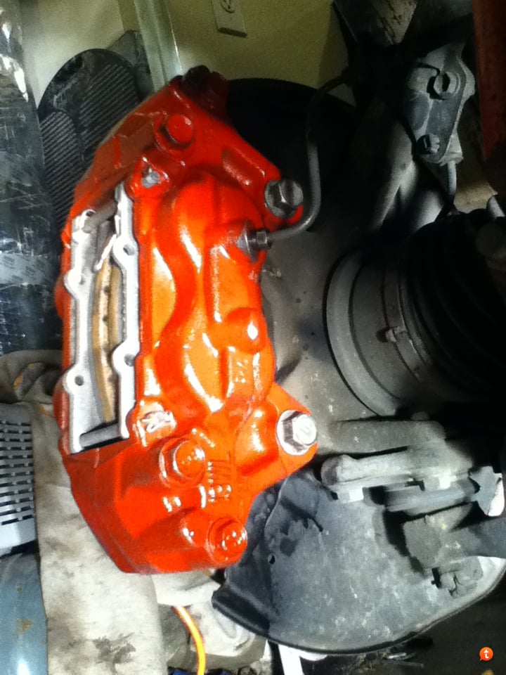

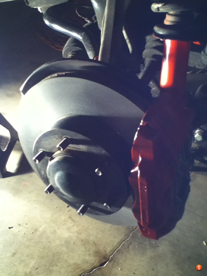

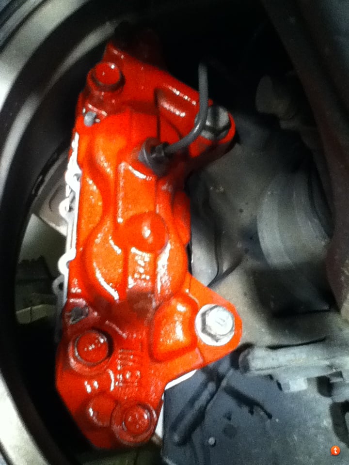

Well, I just got done finishing the Tundra 13WL on my 98 T4R. Found a 06 Tundra 2 hrs away from me with 30 original miles. Guy wanted $120 for calipers and rotors. Packed my 4yr old and went for a drive. Just bought the pads new and resurfaced the rotors. Tech guy told me the rotors were new and I just smiled. Bought some paint, but the damn thing sucks. That took the longest time. Well here it is and enjoy.
