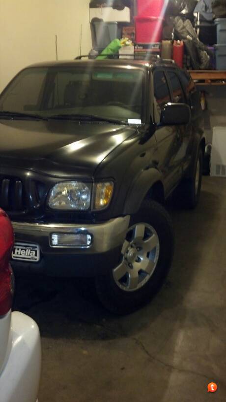

My 98 Limited

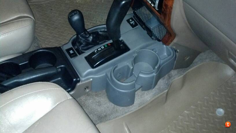

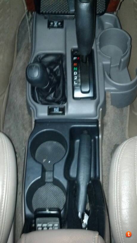

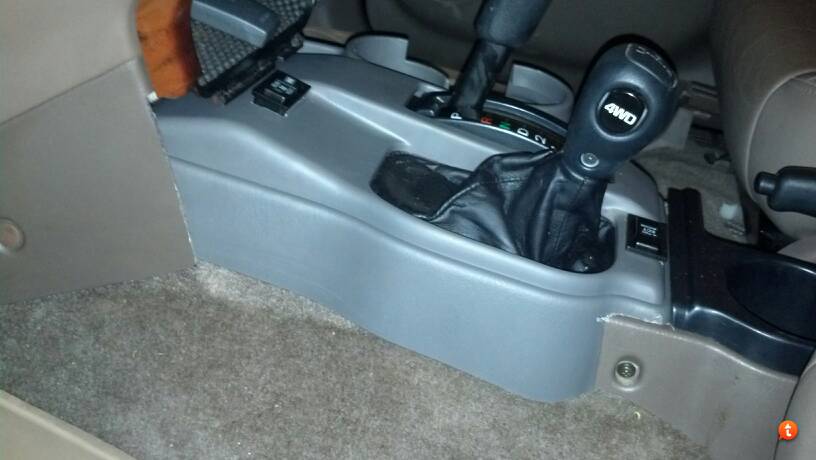

So I drop off my son to school and went to the Junkyard. I got something from a 01 taco. I didn't want to modify Alot to make it work, so most work was done to the shifter console and 2 side skirts to make it presentable. The 2 bolts that connected to the rear console matches, but had to be smoothed out for the back console to be fitted over. Also the back console has a L lip on both sides, so I made a slide with my cutting wheel. I also had to cut both front and rear of the shifter console to clear the wires and abs box in the front. Finished it off with cutting the 2 side skirts to fit. The color of the shifter console is GREY,but for $5 & it works. Took me 2 total he's for the install. Now I'm on the lookout for a tan/oak console and make it happen. Enjoy the pictures.

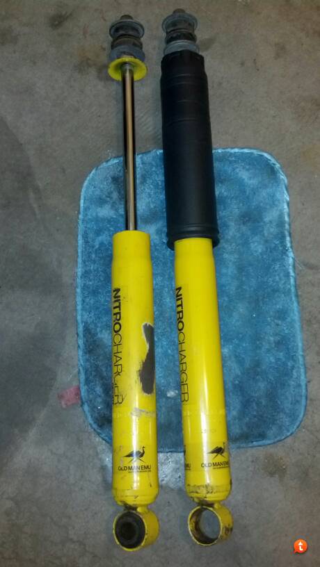

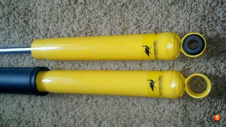

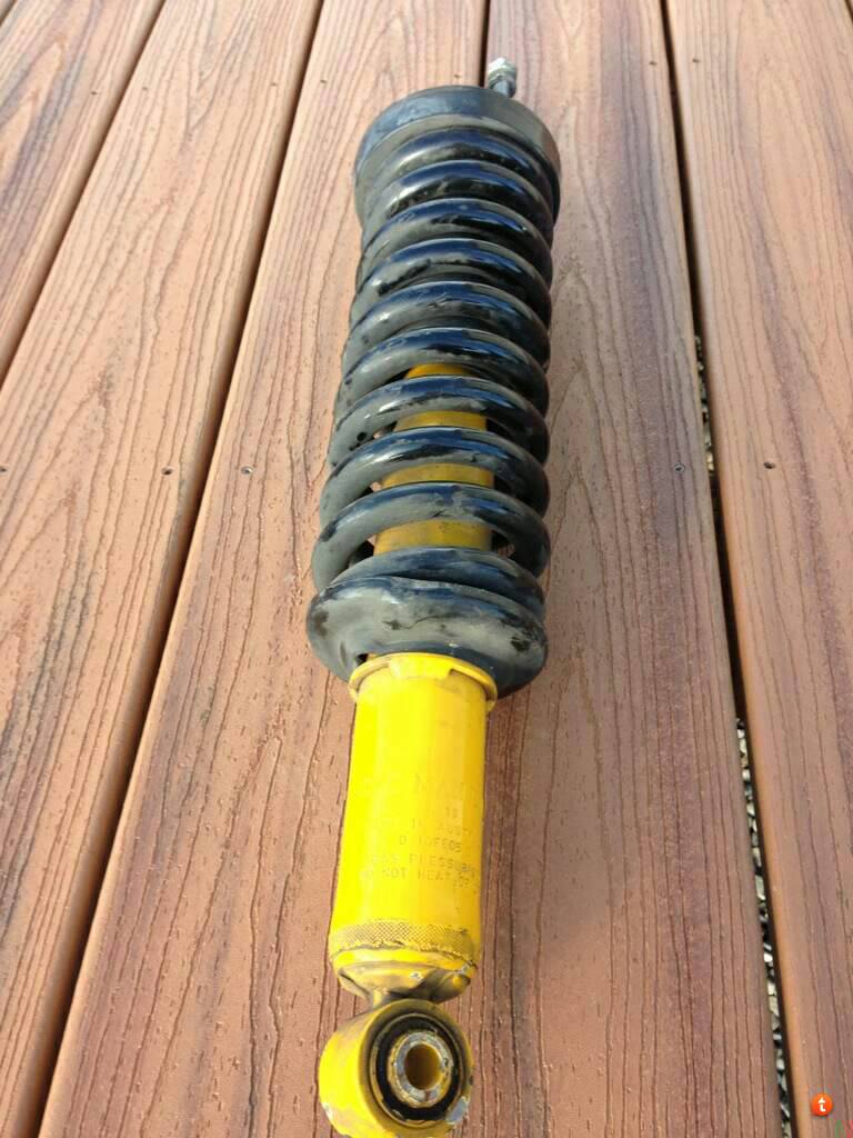

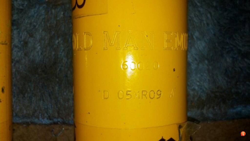

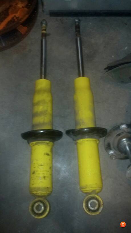

Scored free OME N91S/ OME coil? Well I got this set free from my friend as he has a 06 TRD Tundra. He's got the coilovers in his and had this set layin around. He got this lift at ARB & used it for 2 months and popped a CV, then decided to take it off.

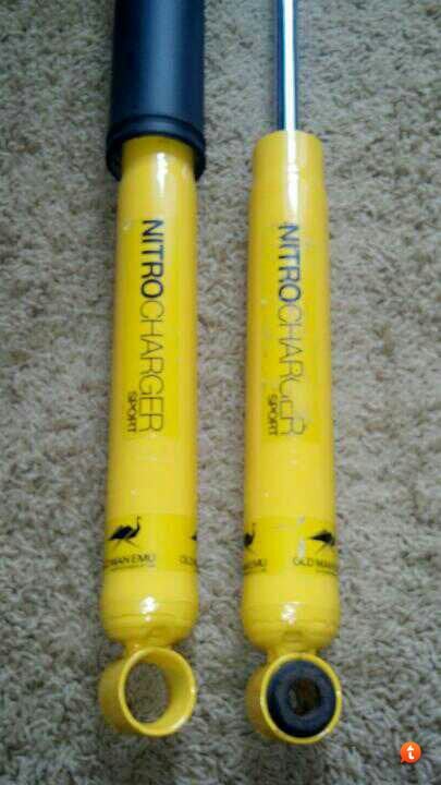

I took the Tophat off and the shocks were dead. So I have to buy new shocks. I'm going to buy Bilstein 5100 Tundra front shocks.

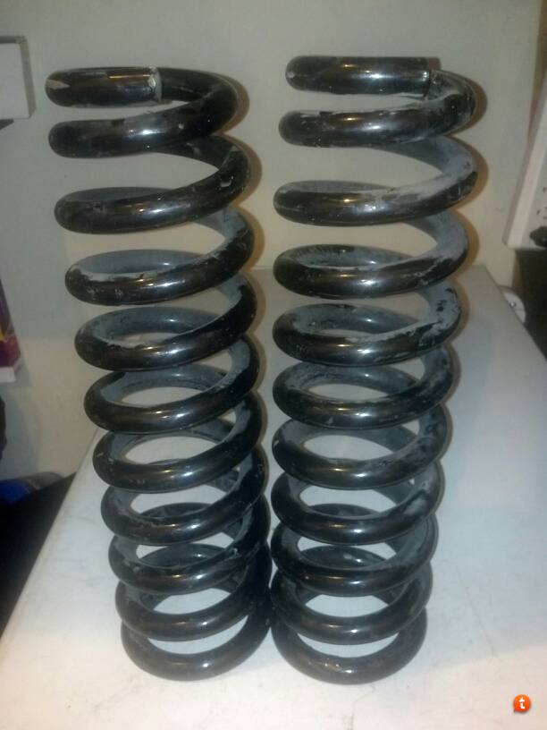

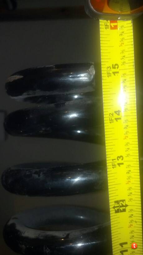

I measured the shocks and It measured 15 1/4. Because I don't know what coil this is, the only measurement that comes close is the 882 witch measures 15.55". Don't know what the 883 measures. The coils I counted was 10.75 wraps
OME 2880 500 .630 14.37 4Run/Tacoma
OME 2881 500 .630 14.76 4Run/Tacoma
OME 2882 500 .630 15.55 4Run/Tacoma
OME 2883 Prado
Above is some info from OME
Here are the springs assembled
Just springs
Dead shocks N91S

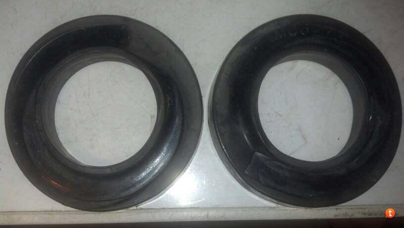

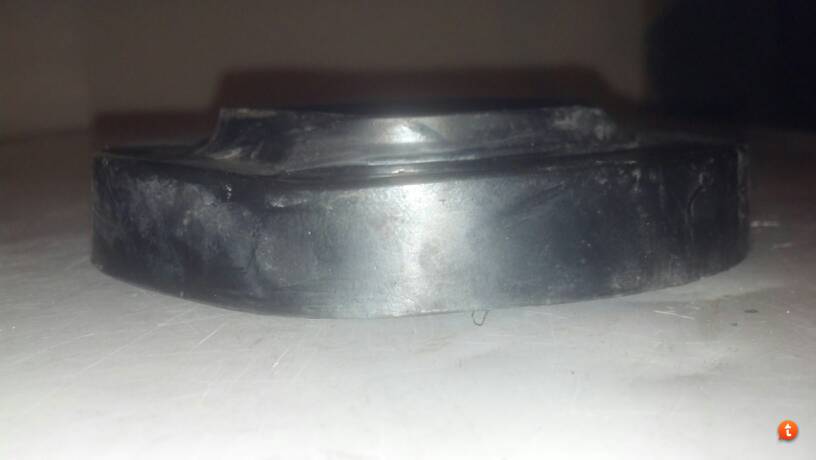

These were in the middle of the Tophat and spring
This is the free height of the spring, 15.25"

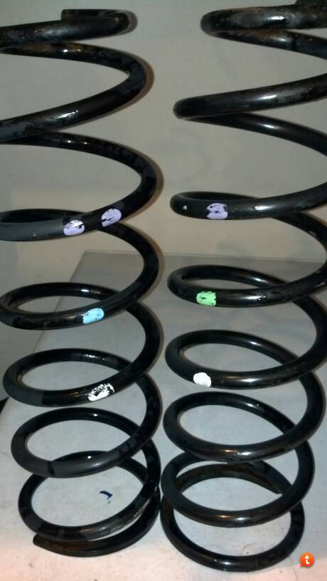

Picked up some LX450 front springs for my 4runner today.
19.5" Purple Green White 8 wraps
19.25" Double Purple Dark Blue White 8 wraps

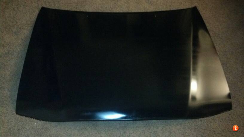

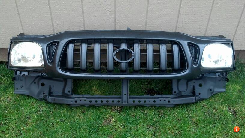

So I've been out of service and trying to do small things and this is what I've been tinkering with. Put my lift on hold because I'm doing this first. All parts are Genuine Toyota except the grille. I hate trying to make it fit, (OCD) some parts of the grille doesn't fit smoothly. I might end up getting a Genuine grille as well. It's not on the truck yet, (doctors orders) but it's will. I painted the hood with spray can cuz I wanted to see just because. Kinds good because, by the time I recover the pieces will be done from the paint shop
So I did the Tacoma Conversion 2 nights ago and did have to modify some small things to make it work. Everything else bolted up.
The hardest parts was 2 things:
1st was taking off the core support. Not only do you have to take the spot welds, but you also have to pry apart the glue that bonds the metal together.
2nd was adapting the 4runner Limited flares to the Tacoma fenders. The Tacoma fenders have a higher arch than the 4runner. I used the 4runner wheel well plastics.
The things that had to be modified:
Under the front L wheel well is a canister that has 2 bolts holding it to the wheel well and the core support. The bolt that is bolted to the core support is longer than the hold that is already there. So I just drilled and put a nut and bolt to HD in place.
Another thing that had to just relocate was the L horn. The 4runner core support comes with a nut welded to the support. The Tacoma doesn't. There is a hole by where the 4runner support is, so I just put a nut on the other side and tighten it. I also used the 04 Tacoma horns. The 4runner horns were wimpy and the Tacoma ones have the actual horn looking horns. They also have a better sound.
I always like the look of the Tacoma front and I am glad I got the chance to do it.
There is one last thing I'm fussing with, the brackets that hold the tail of the bumper and the side front of the fenders.
The Tacoma brackets hold the fenders perfectly but are to short to hold the bumper.
The 4runner brackets are perfect for the bumper,but the hole for the Tacoma fenders is lower.
So my final decision is going with the 4runner brackets, but I will have to drill a hole in it to hold the side front of the fenders.
