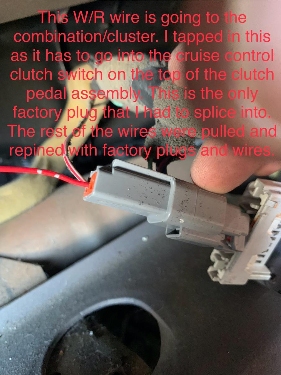

More pictures of the wiring that had to be done
