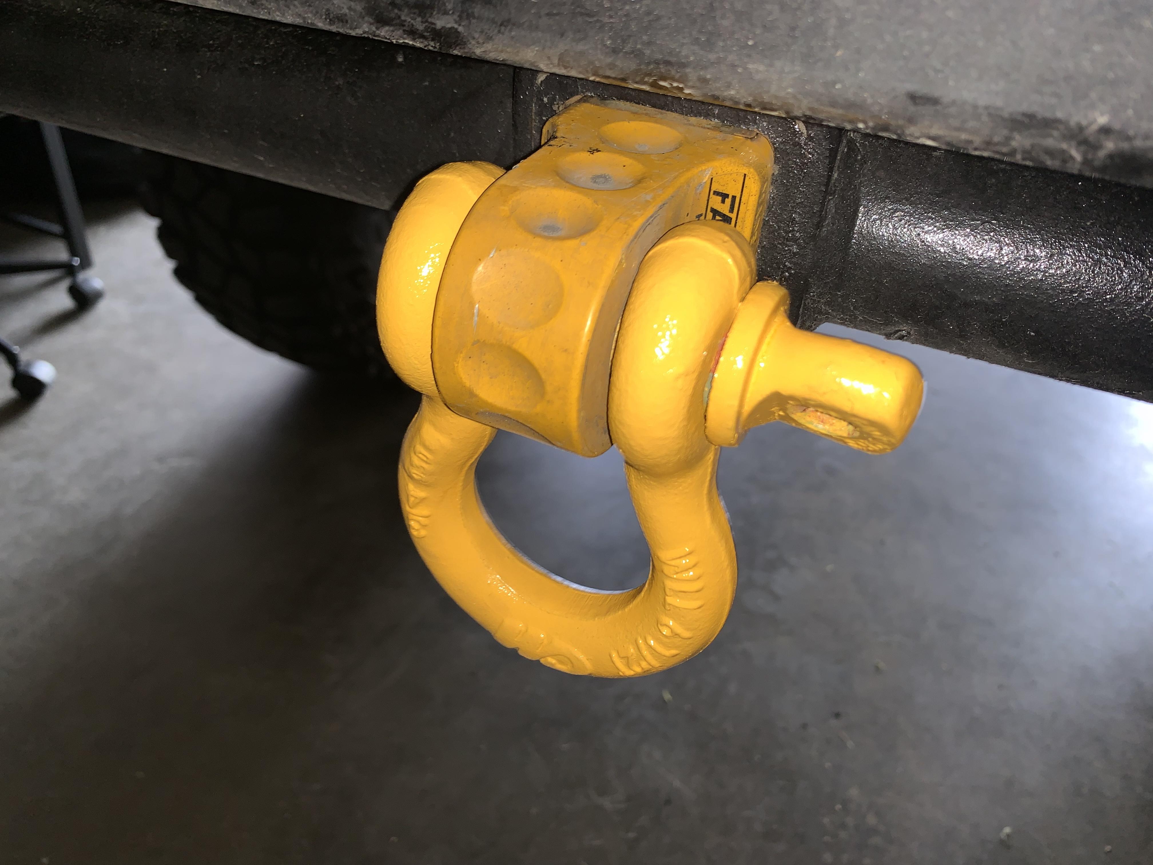

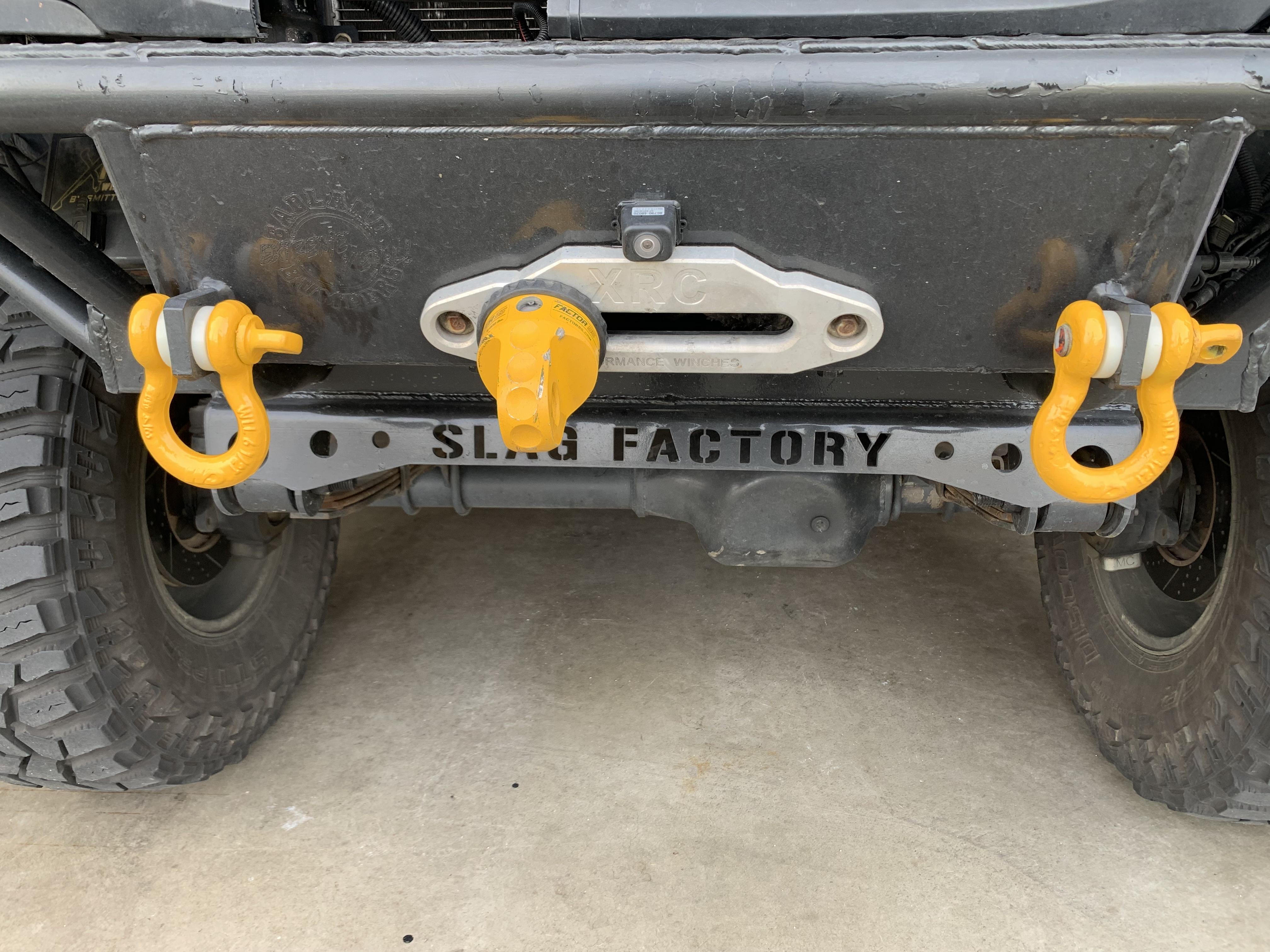

Since my house was getting painted, I had nothing else to do but paint myself. I refreshed my shackles front and rear with 3 coats of paint. Last time they had a fresh coat of paint was in 02-20-16 post #238
I also put two plastic spacers in between the .5 shackle bar sticking out on both ends of the front bumper.

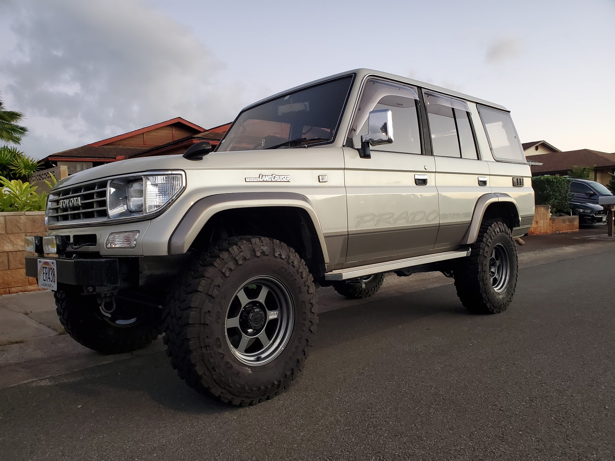

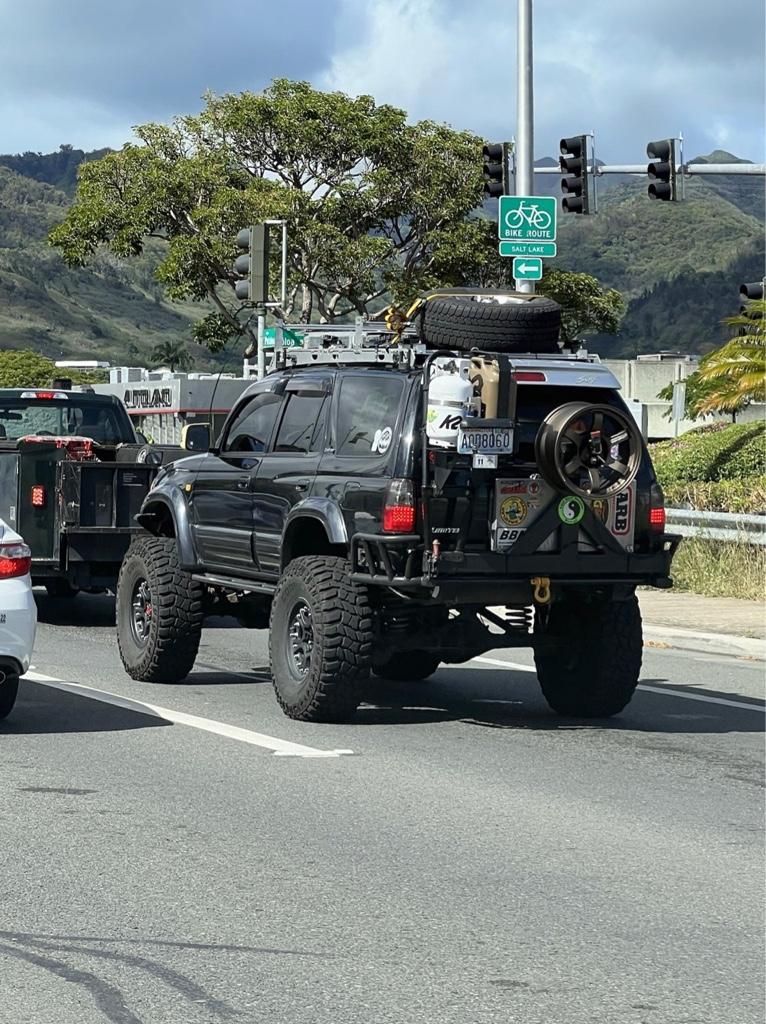

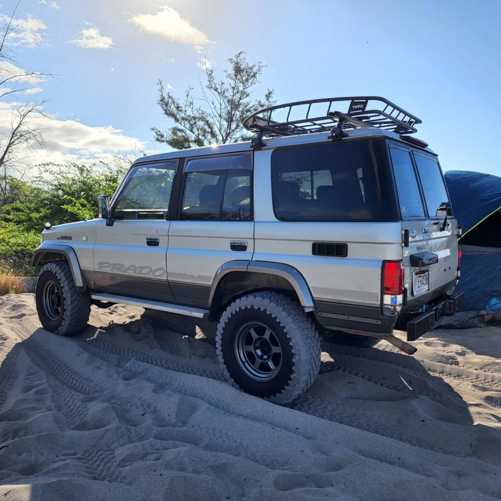

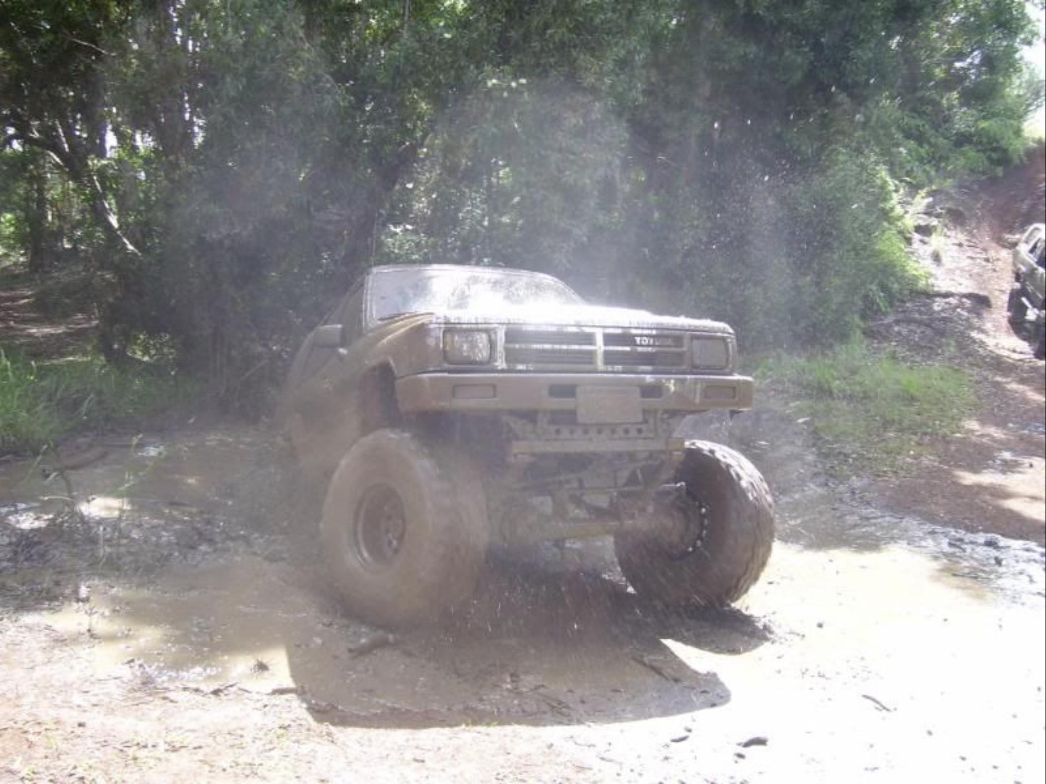

So my good friend back home on Oahu sends me two pictures of hiz new ride.
It has the 1KZTE turbo diesel motor

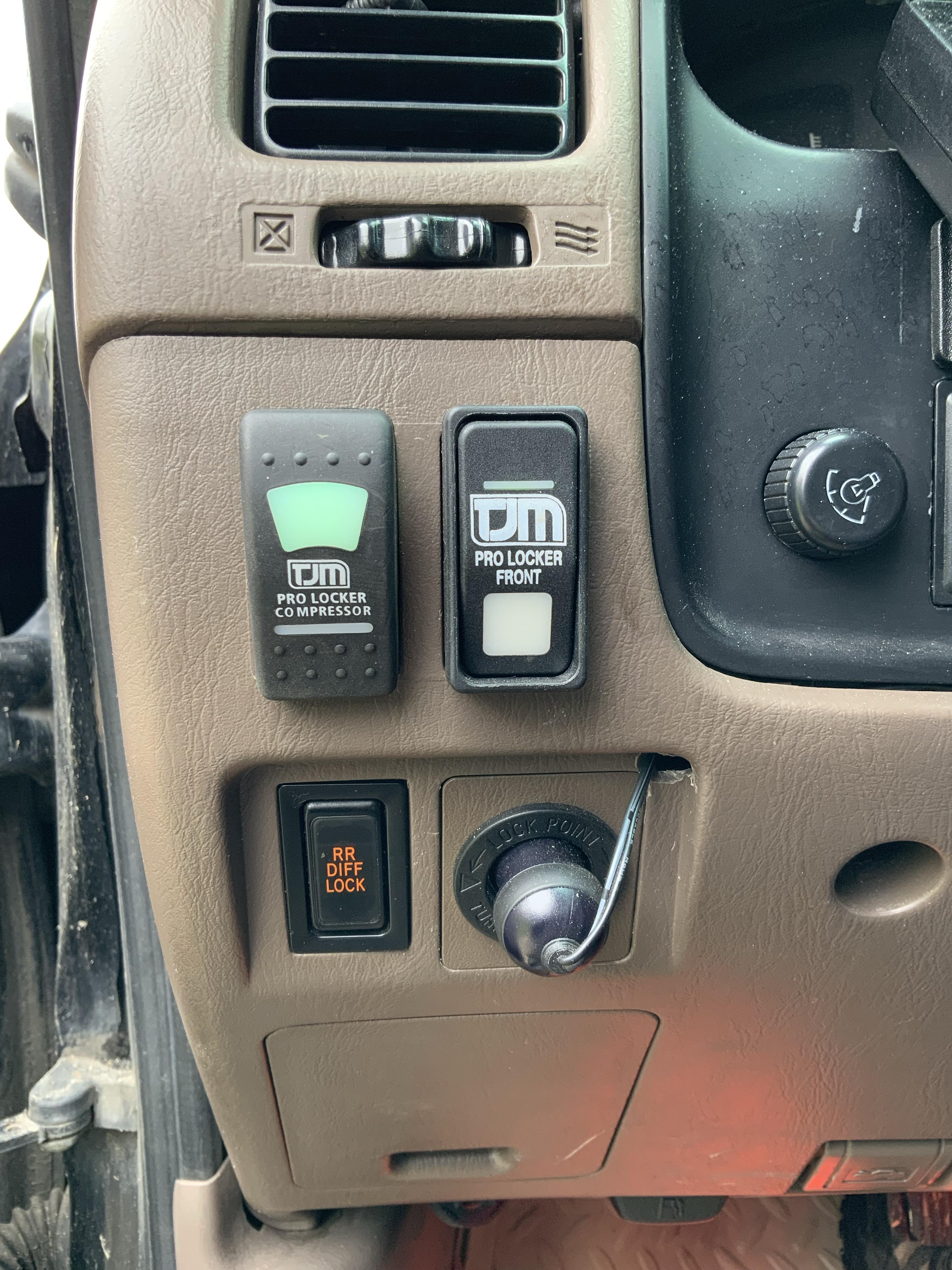

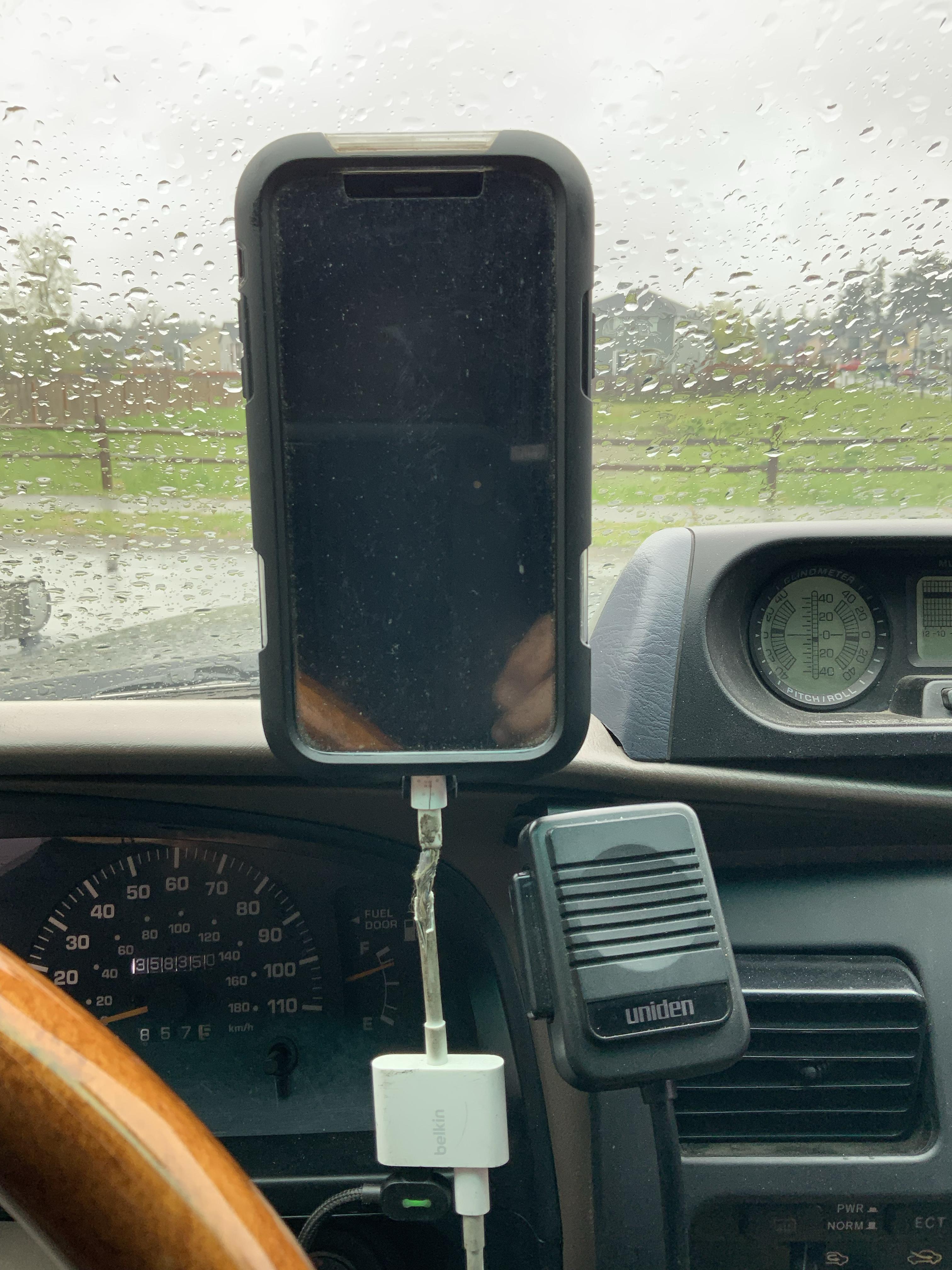

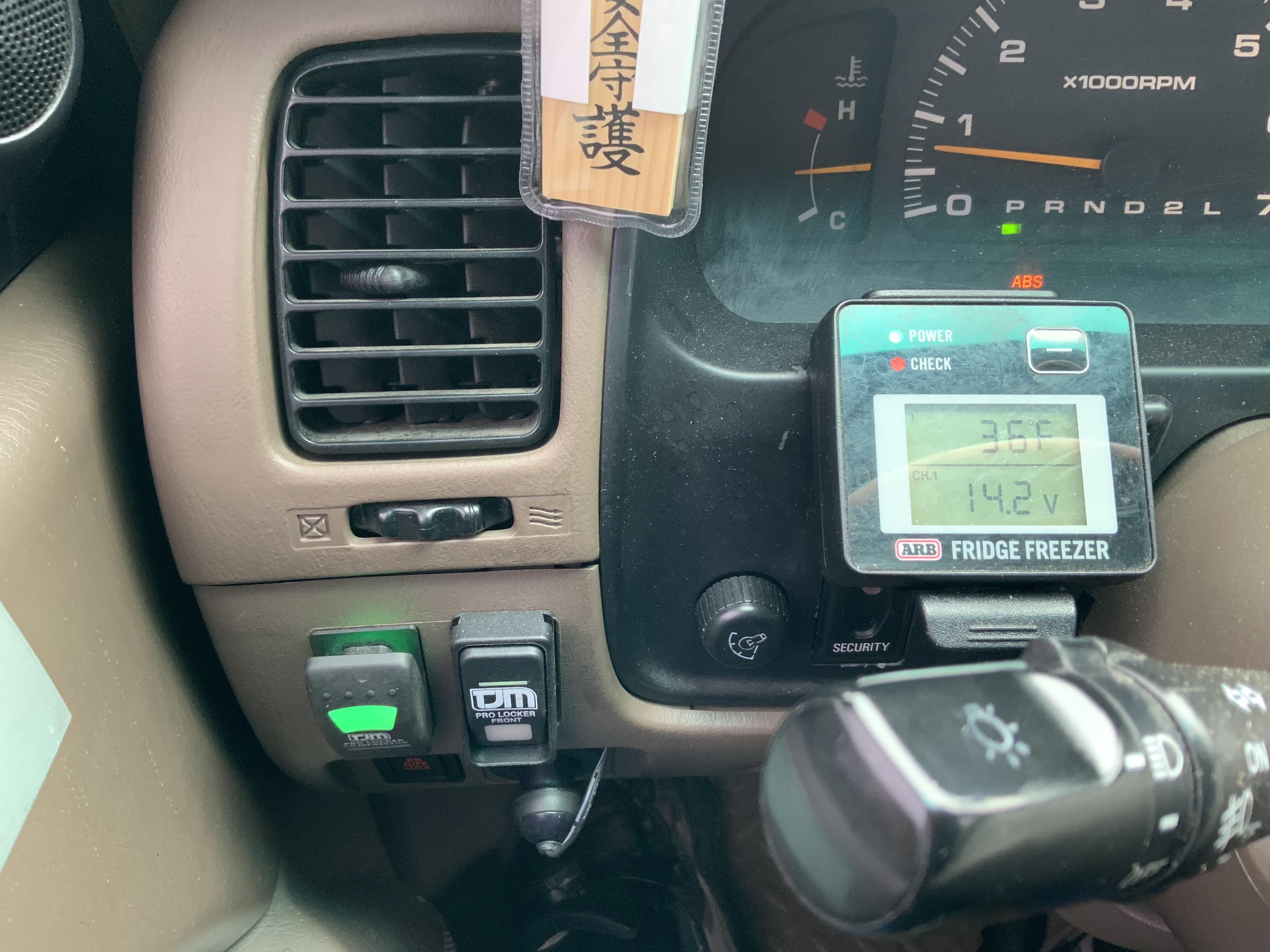

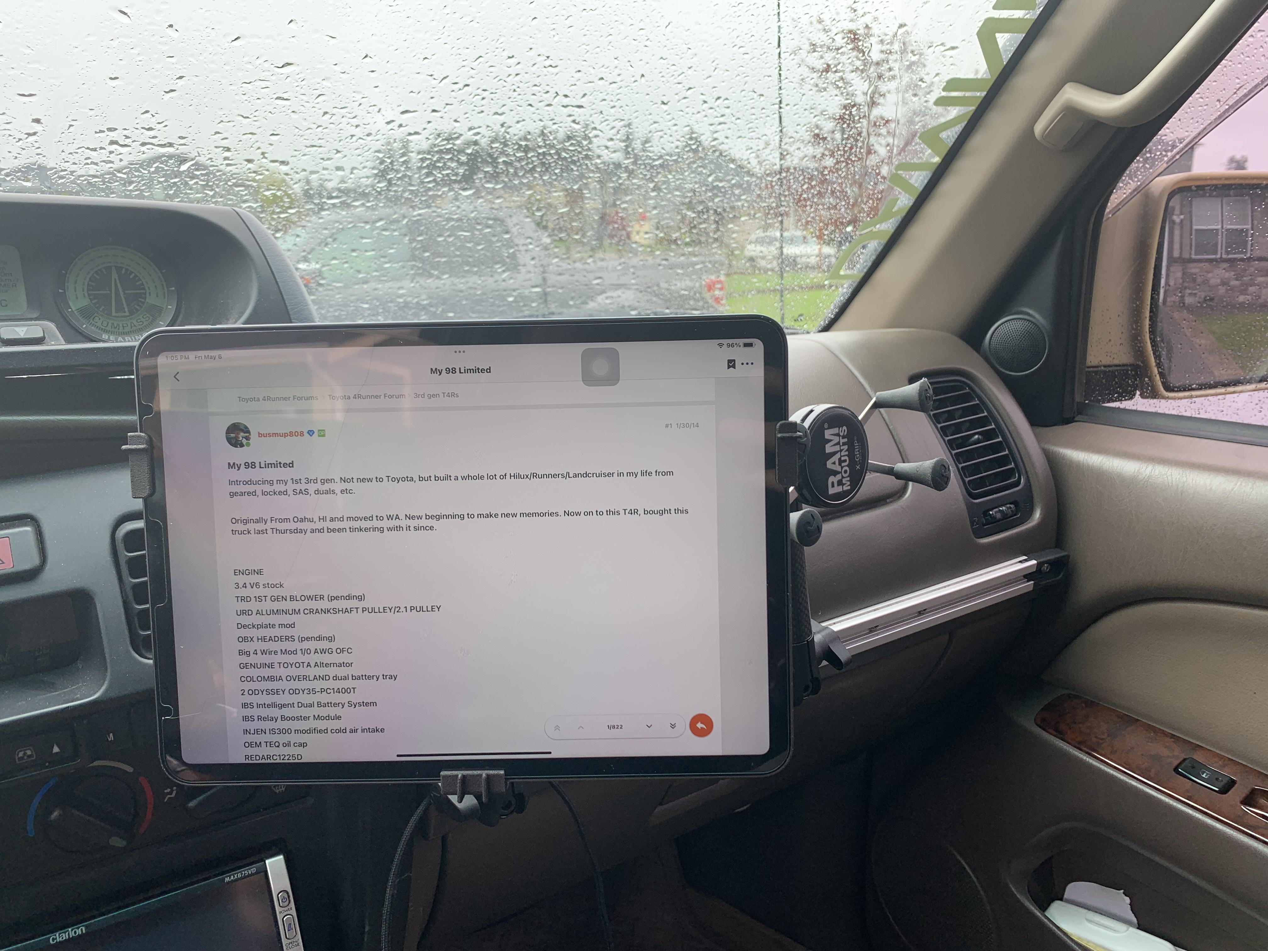

Updated my TJM/ARB locker switches to both TJM. The left switch turns on the compressor and the right switch turns on the front ARB air locker. I also took a picture of the 67DESIGNS iPad 11 pro holder when we are in camp mode. I only bring it out when we are wheeling for navigation or camping, so my wife can watch movies on the way to the destination. My son also has an iPad 11 pro for himself, because most times now that he’s older, he only wants to watch what he wants to combined with his air pods.

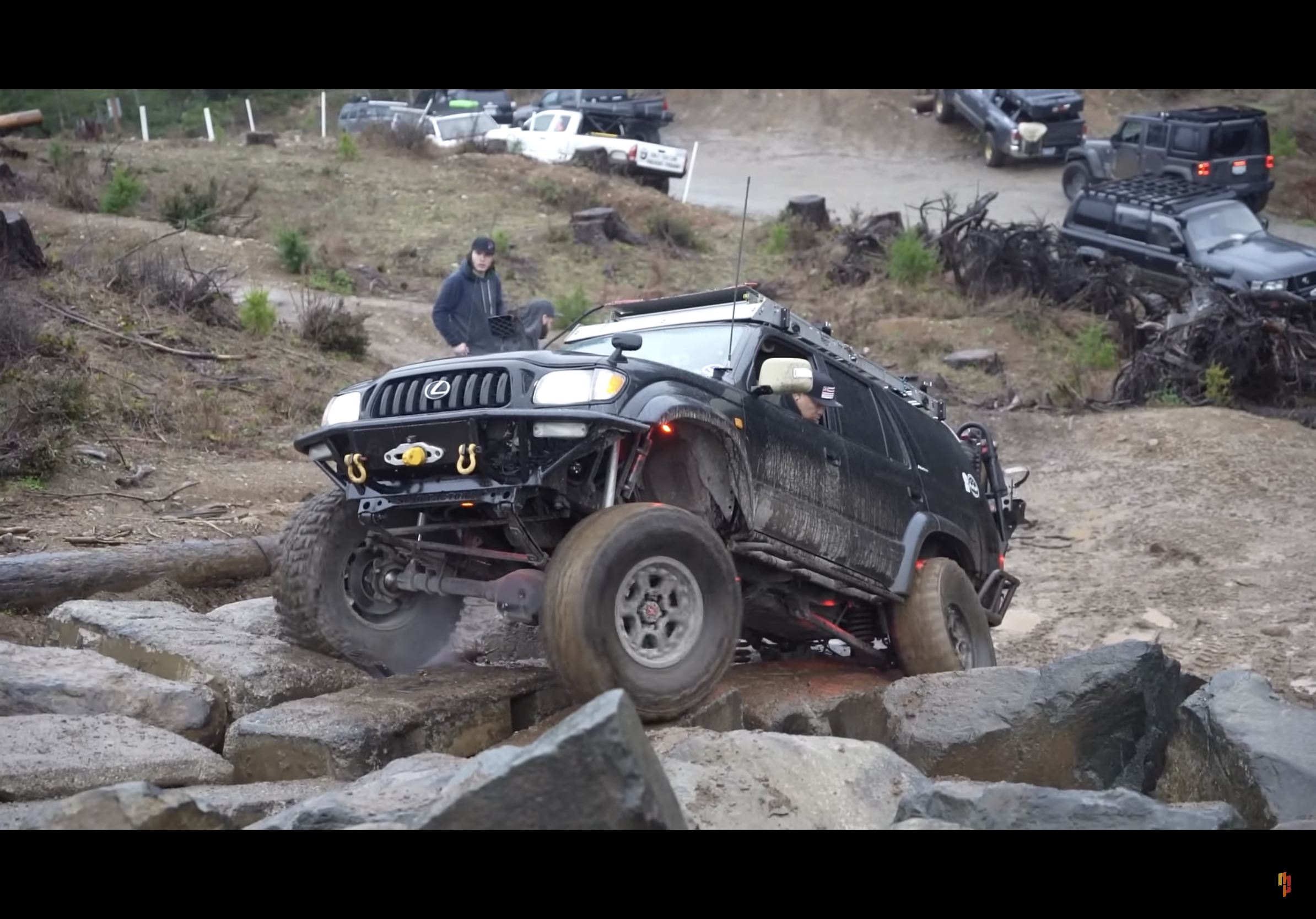

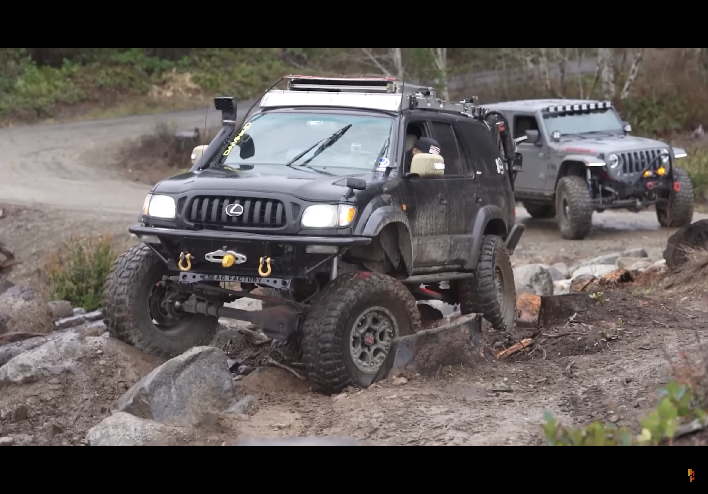

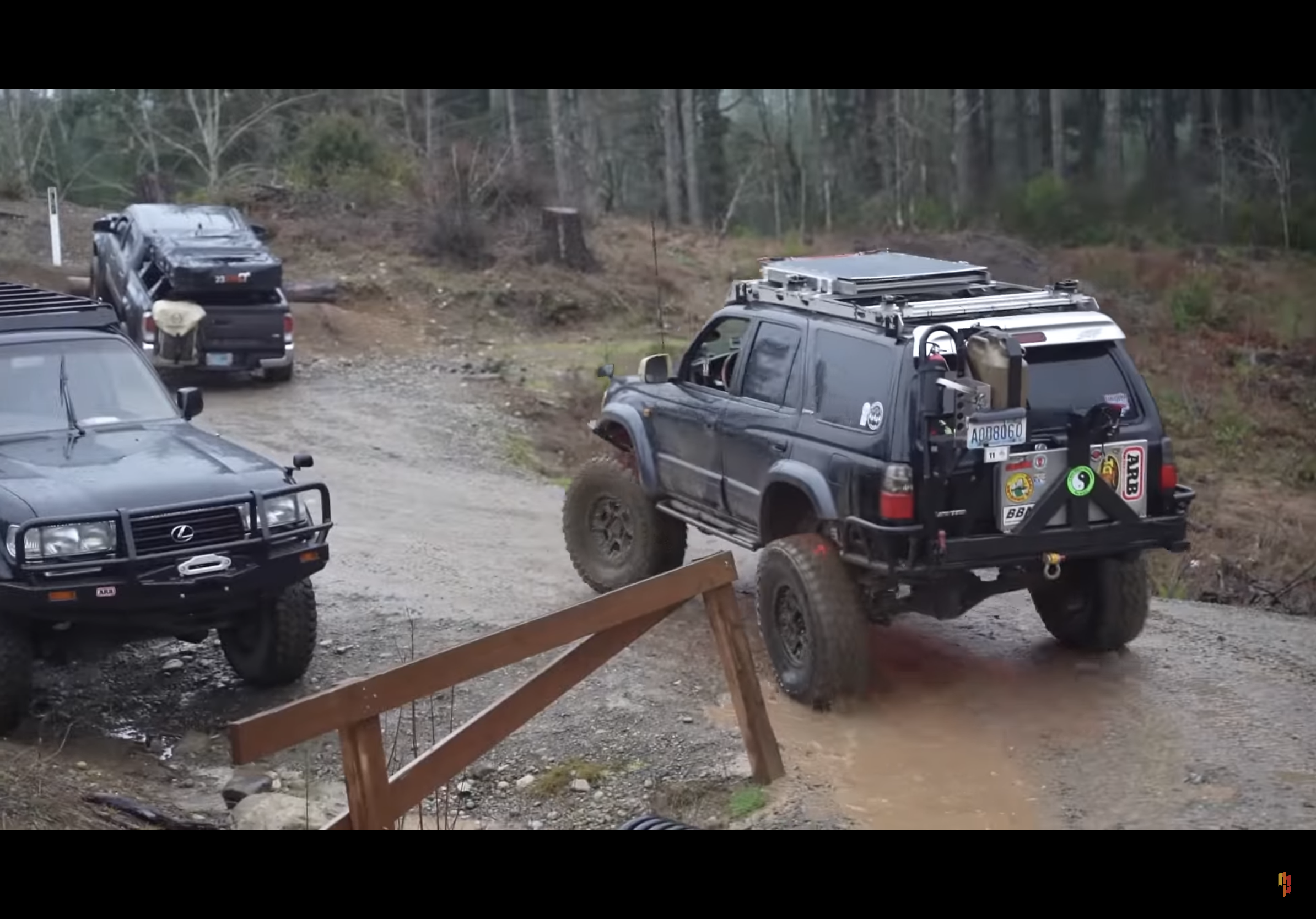

In April I went to TAHUYA ORV park and cycle the suspension out on Sasquatch hill. It was raining hard and muddy, but it did what it could in the conditions.

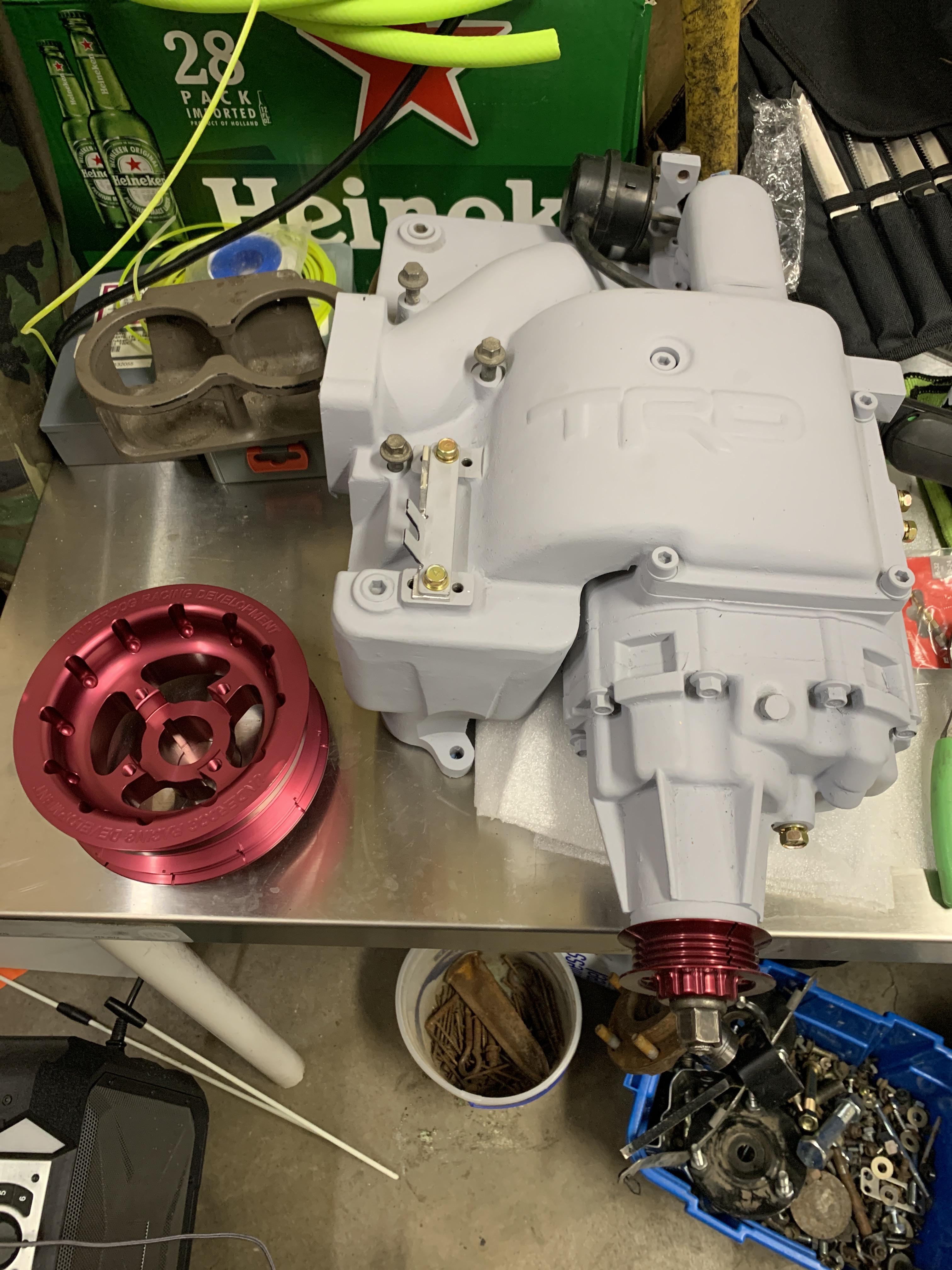

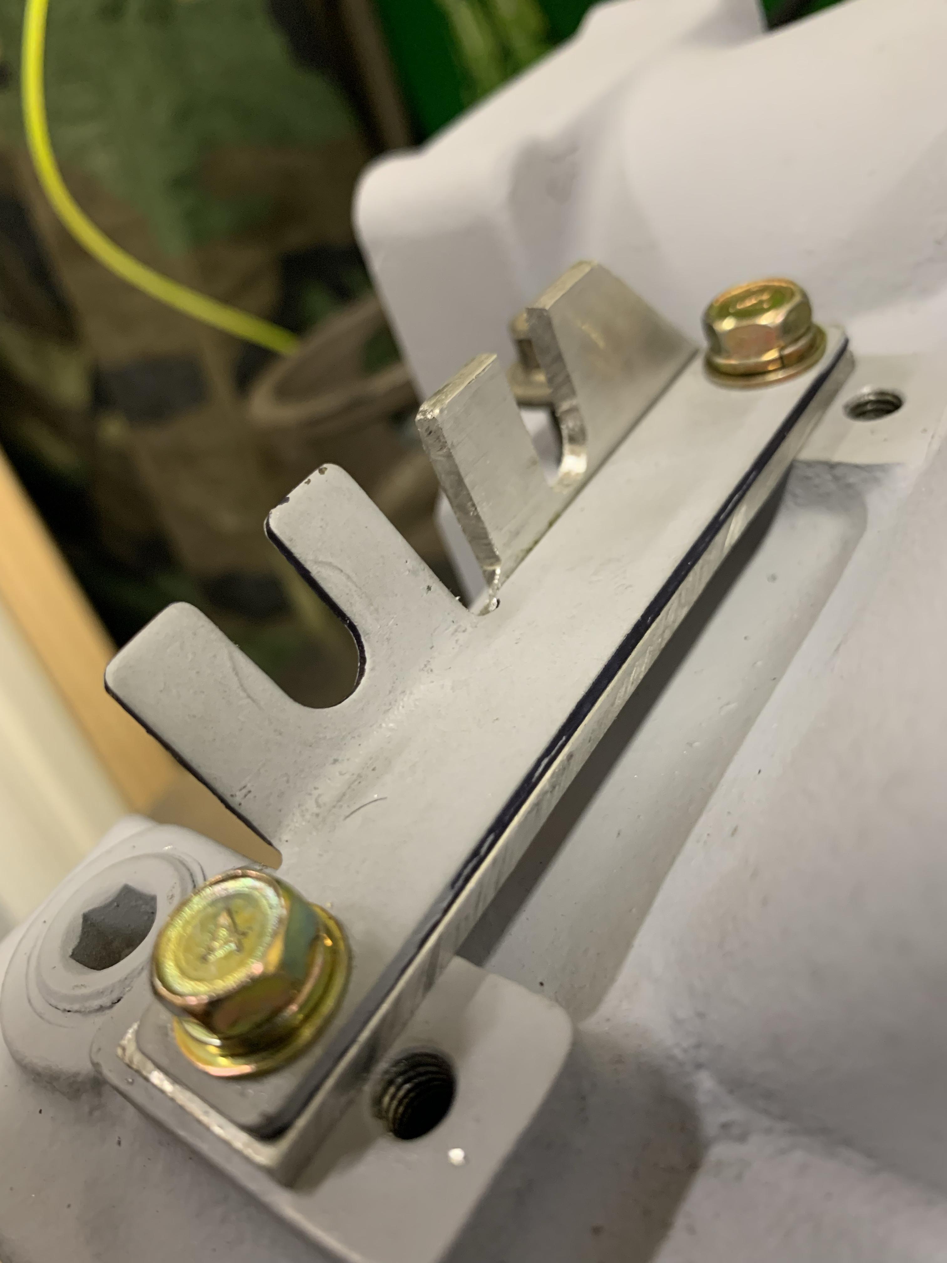

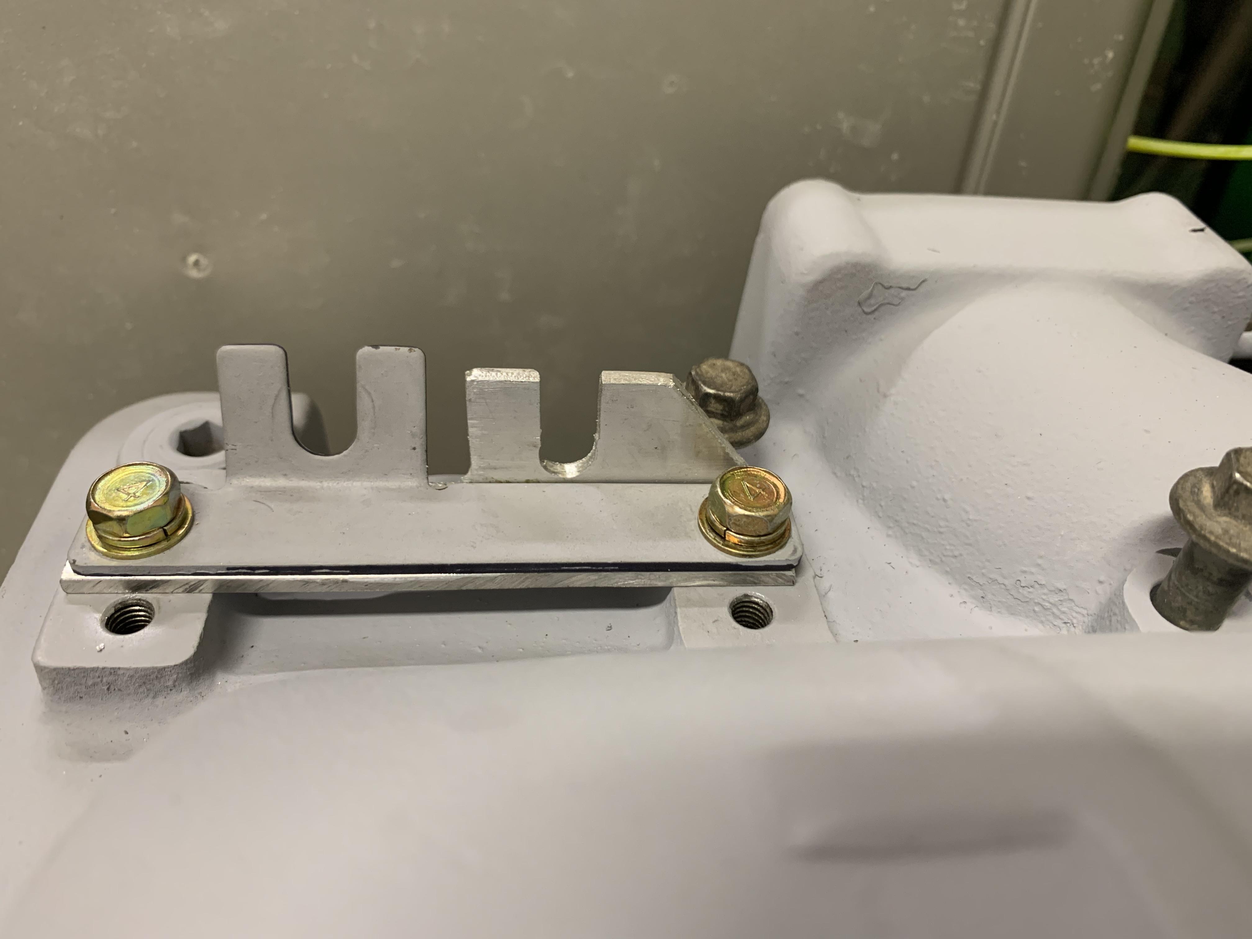

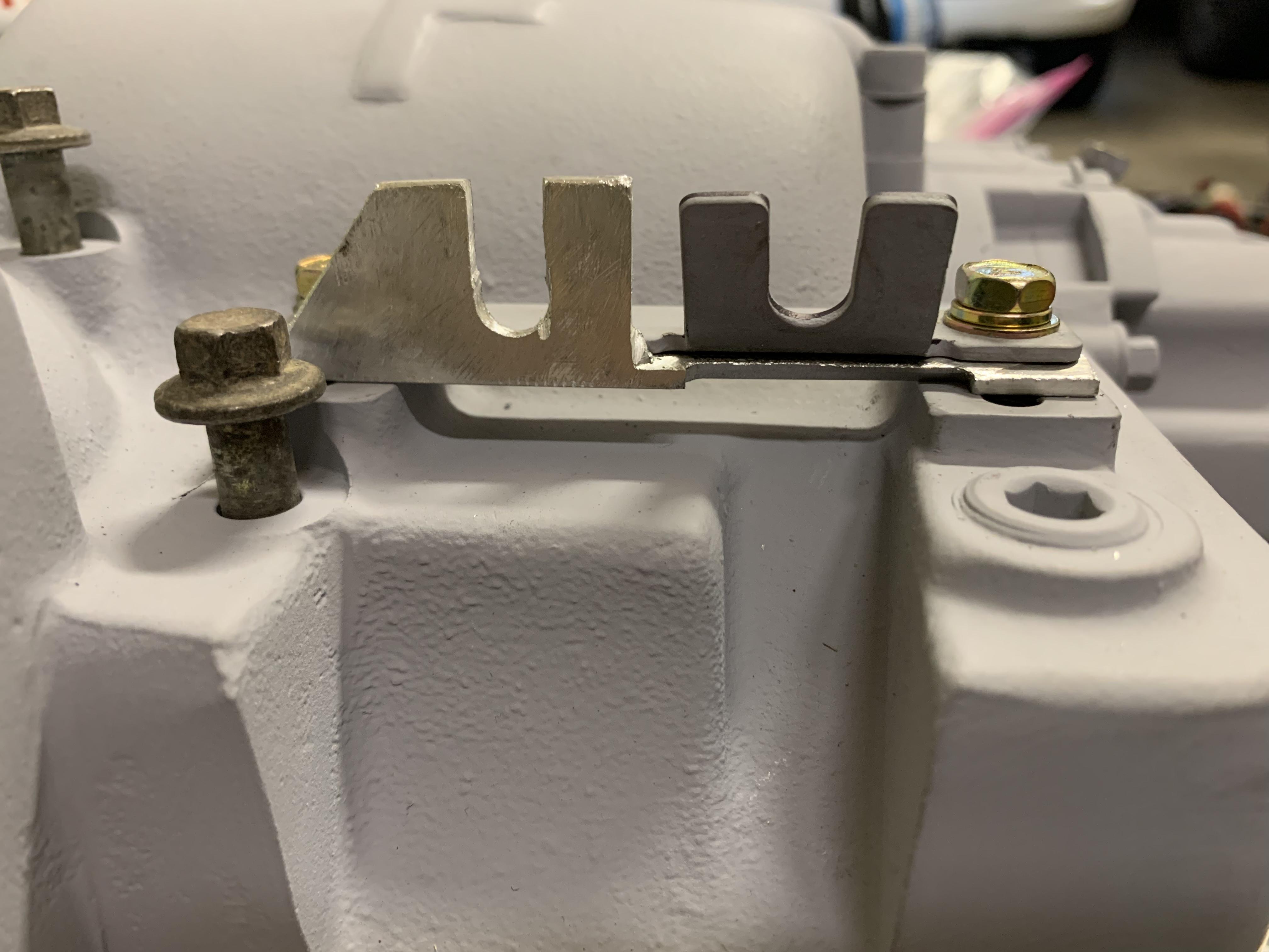

Next weekend I will be installing my SC and I needed the double bracket for the throttle and auto kick down cable. I didn’t want to buy one so I made the kick down bracket out of 6061 L angle aluminum. It’s not pretty, but it will get the job done.
Here’s some of the URD goodies that came a long x ago and finally going on next weekend.

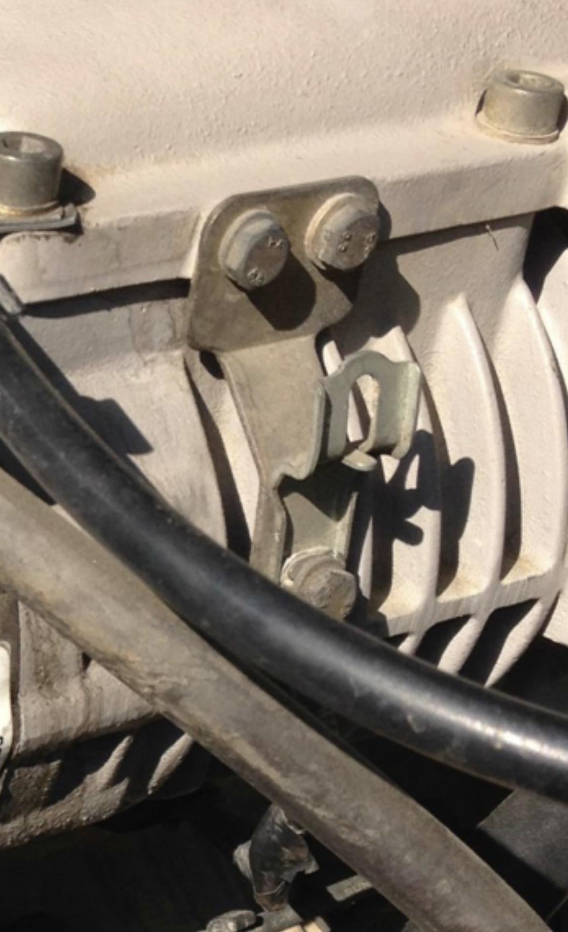

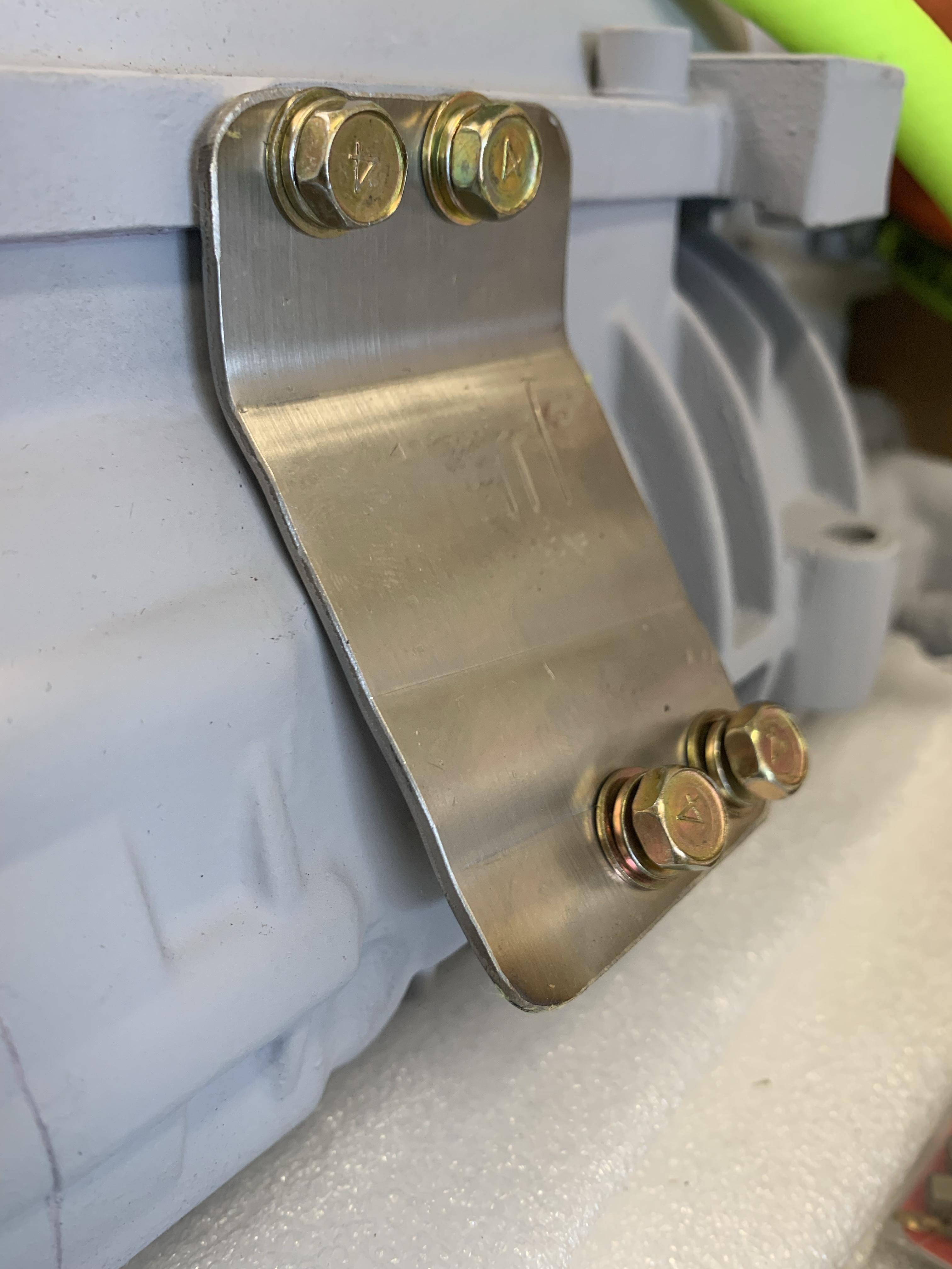

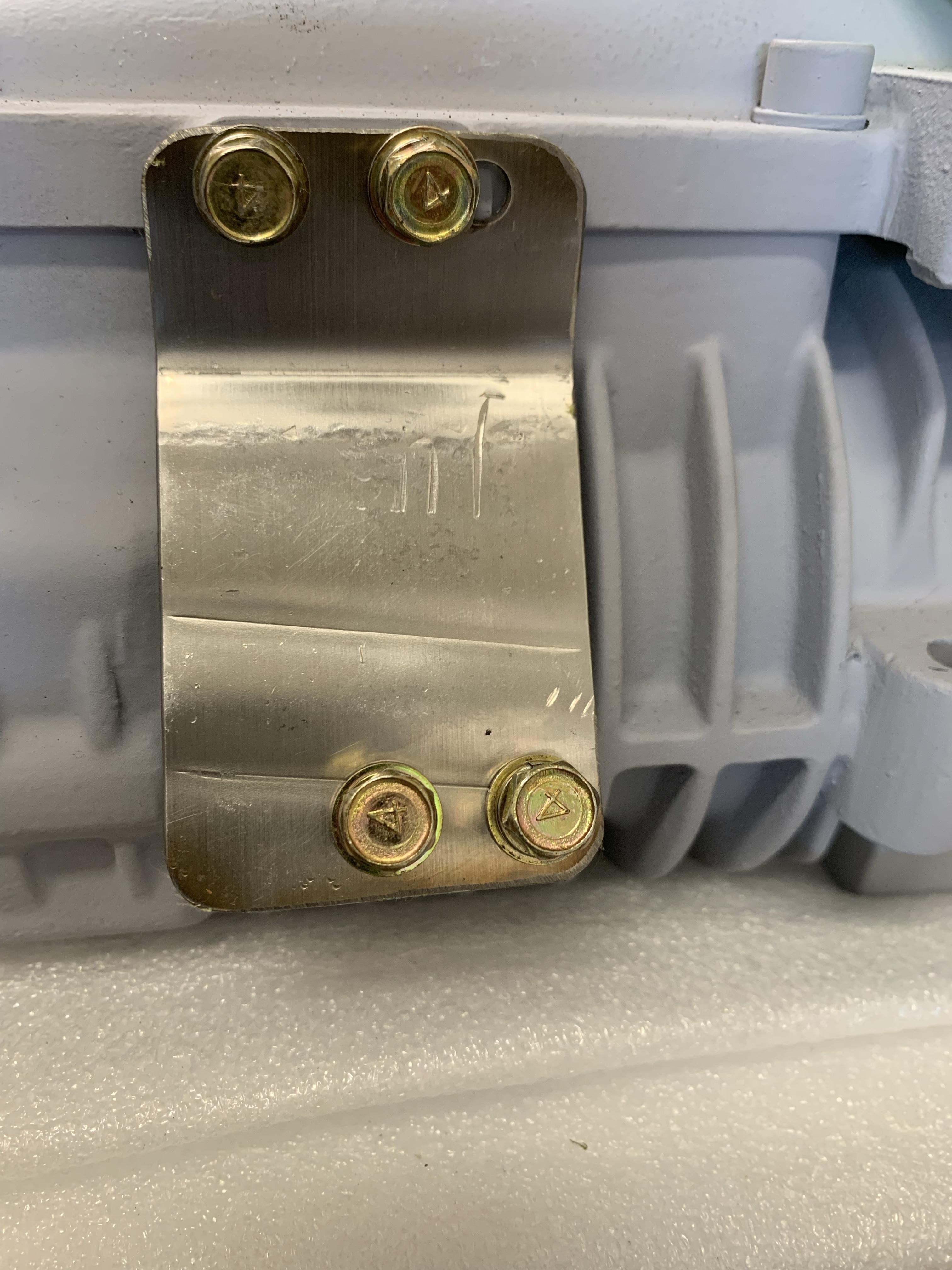

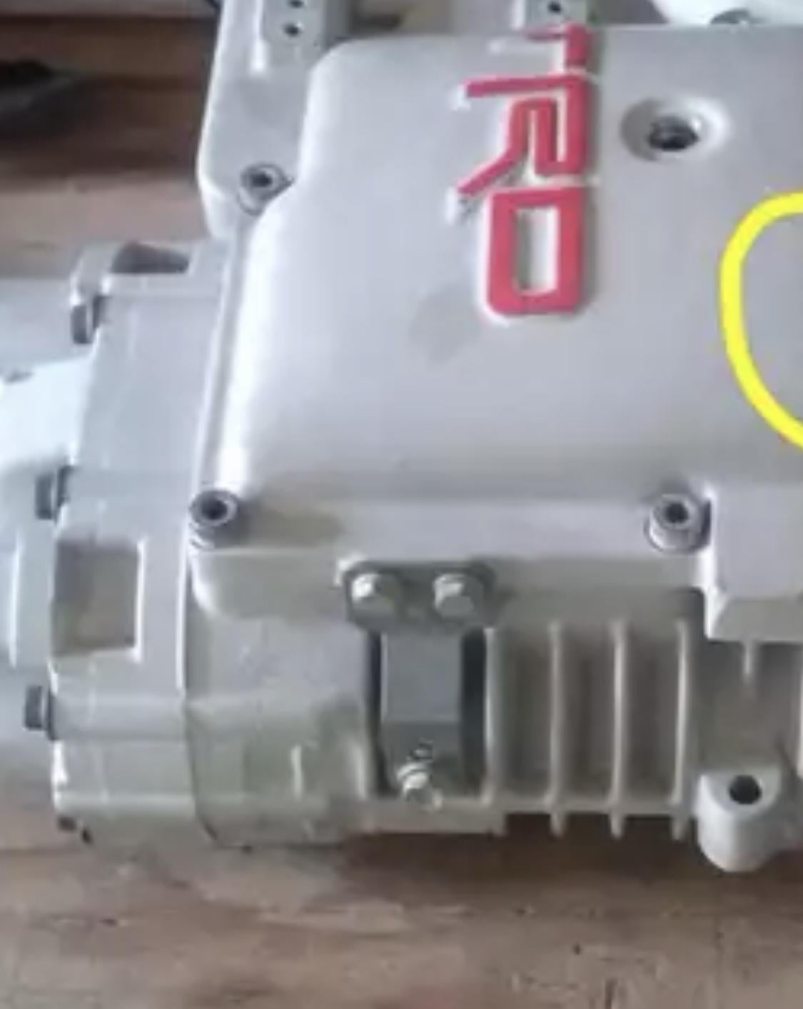

I just made a stainless steel bracket for the ground and diagnostic box. I also tapped the holes so I don’t have to weld a nut or just install a nut behind the bracket
The first two pictures are the original brackets that I didn’t have
This is the stainless steel bracket I made.
The original bracket has one hole on the bottom and mines has two holes:
Hole 1 (middle) for diagnostic box
Hole 2 (right) for ground wire

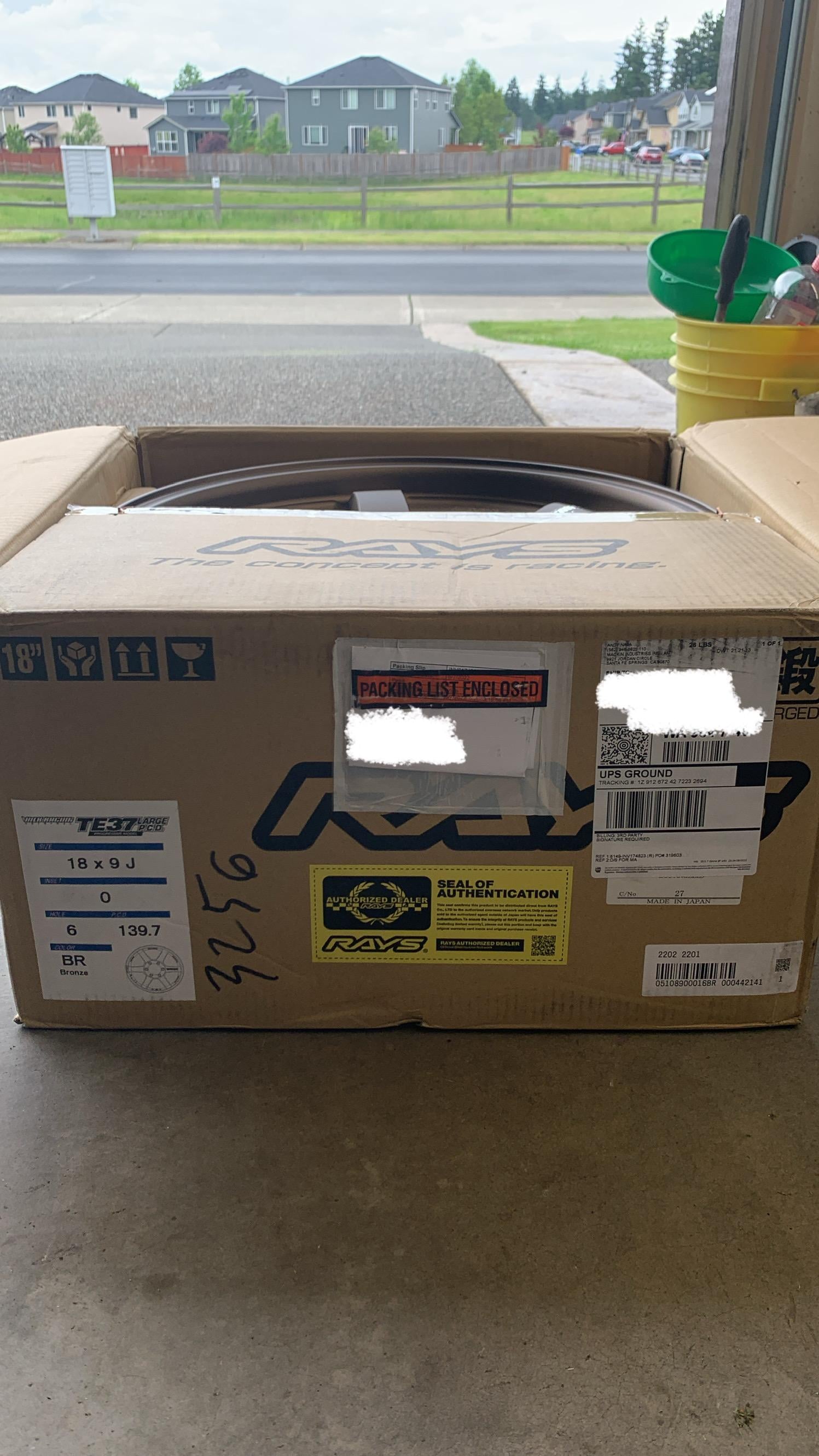

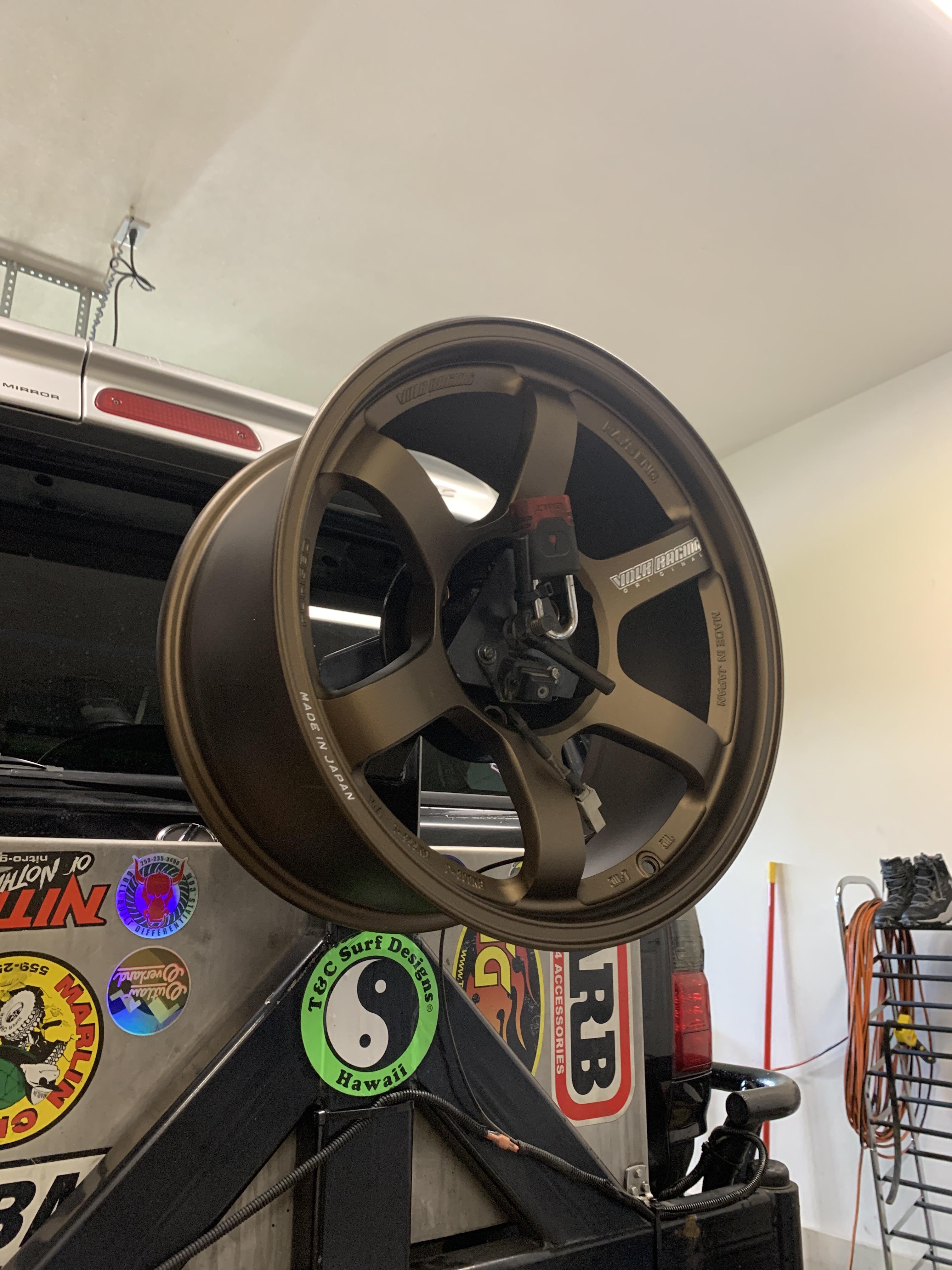

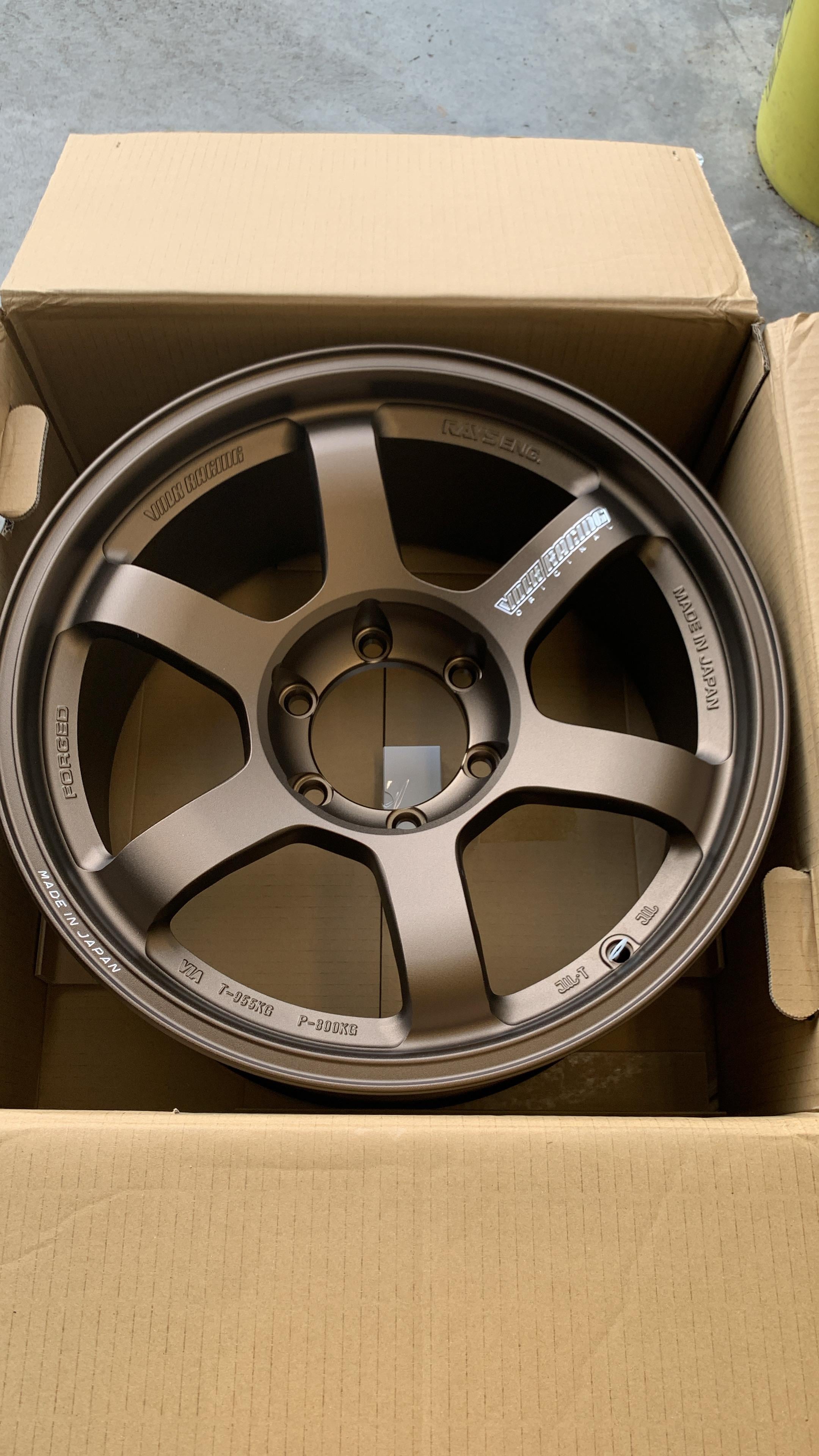

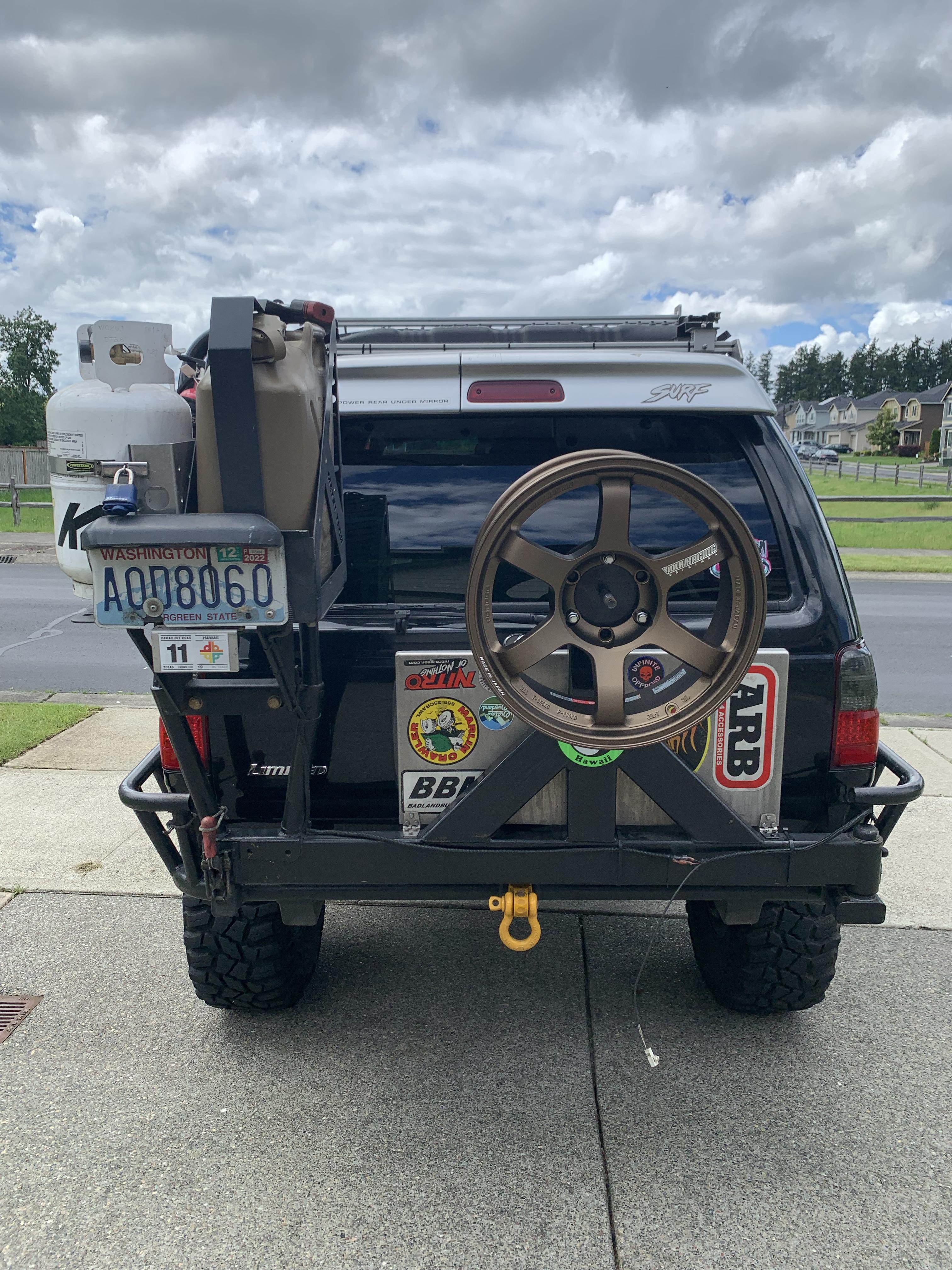

So I ordered this rim back in June 2021 and I just received it Friday June 10, 2022. I know that it’s not black in color like the rest of it, but the rims are discontinued from Japan as of 2020. I was lucky just to find a single rim for a matching spare.
I’m so glad I didn’t have my spare tire on my truck. Something told me in my brain to ship it in the container to Hawaii. If I didn’t listen to myself, I would of have to pay to ship the extra rim back to Hawaii. My wife wouldn’t have been happy about that.
The rim is locked and ready to be shipped with my truck next Thursday

Chee! red mud gunna look good on that black paint
Dis iz my 86 runna @helemano. My truck is silver. I’m born and raised hea in da islands, so I’m not afraid of mud. I actually luv it, but not a fan of cleaning it![emoji23]
