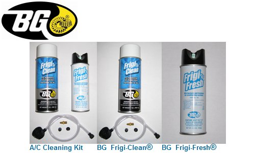

It sounds like you used BG's Frigi Clean (check picture)

I do sell the 2 part kit here at the big dealer ( Frigi-clean,Frigi-fresh) (check picture) for around 50.00 plus t/s

It could've also been DWD2 brand. Same type of treatment as BG Frigi Clean
,injecting a foamy chemical into the evaporator/heater box through the AC drain tube or drill a hole into the box and thread on the fitting in the picture.
Although I don't recall DWD having a second can,cfrank1 is Frigi Fresh a "bomb" style spray,where the nozzle locks open once you squeeze it?
No, the "Fresh" is NOT a odor bomb. The sprayer is only a momentary sprayer. Spray as much or as little as you like.
