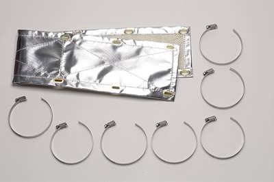

So I've been reading for some time about how the 3vze 3.0l heads blow out in
the same place the driver side rear Which is where mine failed. I just wanted
TO share my attempt at a cost friendly solution to 600 dollar headers. i just
purchased from Summit racing a 3 ft Themo Tec heat shield rated for up to
2000degrees its a heat shield that clamps on. Part # the11630 for the price of
47.00 Im hoping it helps to reflect the crossover pipe heat!!! Now I realize this is not going to give me performance increases i just want to cool down my engine when i get the wrap in the mail ill be sure and post some pics if anybody's interested. I HOPE I CAN COOL MY BABY DOWN !!!

yeah this kit comes with clamps I think its going to be a good solution

and if the wrap does help!!!! im not really in the market right now for 600 dollar headers i figured this was worth a shot and it def cant hurt anything. It was like my post said looking for a cost effective way to take away heat from the head i think this is it. if i have to change my head gasket again in the future and this dont work so be it. Ive gotten pretty good at changing them by now anyways !!! LOL!!! anyways im gonna take some temp reading before and after when i get the stuff and see if it helps at all!!!
