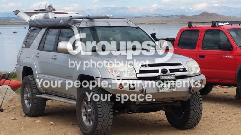

Here's how I did mine:

Makes sense. I wish I had a break big enough to do 3/16. Bending the plates would have been much easier. I like #1 btw. How did you mount it to the frame horns?
