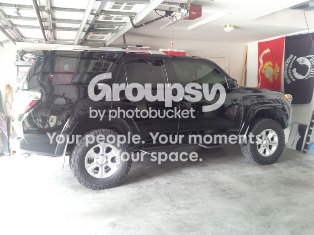

i used the 1.5: daystar spacers but swapped them out for SAW coils.
<---------Pics in my garage
So your lift heights are still 2.5 f/ 1.5 rears?
more like 2.25"/1.75".
