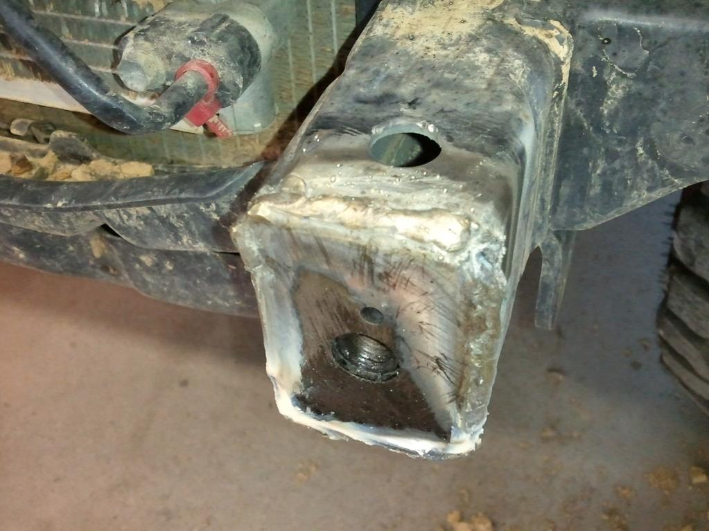

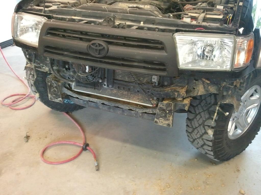

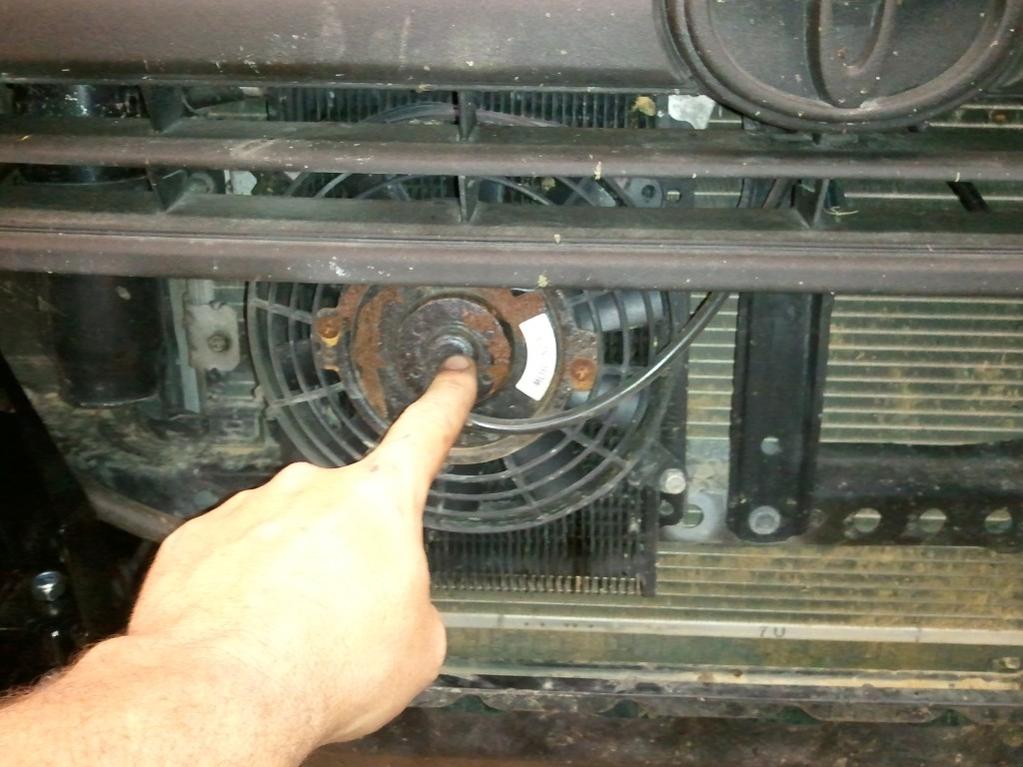

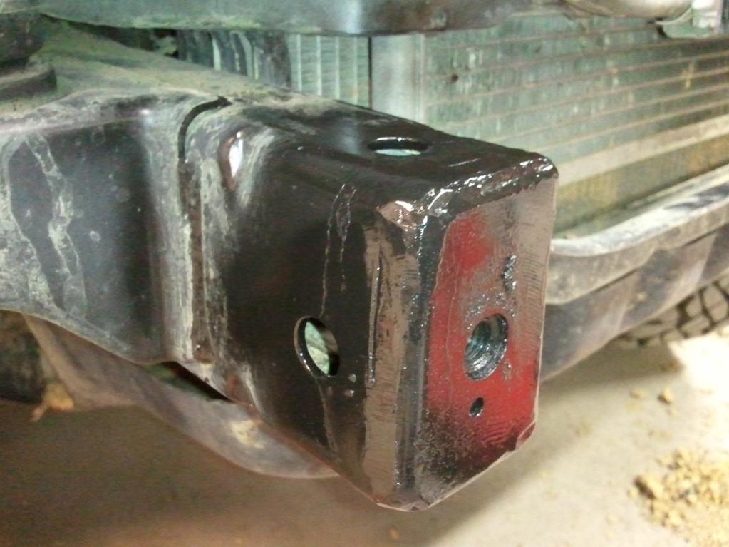

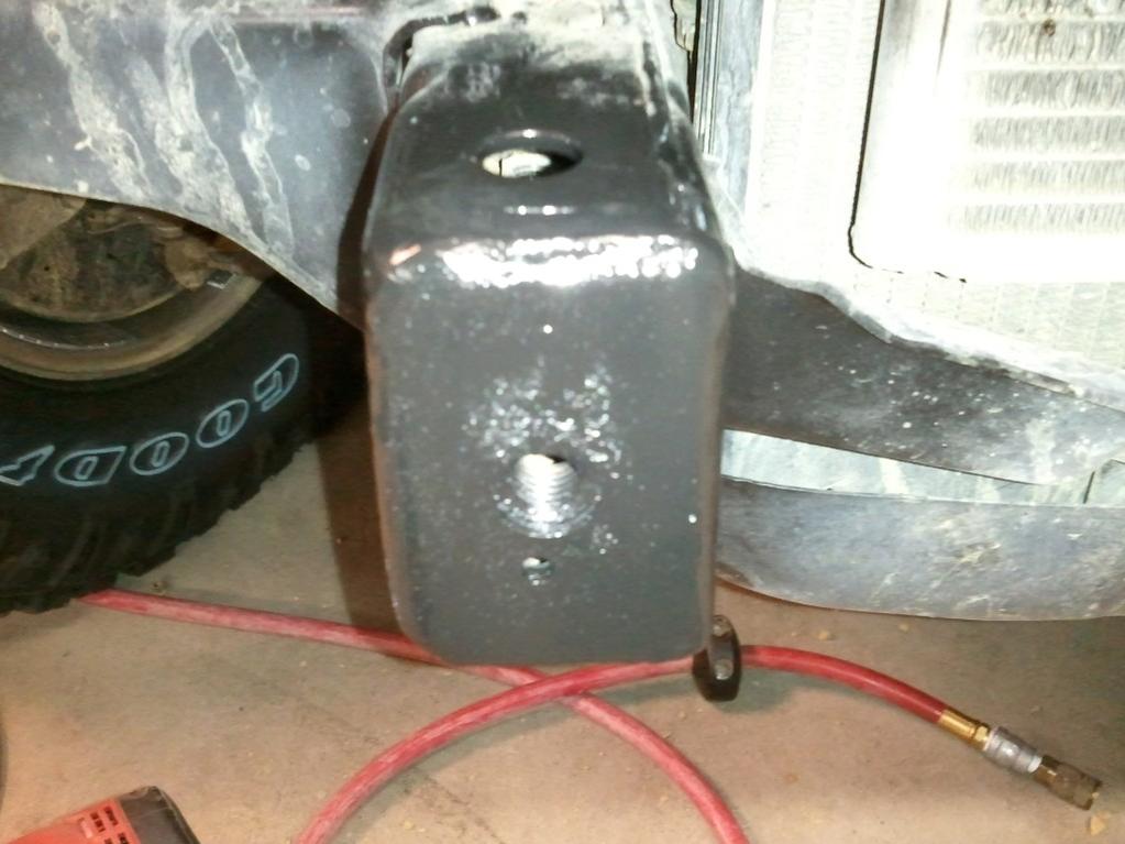

So I started removing my front bumper last night so I could install my new ARB bumper. I performed the "end cap mod" to strengthen up the frame rails. All went well......at first. When I went to mount the bumper, it hit my cooling fan for my transmission cooler:mad: I had to remove the fan for now. I am going to have to re-design the cooler/fan location to accommodate the new bumper.
I don't have any good pics of the bumper on the vehicle, since I finished up at midnight last night:cool:

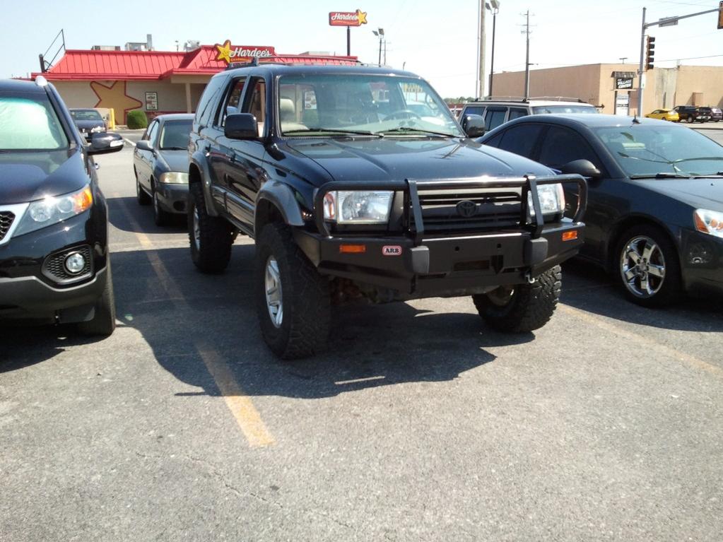

pic @ Work
Here is a pic I took here @ work in the parking lot....not the element she wants to be in, that is for sure.
I will post up better pics once I get the winch and lights installed.

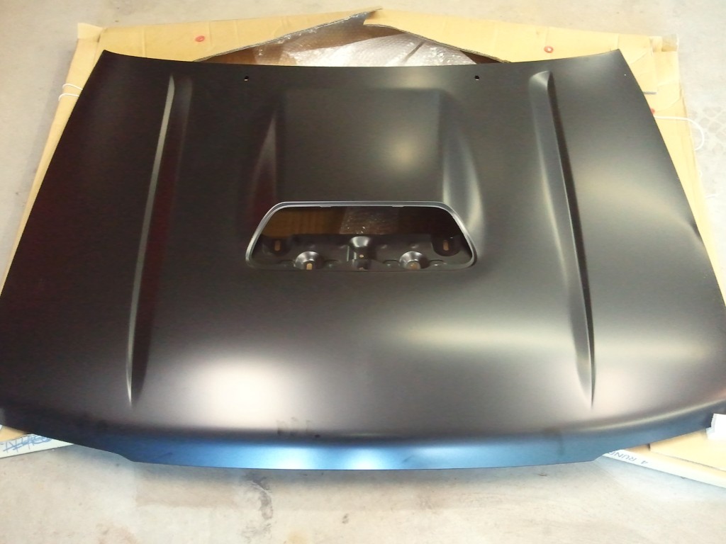

However,:frog:, I am excited because I am going to St. Louis tomorrow to go to Certifit to pick up a Sport Hood!! :reddance: I LOVE the way they look, and for the price, I HAVE to get it. It is $73. I can get all of the toyota "scoop" parts for around $110, so for around $200 + paint I will have my sport hood. Because I want to paint my trim black ANYWAY, the paint costs will be offset somewhat. (as if I need an excuse to spend $$ on the runner)
Here is a thread that talks about how to buy the scoop parts as a "kit" Link HERE
My Toytec lift should be here tomorrow, so this weekend I will have a Winch to install, Sport hood to play with, and a lift to put on. Should be a fun weekend.:party:

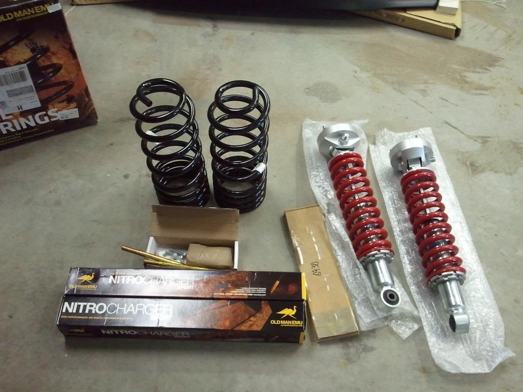

I started working on my rig after I got home from work yesterday, taking my time. My goal was to install my Toytec lift (coil overs, diff drop, rear springs), and to replace my LBJ and OTRE with the Tacoma pieces. I stopped for supper around 11 pm. Finished up around 1:30 am this morning.
All in all it went very smooth.
Here is the truck before the Toytec lift. This is the factory springs w/ 1" front spacers and 1.5" rear spacers, sporting my new ARB bumper.
I'm not going to bore you with all of the details of installing a Toytec lift, there are plenty of write-ups on here with that info. I will show some of the pics, however:
