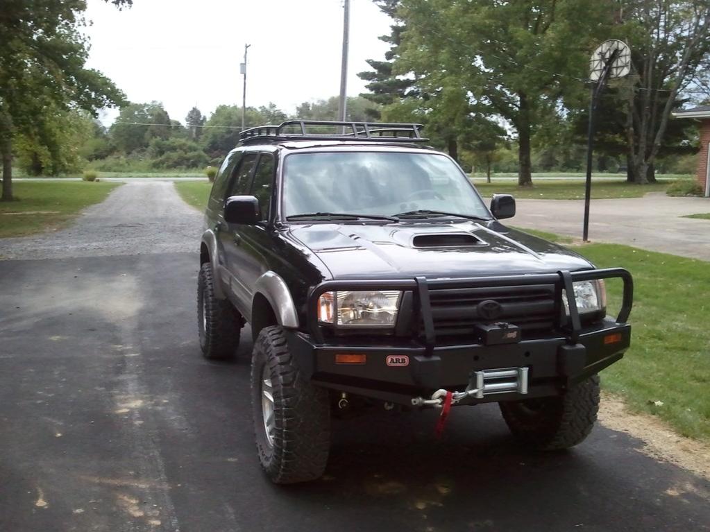

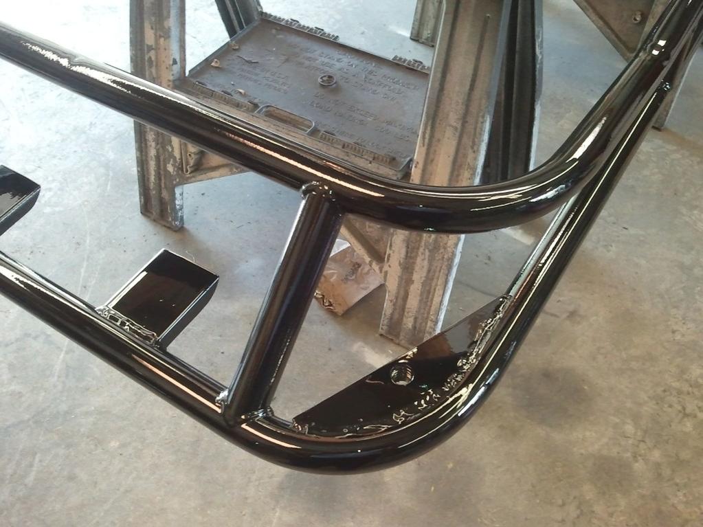

roof rack is painted
The quality of work on my new Whitson Metalworks rack is great.
I wonder how many racks get painted with a basecoat/clearcoat setup?:banana:
Because I am in the middle of painting my truck's hood and flairs, I went ahead
and painted the rack with the PPG basecoat black (Toyota code 202) and then
cleared it. I should be able to mount it all up tonight.

That looks hella good!
I am counting the minutes 'till I get off work so I can go home and install it. It looks like we are going to get big thunderstorms however and I may not get a chance to install it tonight, and I have plans tomorrow night so it may be Saturday before I get the change to mount everything.:mad:
Oh well, on the + side it will give the paint more time to set up and harden.:artist:

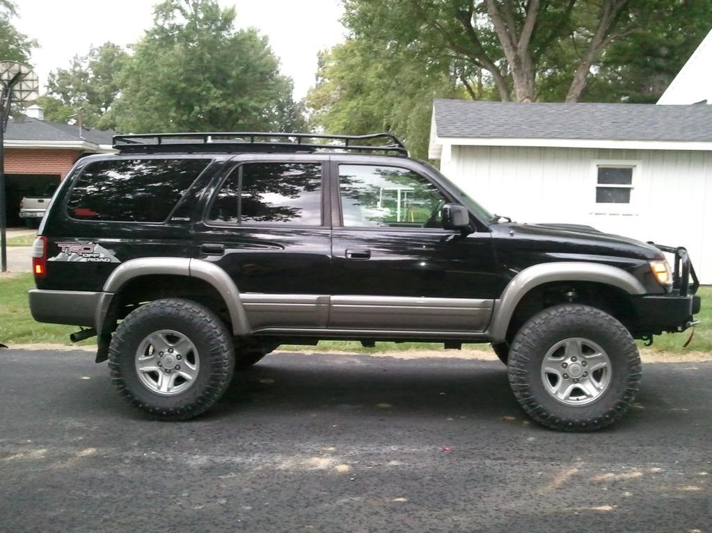

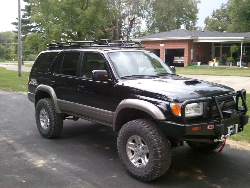

rain rain rain
Well, by the time I got home, thunderclouds were looming overhead.:(
With the help of my lovely wife :girl: we were able to get the rack up on the roof and mounted as it started raining.:D
The pics aren't great due to the weather, but here they are ..I LIKE it!!:trophy:
I will post up better pics tomorrow when I can get a better angle and more sunshine.

The bottom picture is great! Looks like you got the placement fore/aft perfect. I noticed you hadn't put the front supports on yet, you may find they aren't all that necessary unless you plan to carry things hanging over the front. Mind if i use that picture for future inquiries? Sweet looking rig BTW!
I was running out of time for getting pics so the first few pics don't have the front support, but that last one the front support is installed, it is just hard to see.
I don't mind if you use my pics, heck I would be honored.:bluejump: If you want higher resolutions pics, just let me know......oh and thanks for the kind words.:cheers:

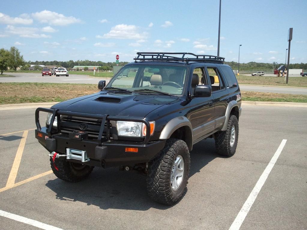

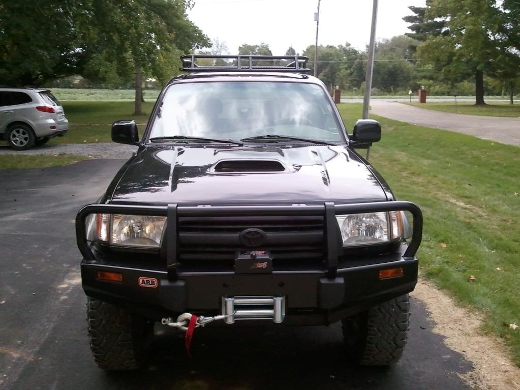

Pic in the sun :)
Here is a pic in the sun from the other side.:cool:
Now I need to get this thing off road for some real pics....non of this pavement junk:bluejump:
