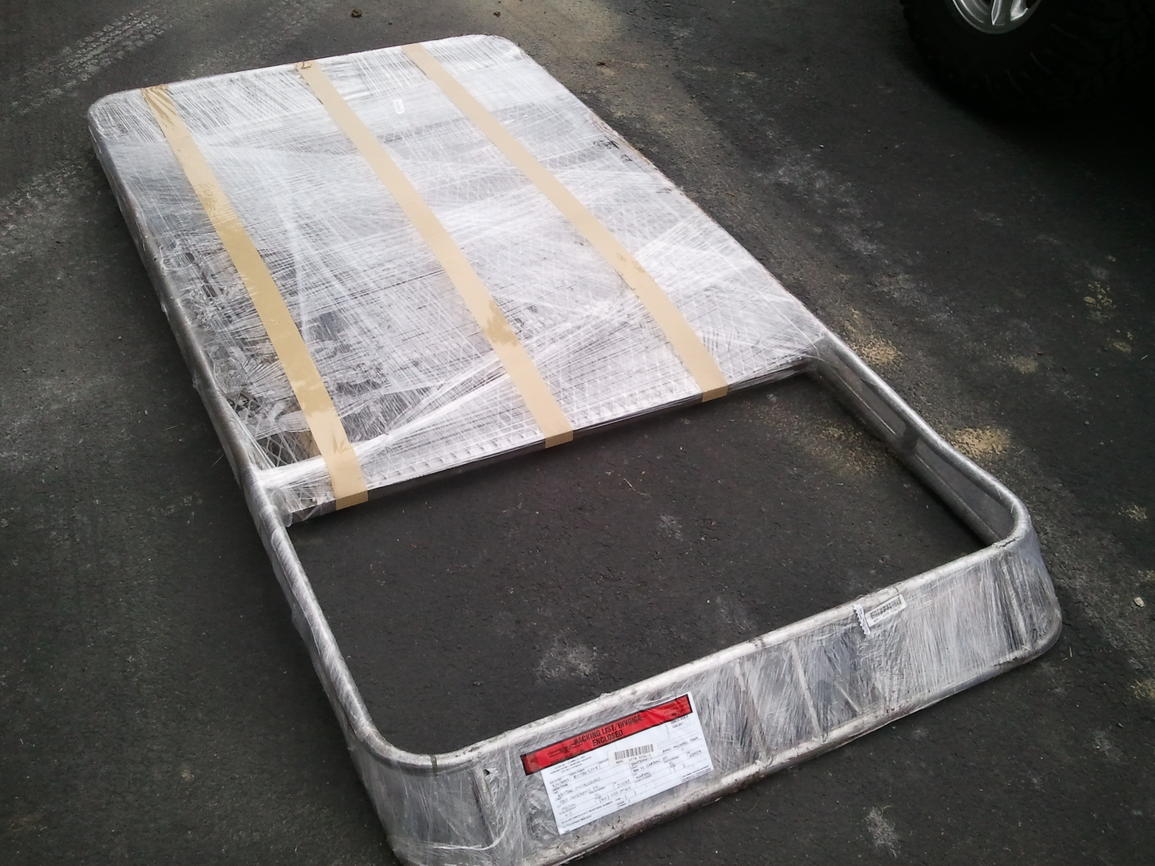

My 1" body lift arrived yesterday from a fellow forum member(SCRunner12) and the roof rack from Whitson Metalworks showed up at my workplace.:hungry:
I work at a bank, so you should have seen the eyebrows raised as this semi-truck pulled into the parking lot to unload this full-sized roof rack.:wow:
hehe...I love this stuff.
Anyway, I got it home and I will begin the prep work to primer and paint it. I need to figure out just what accessories I want to mount to it, and make the associated mounting tabs.
Hi-lift jack and small shovel come to mind. Jerry can holders also spring into my head.
because I have enough paint supplies, I MIGHT, might i say, just have to basecoat/clearcoat this bad boy when I paint my limited flairs.....decisions, decisions....:D
Here is a pic of the rack as it arrived off the truck.
