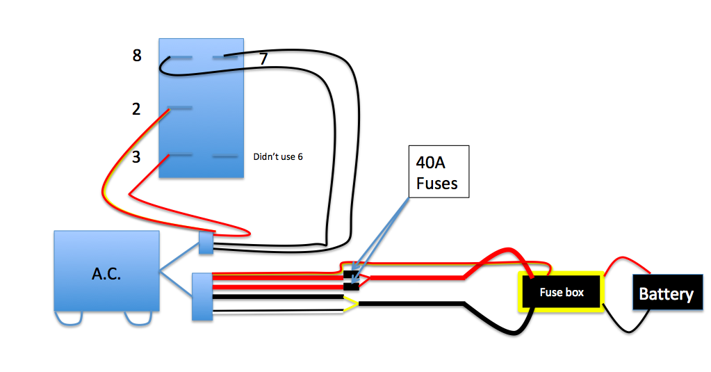

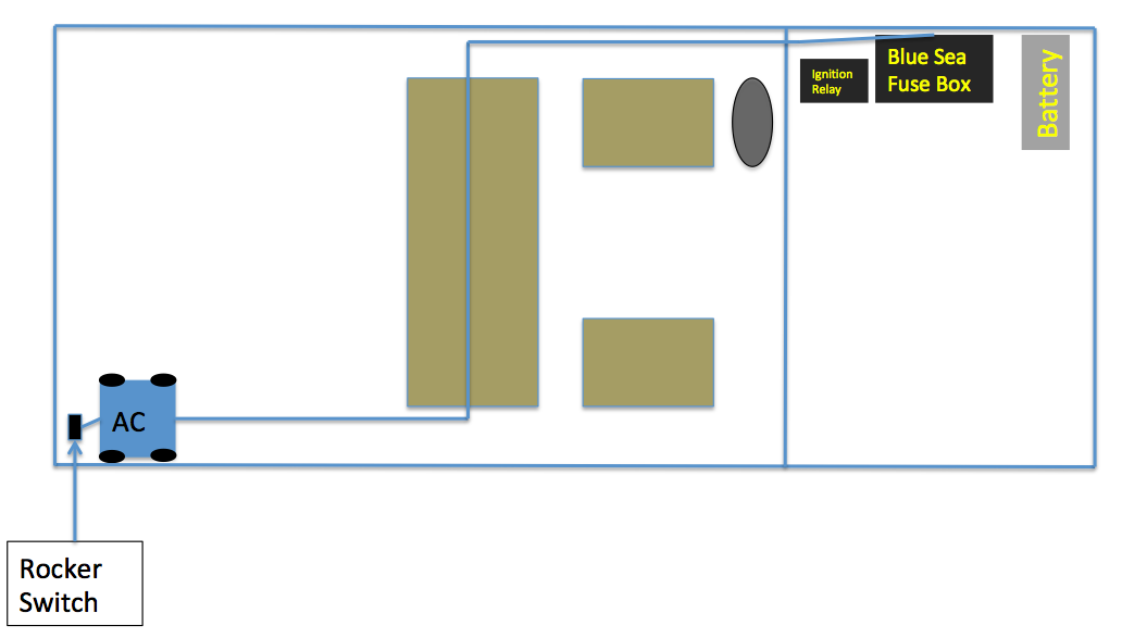

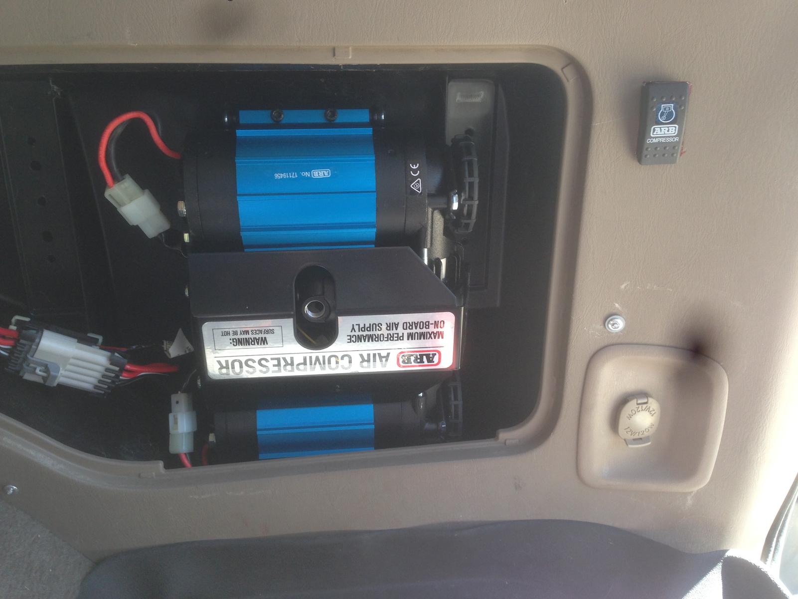

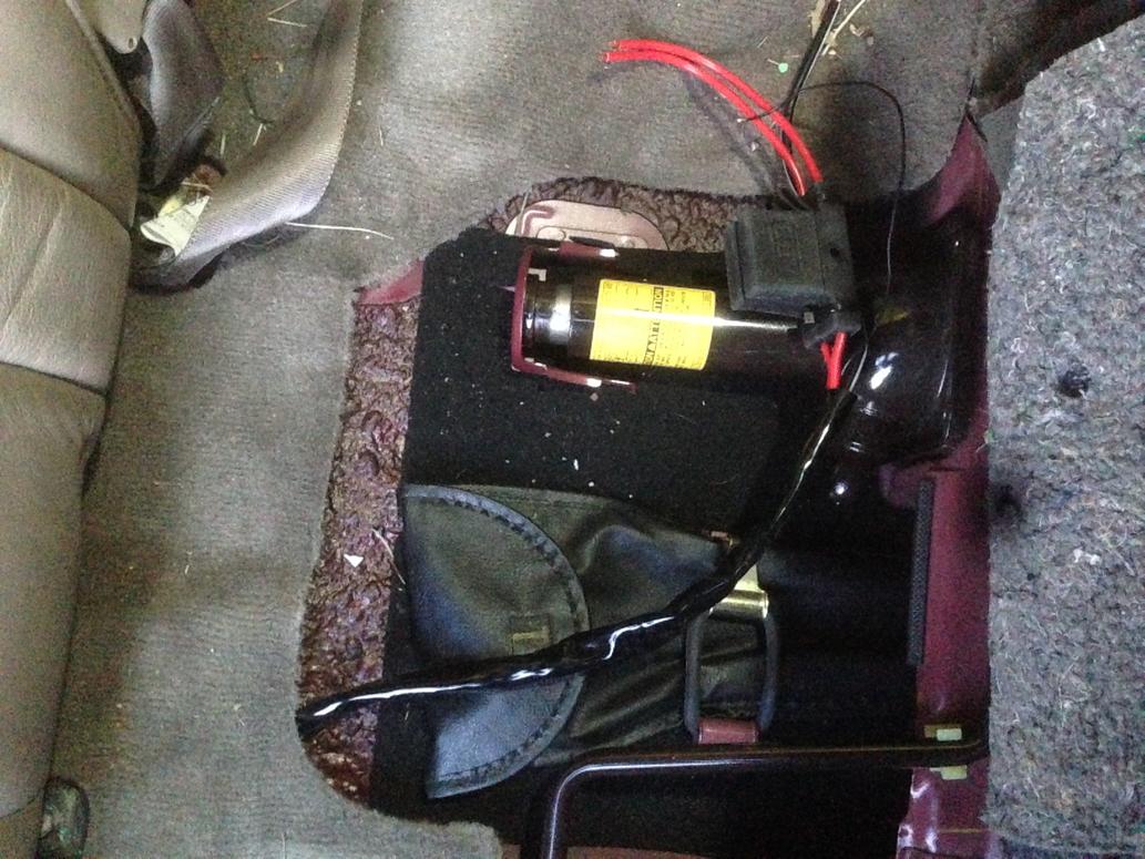

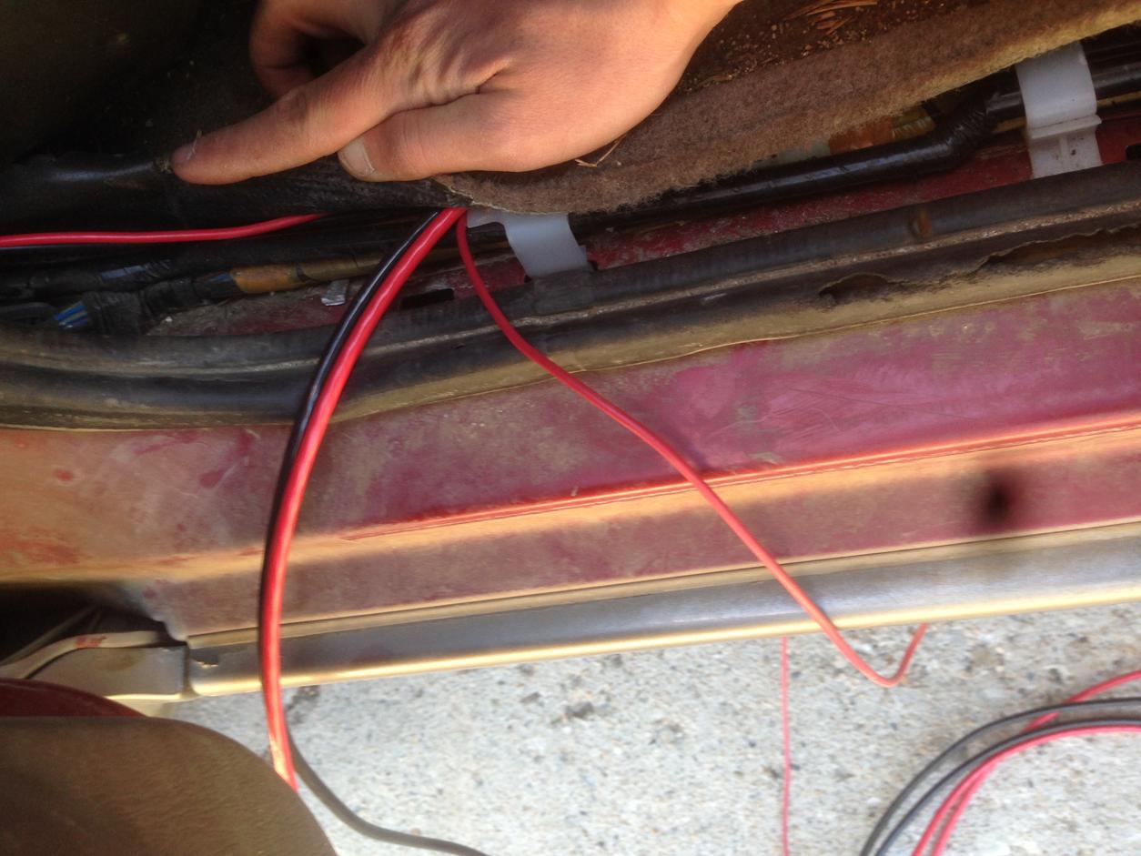

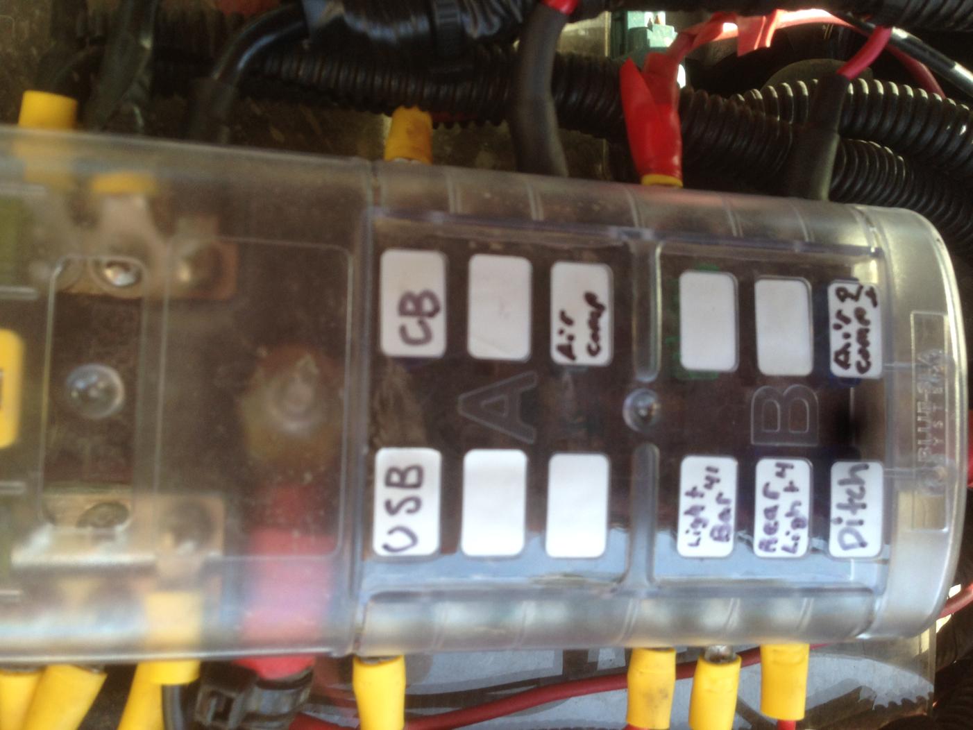

Well I finally finished the ARB compressor install. I routed it from the rear passanger side storage, under the back seats, through the firewall and to the fuse box. Pain in the neck... Heres what I pretty much did.
Here's some photos of my big 3 setup.
Special thanks to [MENTION=57546]4-Ripcord[/MENTION] for the layout and instructions. The real MVP.

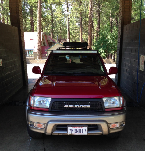

Here's some photos of the grill replacement. I got the grill from srqfabrications in a group buy on here.
I wired the raptor lights to my parking lights so once my parking lights are on then so are the raptor lights.
Here's some photos of my 42inch light bar install. Got the light bar mount from slag factory and the light bar from mic tuning on Amazon.
