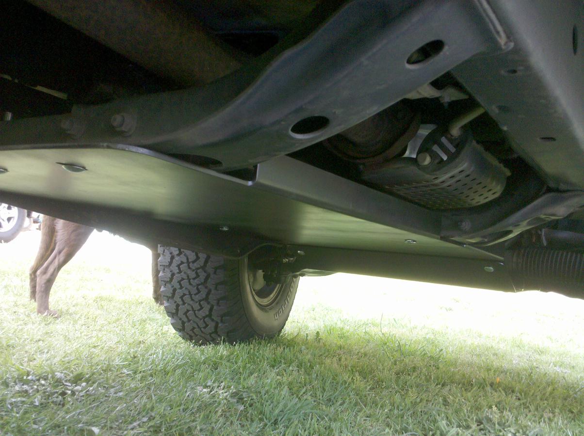

Try putting on a belly plate like the one from Budbuilt...it protects the cat from damage off road, but at the same time I'll bet it would deter any thief from taking the extra time to get to the cat to steal it...
