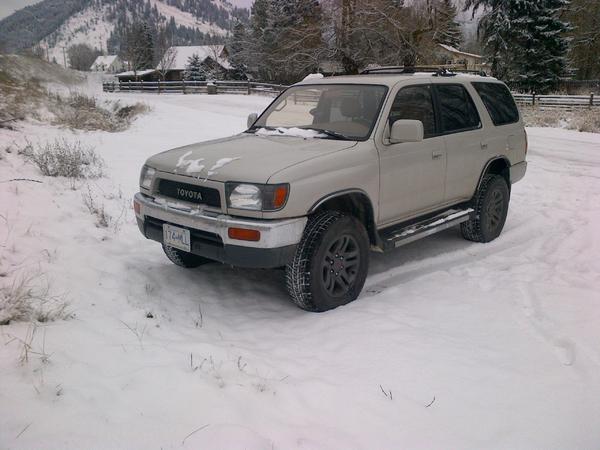

We've had a ton of snow! I love driving this truck in the snow! I'm now at 32K KM since replacement. Lovin' it! Merry Christmas everyone!!

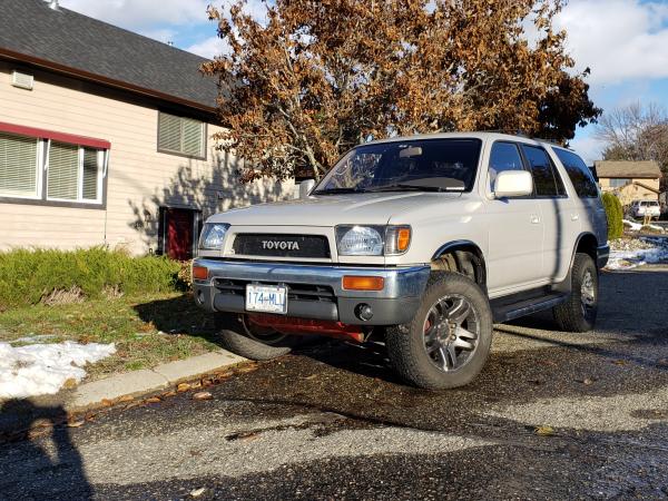

Here she is as of a 3 weeks ago:

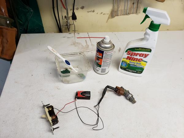

I had a bit of a struggle with a misfire issue this last Summer, but visited the pick N pull and acquired a set of injectors. Picked up some spare rubber seals from the crawlspace, Spray Nine and MAF cleaner. Scavenged through my 4R bucket of stuff and pulled out a connector, added a 9v battery--- viola, an injector rejuvenator! I cleaned them up well, connected the battery and soaked them in cleaner, then sprayed MAF cleaner through them. I then removed the intake, and did an ohms check of all the injectors and discovered one dead injector and another out of spec. It's back to perfection again! My investment: $15 for cleaners, $20 for P N' P injectors-- bits and bobs free. (I had spare rubber seals from the engine replacement in 14') Not bad for a Saturday afternoon!

Fuel injector rejuvenator
As mentioned, I discovered the route of the problem. Visited the Pick N' Pull and acquired a set of fuel injectors and gave them a clean! Here is my setup:
She is purring again.... a successful Saturday afternoon.
