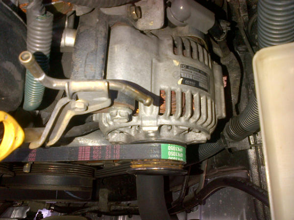

Got stuck last night with my boat in the water and my truck with trailer dead! Just the dreaded "click" Battery was dead! This happened to me once before the swap but I figured I solved it as I changed the alt brushes---the original ones were worn out. I tied up the boat, ran home, grabbed some jumper cables, jumped it and was back home in no time-- good thing I wasn't farther afield! Anyways, I drove the truck around for a bit and parked---- wouldn't restart. ALT! I decided to drop the JDM alt in, as we have a holiday weekend of boating to enjoy! Works great now!
Still running great with the JDM ALT!
Well, after swapping my Alternator with the JDM, its still working great! I thought about changing the pulley, but the shaft on the Alt's are different sizes. Doesn't really matter as the belt fits fine. I'm just going to let it run!
