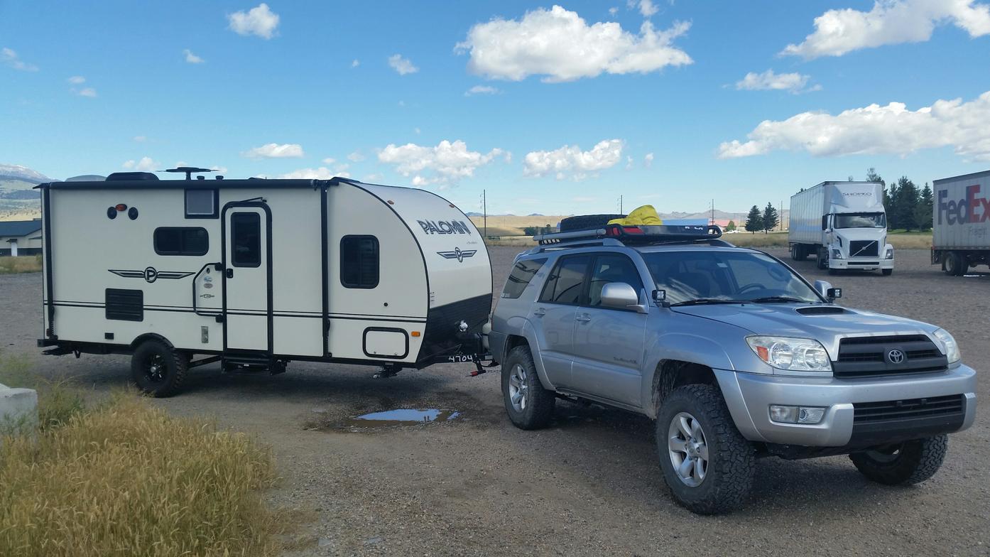

My experience towing a travel trailer 4,000 miles wtih a mildly built T4R
alpinhi
So the reason I sold my Jeep Rubicon was to be able to pull a camper and still hit the trails when we got to our destination. I decided to go with a V8 T4R over a Grand Cherokee for a number of reasons. They both had their pluses and minuses but that's a story for some other time.
We purchased a 2015 Palomino Palomini travel trailer with the offroad package because we were tired of making reservations a year in advance for a cabin and be tied to one spot. The camper is 22 ft long and weighs almost 4k loaded down. This year we traveled thru 10 states (some just partially). We started from home in eastern KS and traveled up thru Badlands National Park, Yellowstone, Glacier, and then thru Dinosaur National Monument on our way home.
The T4R- 2005 V8, stock trans cooler, Toytec 3/2 spacer lift, 275-70-17 BFG AT'2, Rola Rack with the spare, 4gal Rotopax, and some of my fishing gear mounted up top. I did the secondary air filter removal and added an AFE dry air cleaner. I also added headrest DVD players for the kiddos and Pioneer 4100 nex head unit for me. We use the Anderson weight distribution and sway control hitch.
The Camper- 2015 Palomino Palomini Offroad. 7ft wide (still had good visibility with stock mirrors) 22 foot long single axle, 26.5 gallon fresh water tank, and 30 gallon grey and black. I believe the camper weighs 2900 empty and has a GVWR of 3950 lbs.
The camper pulled much better than I expected. We had never gone this far before with the camper fully loaded down. There were some struggles along the way but all in all I am very pleased. I learned that the 4R needs a bigger fuel tank from our annual trip to Colorado last year. I kept the the trans in 4th gear for 99% of the trip. At 70 mph I was turning about 2700 rpm and trans temps were in the 180-200 range for most of the trip. I kept track of the trans temp and a few other gauges using the Torque App on my phone. I dont like relying on idiot lights (especially the trans temp) so I wanted to monitor it and make changes in my driving ahead of time if needed. We went over many mountain passes this trip. The highest and longest was Loveland Pass on I-70 thru Colorado. The summit was over 10k and it was 7 miles to the top. The 4R handled it well with trans temp around 200 to 225 at times. I was able to run at 45 mph in second gear all the way to the top at around 3800 rpm. I was constantly being passed by vehicles not towing but I was blowing by semi's and some other campers. In the flat areas with light wind the 4R wanted to run faster than 70 and was it was easy to speed in some places. I had enough power to pass on 2 lane highways which was really nice when coming up on a slow moving vehicle.
My fuel range was HIGHLY dependent on the conditions I was towing in and not so much the speed I was driving. The wind was the biggest killer of my mpg's. We had a run south thru Idaho where the wind was blowing 35 to 40 mph ditrectly into us. I had 85 miles on the odometer and was at a 1/2 tank fuel thru here, the 4R was struggling to maintain 65 mph and my trans temp was around 250 degrees. I managed to suck in behind a built Dodge Cummings dragging a large 5th wheel at 67 mph. My trans cooled way down and my mpgs went up after that. Fortunately his destination was the same as ours and we stuck behind him from the remainder of that leg of the trip. I averaged anywhere from 5mpg at the worst to 13 mpg at the best. Normally I averaged around 10 mpg towing at around 70 mph. Our last leg of the trip we ran into the same issue with the wind except it was a 40mph crosswind with gusts up to 50 mph while traveling across western KS. I tried sucking behind other campers and semi's but everyone towing was struggling and the relief was minimal at best since it was a crosswind. We just had to deal with it. I had a 4 gal Rotopax on the roof of the 4R and 5 gallon Jerry can on the rear bumper of the camper just in case.
Fortunately we never had to fill from the cans. I had my wife start scouting out fuel stations when we hit 1/2 tank and I was actively looking for one when I hit a 1/4 tank.
I n order to help the 4R out we used the Anderson load equalizing and sway system along with a Tekonsha P3 brake controller. I love the brake controller, it will tell me if there is an issue with the brakes and give me an idea of where to start looking. It has 3 boost settings for towing in the mountains, traffic and flat roads. It helped us slow down nicely and I never like the camper was pushing us when it was set properly. The load equalizing was a different story. It works well and does its job but our first night we slept thru a heck of a storm in SD. The next morning when we left the hitch would creak so loudly that it made people outside jump and kids run to their parents but it still functioned fine. I contacted the manufacturer and they put me straight thru to the service dept. I got personal cell number of a guy in the service and he said he knew what the problem was and told me how to fix it with the simple tools I brought along. He shipped the new part to campground in Yellowstone but it didnt make before we left. I ended up spraying down the hitch the night before we left with WD40 and that fixed the screeching. They are now sending me a new part to my house free of charge. The guys at Anderson stand behind their product and will take care of you.
I put this up becasue I saw some people had some of the same questions I did about towing with a 4R. I think if your going to be doing long hauls frequently especially with a modded 4R I would defiantly stay under 5k GVWR in your selection of a camper. I think if our camper was the standard 8 ft wide we would need mirror extenders and those things suck IMO. They shake so you cant see anything anyway and try to fall off. The 4R is defiantly good SUV to tow with but its no Diesel truck. Towing is not its primary design but the truck is a workhorse and will get it done. Over all im happy with it and plan to do some more mods and maybe hang on to it for awhile.

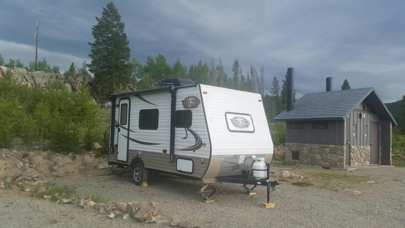

I think you shouldn't have problem if you find the right trailer. I saw lots Tacoma's towing travel trailers and even saw an FJ Cruiser towing the exact same camper we have. The Fj was from instate though and I dont think he tows as a far as we do. He didn't really know a whole lot when I talked to him, like even how the camper weighed or what the FJ was rated to pull. He did say that it towed okay and he didn't have any problems but like i said I think he just tows local.
If you want to tow long distances I would defiantly find a camper below the rated tow capacity of your 4R. It will make your travels much easier and cause less stress on you and the vehicle. I would recommend hitting up some campgrounds and talking to people when you see a camper that catches your eye. Everyone I've talked to have been super friendly and enjoy talking about their setups. Its better to hear it from them instead of a RV salesman that says "you'll be fine". The other reason is I couldn't believe how many small travel trailers were out there that we didn't see online or had never heard of. I know Starcraft is now making a a very light weight offroad travel trailer. I saw one at our last campground in Colorado. Ill throw up a pic of the Starcraft and of one called a Viking that we liked alot also. Checkout the RPod campers also, I know they are very light and easy to pull and we saw lots of them pulled by all sorts vehicles (including a few Rubicons). Their downfall for us was they only offered a wet bath. My wife wanted an actual small tub to bathe the kiddos after a day of playing outside so the wet bathe was no bueno for us. Good luck in your search hope this helps!

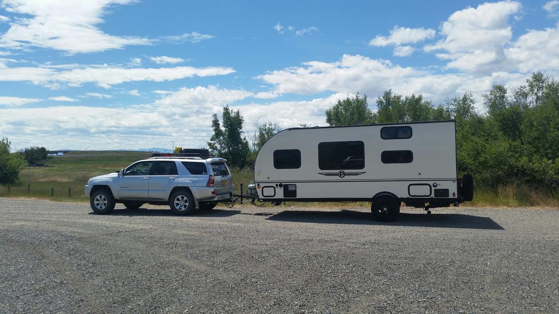

I've got a 19' fiberglass trailer (Escape 19') and a mildly built 4Runner as well (see here). It's worked out pretty well so far. The trailer is probably ~3200 lbs fully loaded. My 4Runner has a small lift, with 285/70R17 Cooper ATP e-rated tires. I get 10-13 mpg, depending on conditions.
I've griped about the mirror situation. I use the Grand Aero mirrors. I tried the tow-n-see stick ons; while they do work ok, they aren't the best under less than ideal situations. I had one flop off during a rain storm. Vibrated more than I would have liked, and beaded water on them as well. I was planning on trying the bolt on Tacoma towing mirrors, but the Taco mirrors fit the door much different than the 4Runner's unfortunately.
One thing I've found with my combination is that it's not worth trying to leave it in OD (5th). I'm best putting it in drive and forgetting it. The lugging of the engine gets worse gas mileage than the higher RPM I hit when in 4th, and it's fewer transmission shifts as well.
I just got back from a 3 week 6300 mile trip (Chicago - Glacier - Osoyoos -Vancouver - Seattle - Portland - Bend) and had a great time. I hit a deer out in Oregon prompting a new bumper. I'm headed out the door this morning for a week up in Michigan (UP).

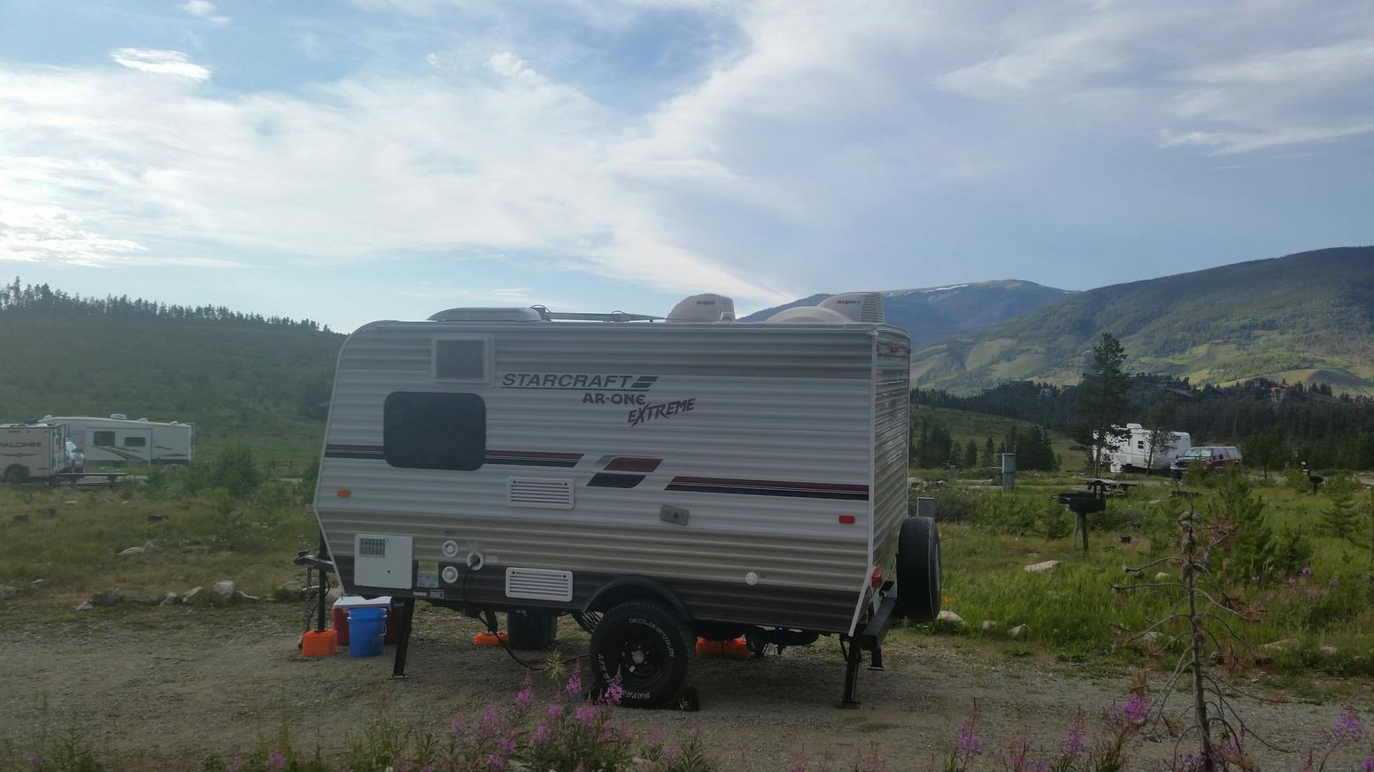

My Starcraft AR-ONE RB14 Extreme weights in at about 2400 lbs, about 2850 gross give I believe, has a full dry bath with a tub but no sink, fits my wife, dog, and me fine, has a sealed belly pan and pulls great. Only has a 9 gallon black tank though. I think the grey is. 16 and fresh about 21.
I'm of impression weight equalizing hitches and rough roads don't mix too well being especially hard on the tow vehicle. Have I been lead wrong? Things are pretty good in cross winds, mountain conditions without it though. And we have plenty of those here abouts.
Oh, yeah my 04 V8 averages about 12 pulling it. Up the mountain sucks but down the mountain tends to balance that out. Head winds though take a huge hit in mileage. I've dropped down to about 5mpg on the meter refreshed (which means 3mpg in reality?) into a stiff head/cross wind going from about 8,600' to about 10,000 over about 30 miles into a stiff head/cross wind (south of Harsel to just North of FairPlay, for those who know the area) Made most of it back and wound up getting a combined mpg of about 11mpg ,hand calculated, on that 200 mile leg.
