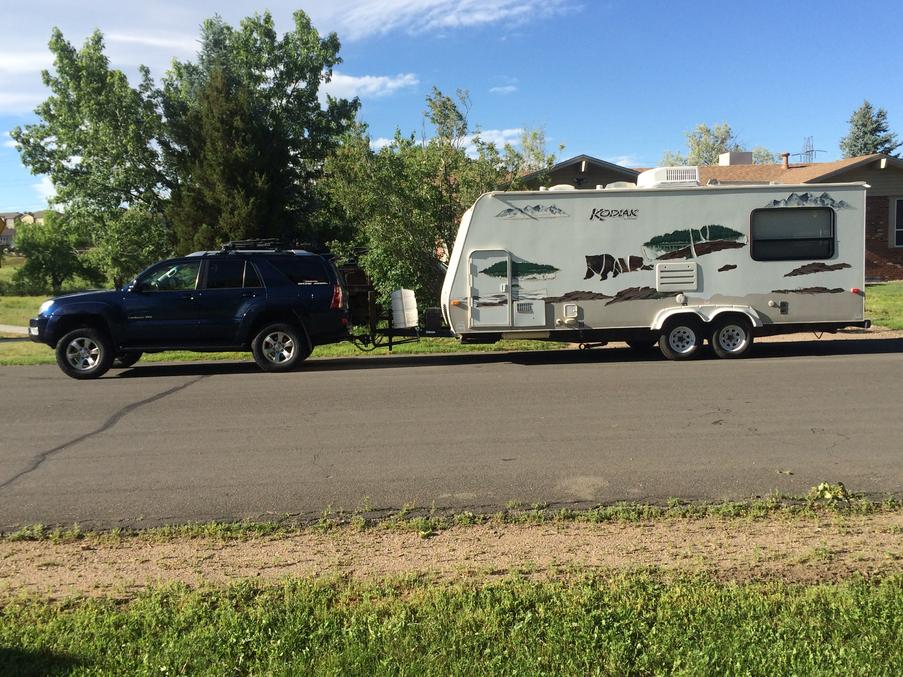

Great info and nice work. I'm pulling a 4000 lb, 25'' long, 8' wide Kodiak with my 2004 V-8. It does have the small tranny rad (no separate temp gauge), but I have not seen the engine temp go beyond the "high" end of the in range temp markings. I'm able to keep at 45-50 over Vail Pass and heading up towards the Eisenhower Tunnel in Co, but my T4R is working hard. All that aside I'm getting about 180 miles +- per tank pulling in the Colorado high country. I have a 3" lift with 265/70/17's currently and will be growing to 275/70/17's.

Great info and nice work. I'm pulling a 4000 lb, 25'' long, 8' wide Kodiak with my 2004 V-8. It doesn't have an extra tranny rad so I am relying on the main rad to do the work. I have seen the temp gauge go up to the "high" end of the in range temp markings, but no further. I'm able to keep at 45-50 over Vail Pass and heading up towards the Eisenhower Tunnel in Co, but my T4R is working hard. All that aside I'm getting about 180 miles +- per tank pulling in the Colorado high country. I have a 3" lift with 265/70/17's currently and will be growing to 275/70/17's.

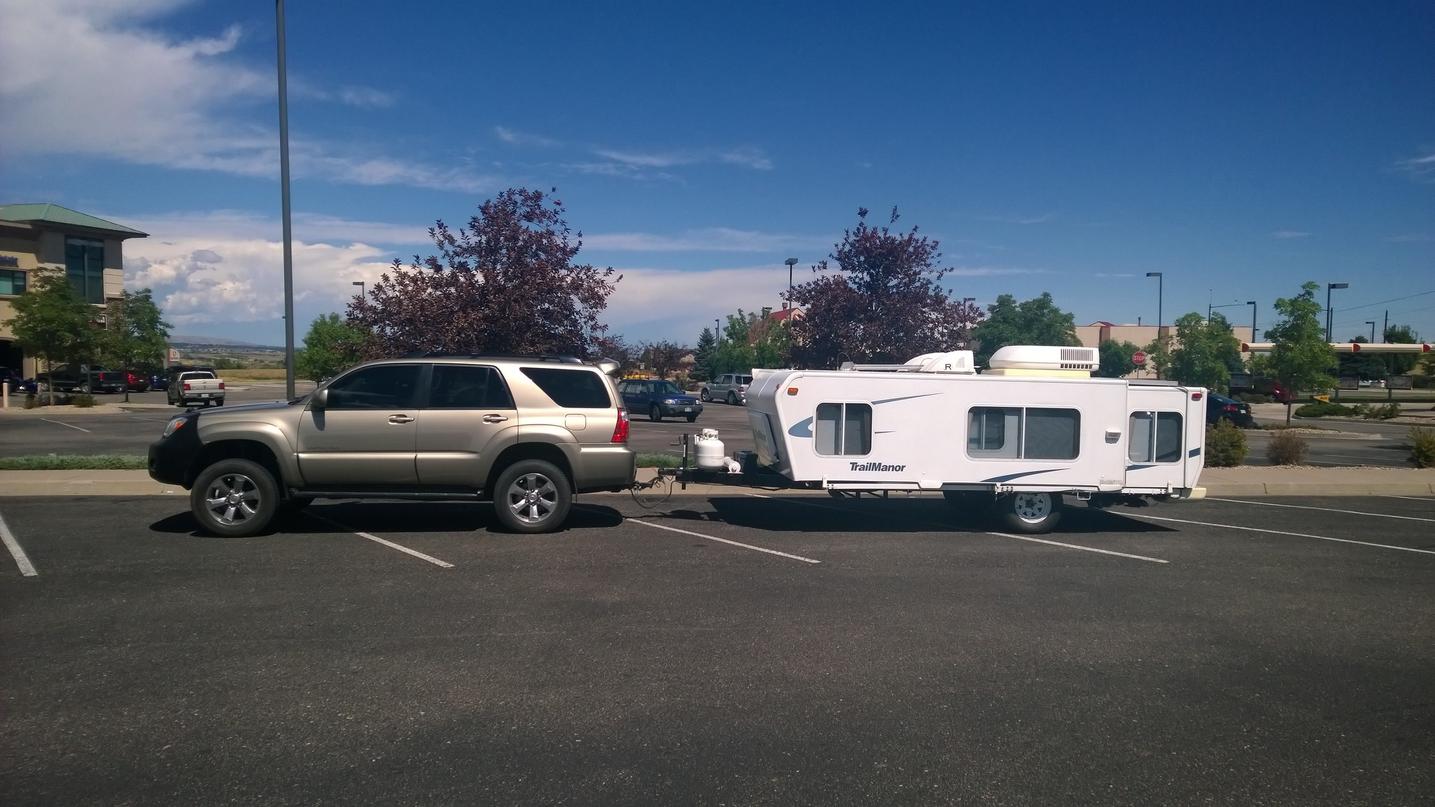

Well, goodbye Kodiak 172E hybrid trailer. Nobody liked the canvas foldouts. Too cold at night, too hot napping in the daytime. Short 19' tow length, 26' expanded, nice 52 gallon fresh water tank.
But along comes a 2008 Trailmanor 2619. We'd been looking at them as a better option. Not as good in some ways, better in others.
- Hardsided when expanded (big upside)
- 19' tow length, 26' expanded (wash)
- 40 gallon fresh tank, which is a factory option, 20g is standard (good enough)
- 30 gray, recirculating toilet, (downside)
- Fridge/freezer is half the size (downside)
- Dry weight is about the same, cargo capacity the same, GVWR the same (wash)
- Kodiak 8' wide, Trailmanor 7.7' wide (wash)
- Trailmanor low-profile, towability better (upside)
- Trailmanor no passthrough storage (downside)
- Trailmanor has big windows and a lot of them, 172E tentends have windows (wash)
- Trailmanor enclosed and insulated underbelly, 172E the same (wash)
- Stove, cabinets, wardrobe, shower, furnace, AC, water heater are a wash
- Trailmanor has factory solar (upside)
- Two 20lb LP tanks, dual batteries (wash)
- Trailmanor torsion suspension, 172E leafsprings
- 4WD road offroadability probably a wash, same ground clearance to the vitals. The 172E could handle some pretty stiff Four Corner states offroading.
The big deal is sleeping comfort.
The truck squats some in that pic, that was with 10psi in the airbags, probably have to go up to 20psi. That's fine. That's a heavy tongue weight trailer, and about 3200 dry weight. Trailer GVWR is 4190lbs per the sticker on the trailer.

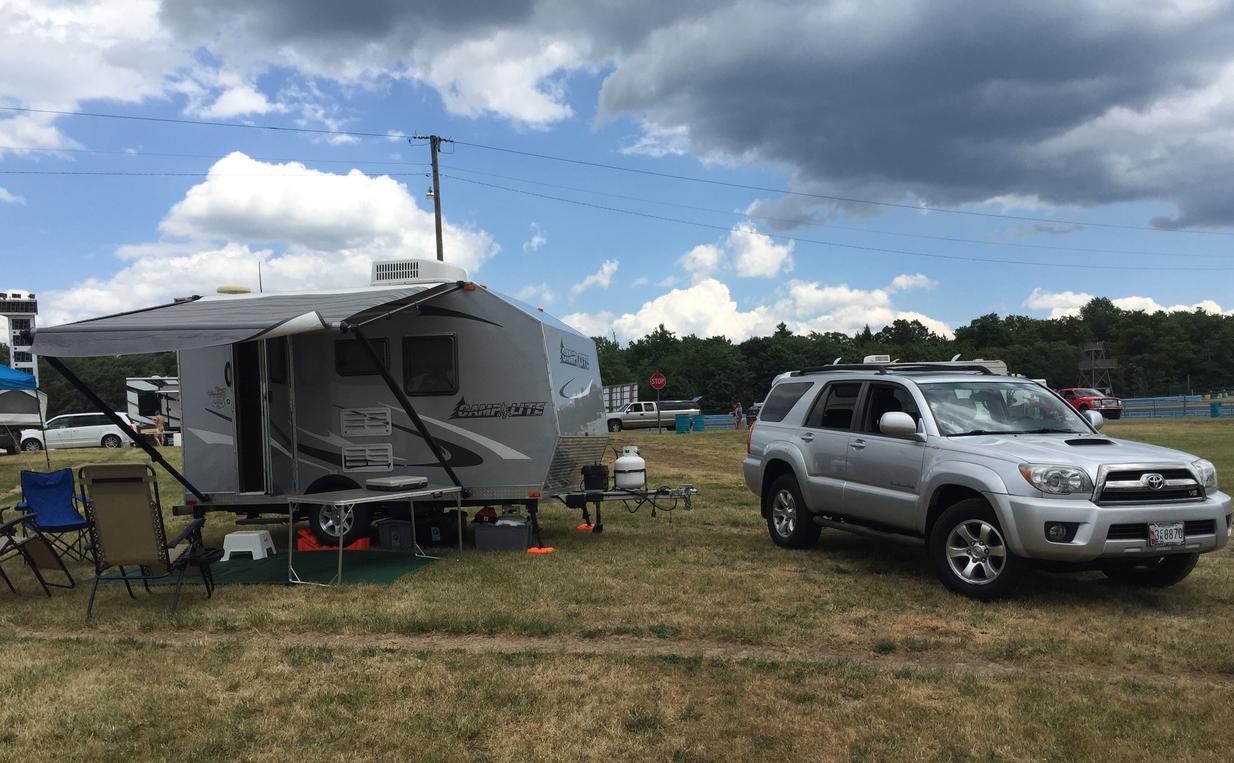

Some nice camper setups in this thread, and good info too! I'm towing a Livin Lite Camplite 13QBB (16') trailer that's all aluminum and composite (no wood or fiberglass) with my '07 V8 T4R. Dry weight is about 2300, and probably close to 3,000 loaded up for a trip. It tows great, even without a WDH, and I've been averaging about 11mpg in mostly hilly interstate trips through central PA & upstate NY. No problem staying at 70mph up steep grades, although I try to stay around 65mph. I was using my 3rd gen T4R (V6 5-speed) to tow this camper previously, and while the V8 is a nice upgrade, I'm still impressed at how well the 3rd gen did.
