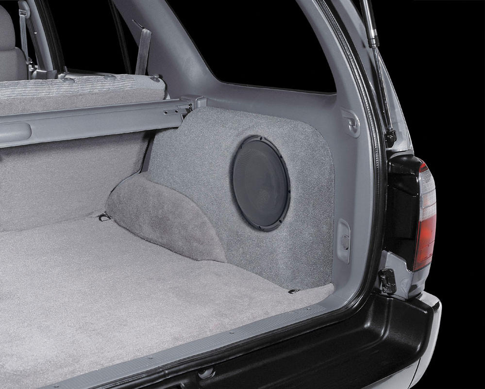

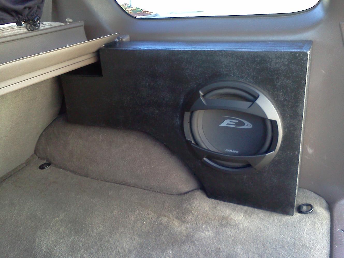

$599 for a JL Audio Stealthbox??? I decided that I loved the look and space saving idea but I couldn't justify that much $ for a box. So I figured why not build one. Total cost $120! 1/2 " sheet of MDF $40, Alpine 1043 10" sub $65, speaker terminal $5, and $10 in glue, screws, and polyfil. I was fortunate to have my amp already which puts 150 watts out and it sounds AWESOME. The airspace required for a sealed box with this sub is .75 cu/ft - 1.5 cu/ft. Mine clocks in at .79 cu/ft. Drilled a hole through the box and wheel well for a 6" nut/bolt/lock washer setup so its nice and secure. Thinking about tan carpet but haven't decided yet because its covered by the cargo cover anyway. Ok maybe its not as "pretty" as the stealthbox, but for a $480 savings I think I can live with that... HA. Hope you guys dig it!

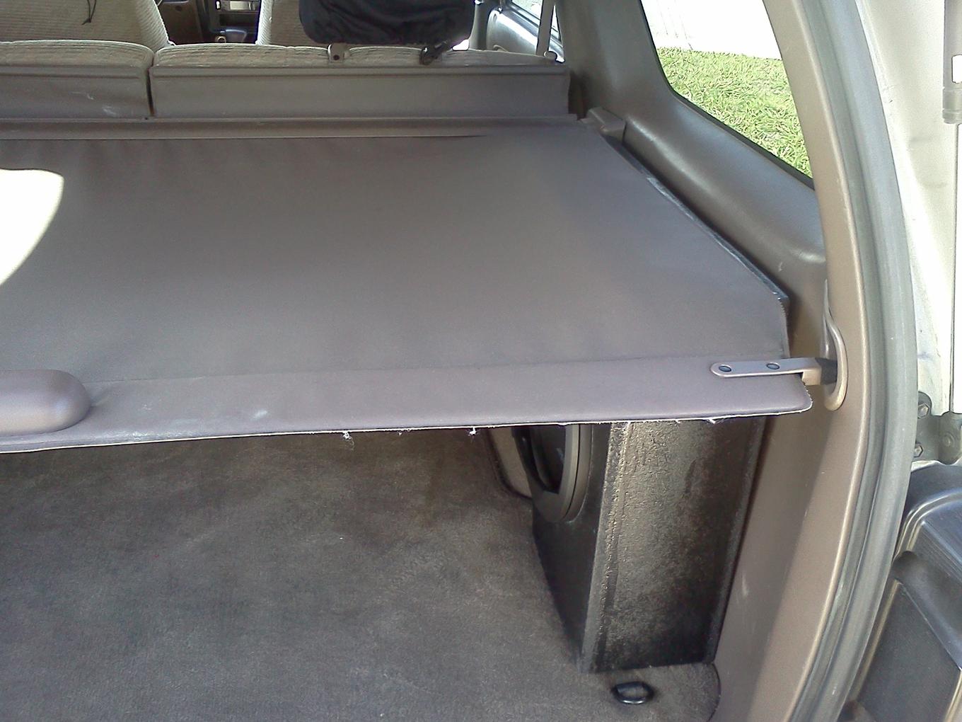

Great work, If you made that 1-2"s lower then the cargo cover looks like it would fit over it and make it more stealthy :biggrin2:
looks good I wanna eventually do something like this in mine. Now, it looks like you dont need that cargo cover....I can take it off your hands for ya :)
Actually, the cover is level with the top of the box. Pulls right over it. Kind of deceptive looking at that angle but I made sure it pulled out a couple times before the final assembly.

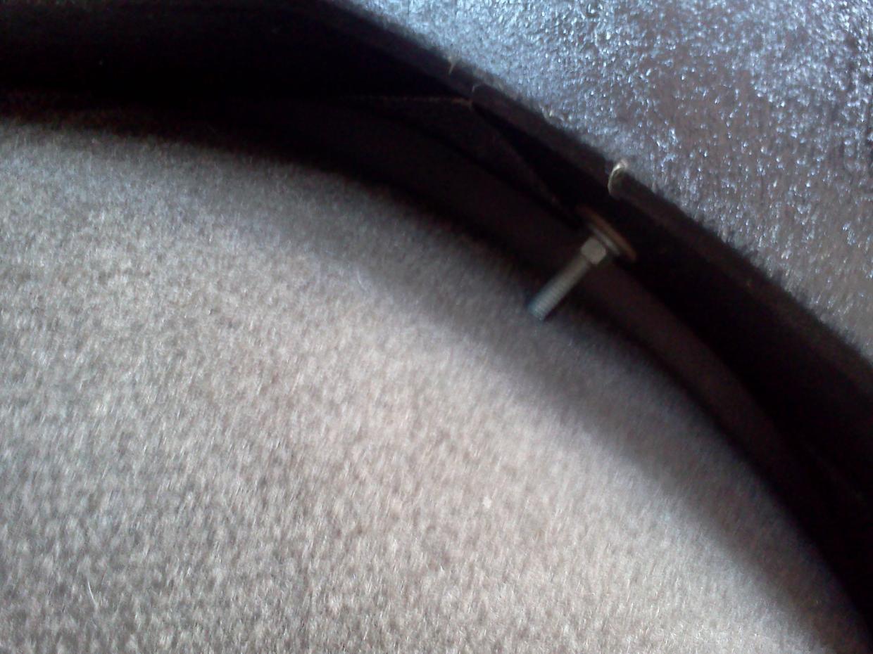

do you have a picture showing how you fastened it to the base?

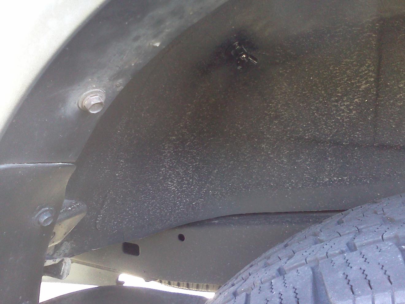

Jungos, I added pics of the process. Basically I drilled a 3/8" hole through the diagonal lower box transition all the way through the wheel well. Pushed a 5" bolt through the box then put a flat washer, lock washer and nut on the back to lock it in place on the box. Then put the whole thing through the wheel well with another flat washer, lock washer, then nut. Extra wing nut just in case. A light spray w black paint on the end in the wheel well above the tire just to hide it a bit.

The Stealthbox is nice, but not $600 nice lol. That's highway robbery.
I think the one in the cargo compartment would look 100x better if it were wrapped in vinyl. The texture of the carpet doesn't look right on a plastic interior panel.
I never thought that the Stealhbox was horribly out of line...

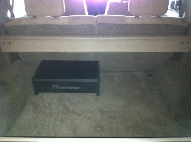

Another cheap option that is out of the way is this Pioneer enclosed set up...
TS-SWX251 - you can find one for about 100-130 online, they take 200w rms and up to 800w peak.
10" down firing sub that packs a nice punch, is low profile and you don't have to worry about throwing all your crap in the back and damaging it or also very easy to remove.

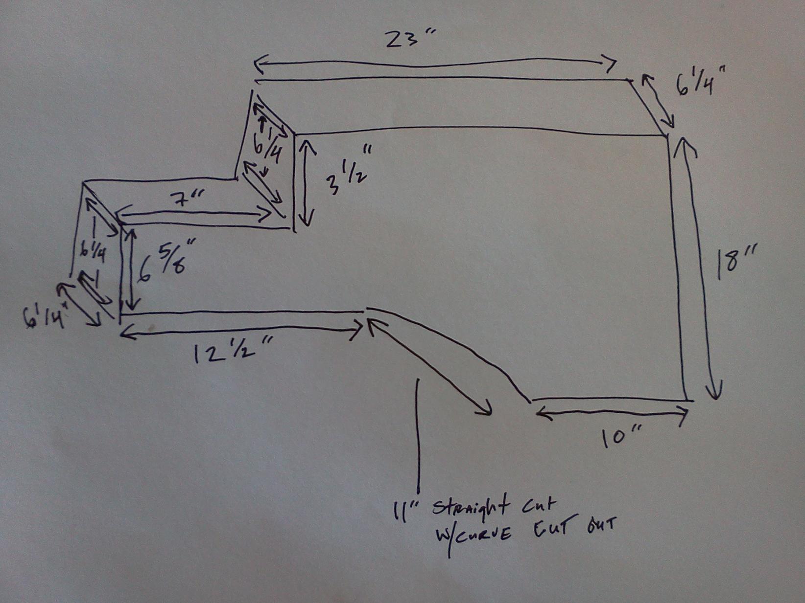

Heres a rough (and I mean rough) sketch of the dimensions for this box. Hope it helps anyone interested in creating their own.
