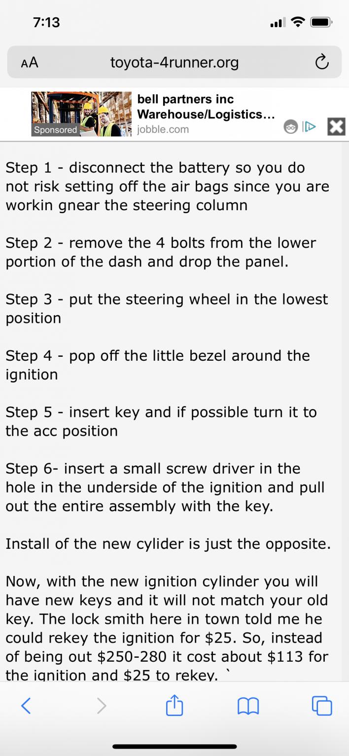

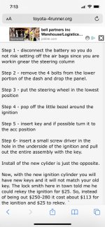

Plus most years have a complicated key core. I saved this screen shots from a good write-up on how to change your own.
