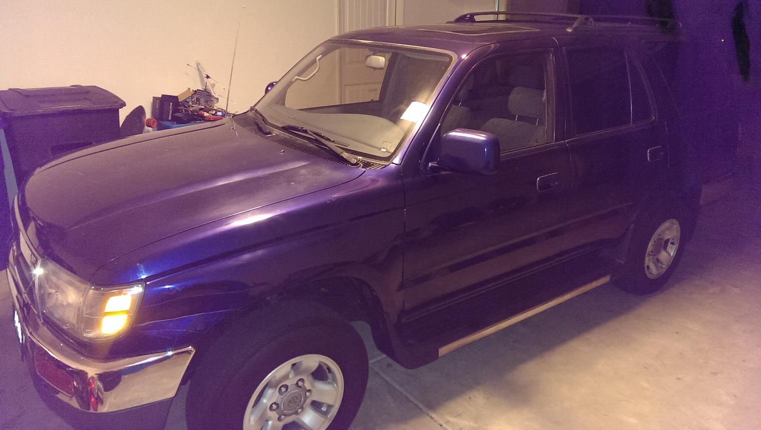

I wanted to share my (crappy) pictures of the 4runner I bought a couple weeks ago and ask a few questions that I have yet to see posted on this forum.
My 4Runner is a '97 2WD SR5 with 150k miles on it. I bought it all stock and very clean except for some cosmetic issues.
The couple of issues I've found with it seem to happen at very specific speeds. I'm hoping the fact that it only occurs at certain intervals that one of you may know a solution beyond what I'm already planning to do.
First: The truck shakes while braking, but only when decelerating between 40 and 30MPH. It does not shake at all outside of those speeds regardless of how I apply the brakes. I have already replaced both front rotors and brake pads with generic parts from O'Reilly's which did not solve the issue, even though the rotors were very scared and warped when I replaced them. I haven't touched the drums simply because I've never owned a vehicle before that had them.
Second: The truck has a very very minor vibration right around 70MPH. I'm assuming a lug-centric balance will fix this, however I wanted to add this in case anyone thinks the issues could be related.
My final question (which I scoured for through the forum to find, but never saw a definite answer) is whether or not replacing the timing belt is considered "regular" maintenance. With 150k miles on it without having the belt replaced, I'm curious if I should purchase a new one just as a precaution or if I should run it until the belt breaks.
Other than that the vehicle is running great! I'm very excited to post updates on this as I try different solutions and appreciate your responses. This is an AMAZING forum and I've had dozens of other questions answered just by searching through previous posts. You guys are awesome!
