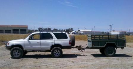

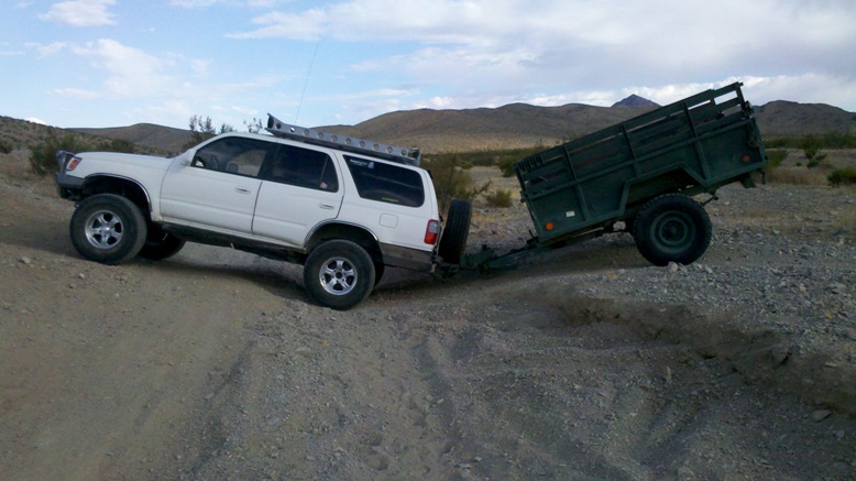

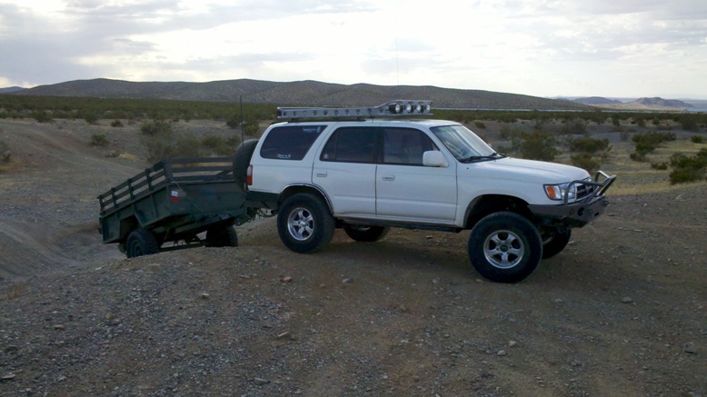

Started off with me browsing the Gov. Liquidation site that auctions off prior government/ military equipment. I found that the local site to me the prices are a little higher on average than one 100 miles further. Day before my birthday I won the auction for a M101 A2 trailer at Nellis AFB, las Vegas Nevada for $210. This is a 6x8 3/4ton trailer with hydraulic surge brakes and a lunette ring. Dry weight is 1340lbs with side rails bows and tarp. Some of these trailers require an EUC(End User Certificate) and back ground check to make sure you are able to buy former military equipment and that you are not going to sell to a foreign nation and the first time can take as much as 60 days. I had to wait just over two weeks for mine to clear and then another two weeks before I could drive to Vegas and pick it up. Here are some pictures of the recovery mission(fancy mil. way of saying I picked it up).
