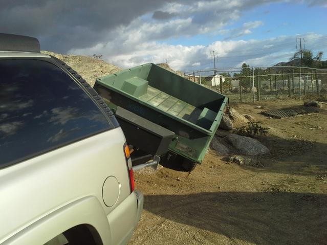

Here's a little bit of a hitch coblezation...I like the Bulldog couplers because they have much better articulation than a standard coupler, but obviously not as much as Max Coupler.
I built a "drop frame" to sit below the existing tongue/frame setup.

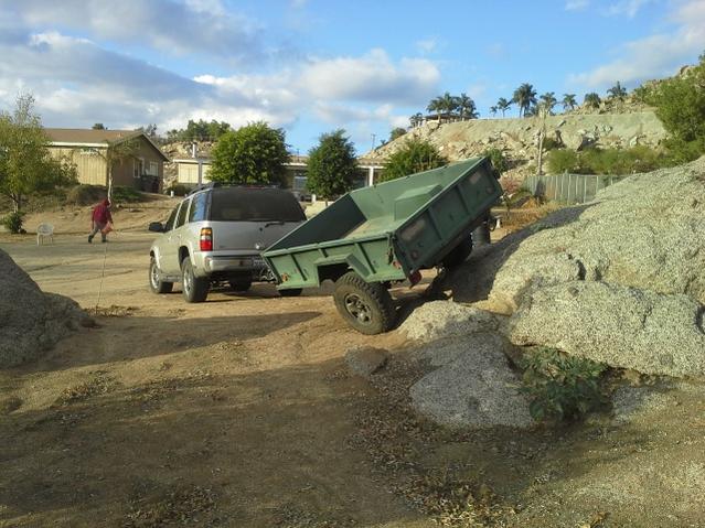

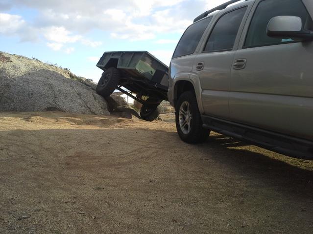

Well I finally used my trailer, unfortunately it was for a move and not a camping trip and also behind my Tahoe and not the 4 Runner. Here are a few pics from my new backyard in between trips. It is far from done but at least it finally got out of the side yard and pulled down the street. Still need to build slide out for the BBQ and a cover along with rack for an RTT. At least for now i know it is usable to throw stuff in and get out to the camp site and tows really nice.
