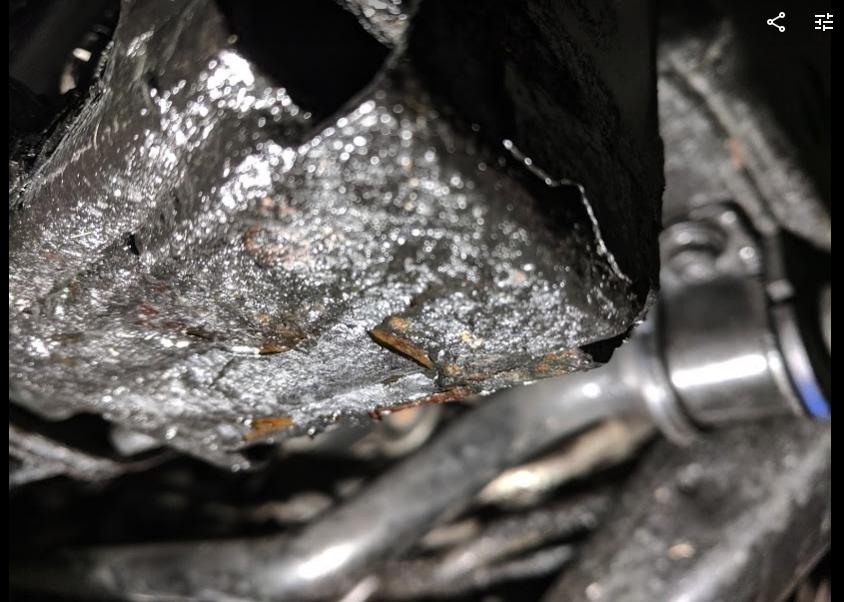

Lo and behold, I took the shroud off tonight and found a leak in nearly the exact same spot as Kmvreter (DS top corner):

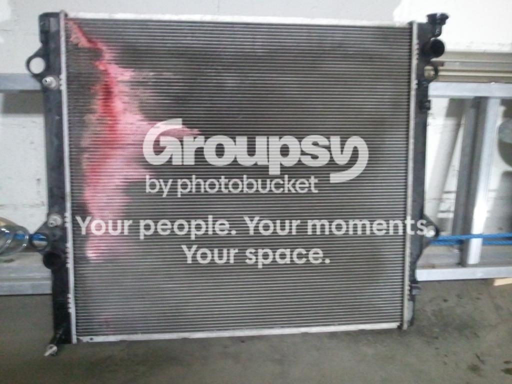

Finally had time to yank out the old radiator and install the new one last weekend. It was all pretty straight forward except getting to the coolant drain valves on the block through the wheel wells was a real b****! I put in a new Spectra Premium brand one with a lifetime warranty from Autozone, I wasn't going to spend the extra coin on an OEM one considering that is what crapped out after only 85k.
The old radiator, it failed at the DS end tank seam:

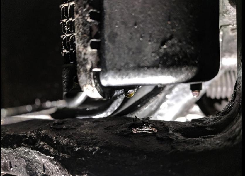

So did the pressure test and its very clear it's leaking left (driver) lower corner and at the petcock, even with the new petcock from O'Reillys. Just like everyone else. Must be a design flaw of some sort. Ordered a new radiator and downloaded the FSM for 2007 4Runner.
