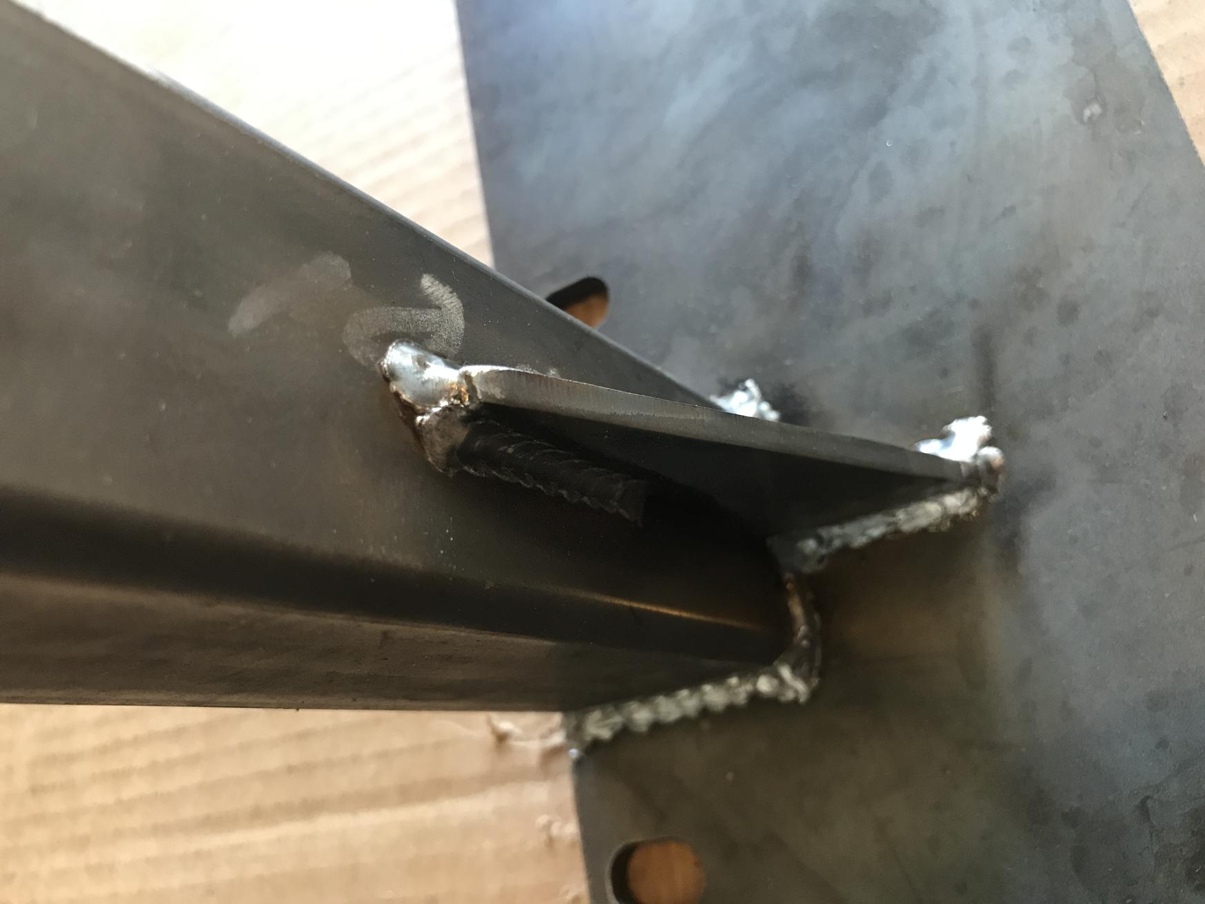

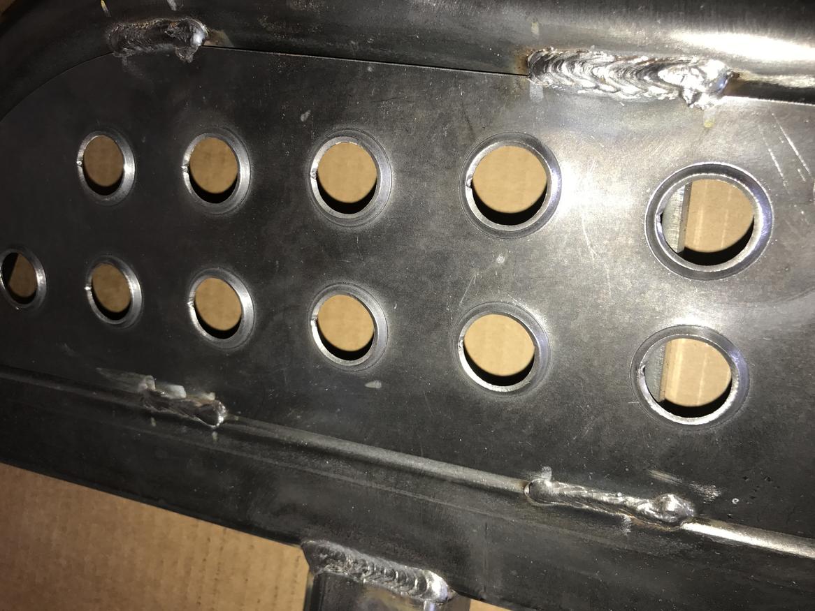

I will also add that some of the welds on my sliders don’t seem to look very clean. I am not a welder and know close to nothing about welding. But I did show the sliders to a few friends who weld. They said the welds ”Aren’t the best”, or “could be better”. I will attach a few pictures. If these welds are nothing to worry about, please disregard this portion of my review.

I'm glad you didn't feel the need to bash RCI, but instead just stated the facts. I'll agree, not the best experience.
With regards to the welds, you could tell they were done with inexperience or no expectation for good craftsmanship like they were done in a hurry. I could have welded them just as good, if not better.

Thanks for the reply. Do these welds question the durability/functionality of the sliders? Or is it merely cosmetic?
I'm not a professional welder, but my guess is no. The filler plate has missed or thin welds, but it should still hold up. The out-of focus welds on the first picture look very inconsistent like they were welding blindfolded. There is enough weld area there, though, to make up for the inconsistency. Take a look at the backside of the mounting plates to inspect the size of the blue heat-affected zone, this will give you an idea of the amount of penetration the welds have.
Shorter answer, I suppose it probably does effect the strength, but to what degree? For normal use, you will be fine.

That being said, your welds look like shit. Everything I've gotten from RCI looks way better than that.
