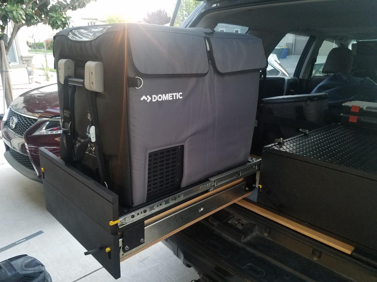

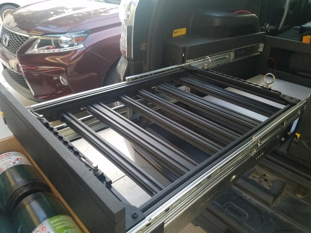

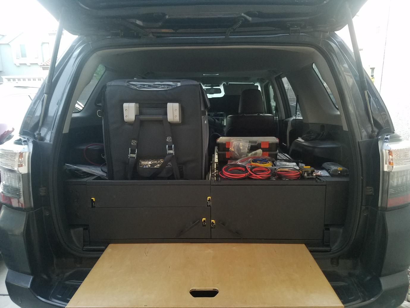

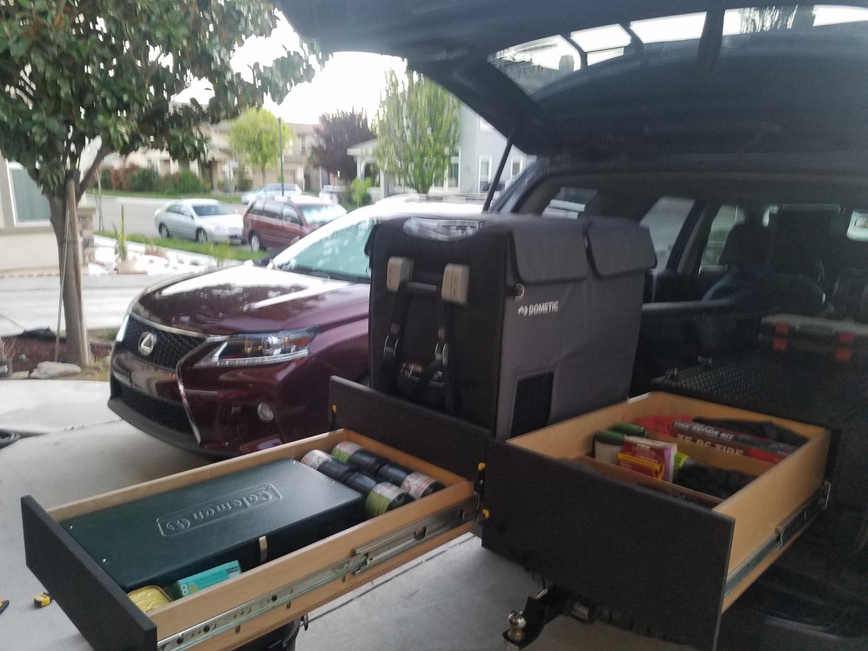

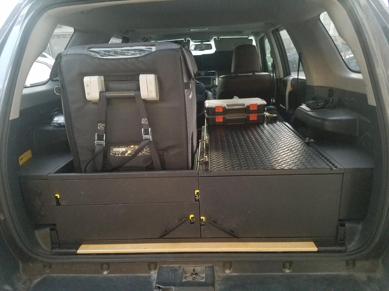

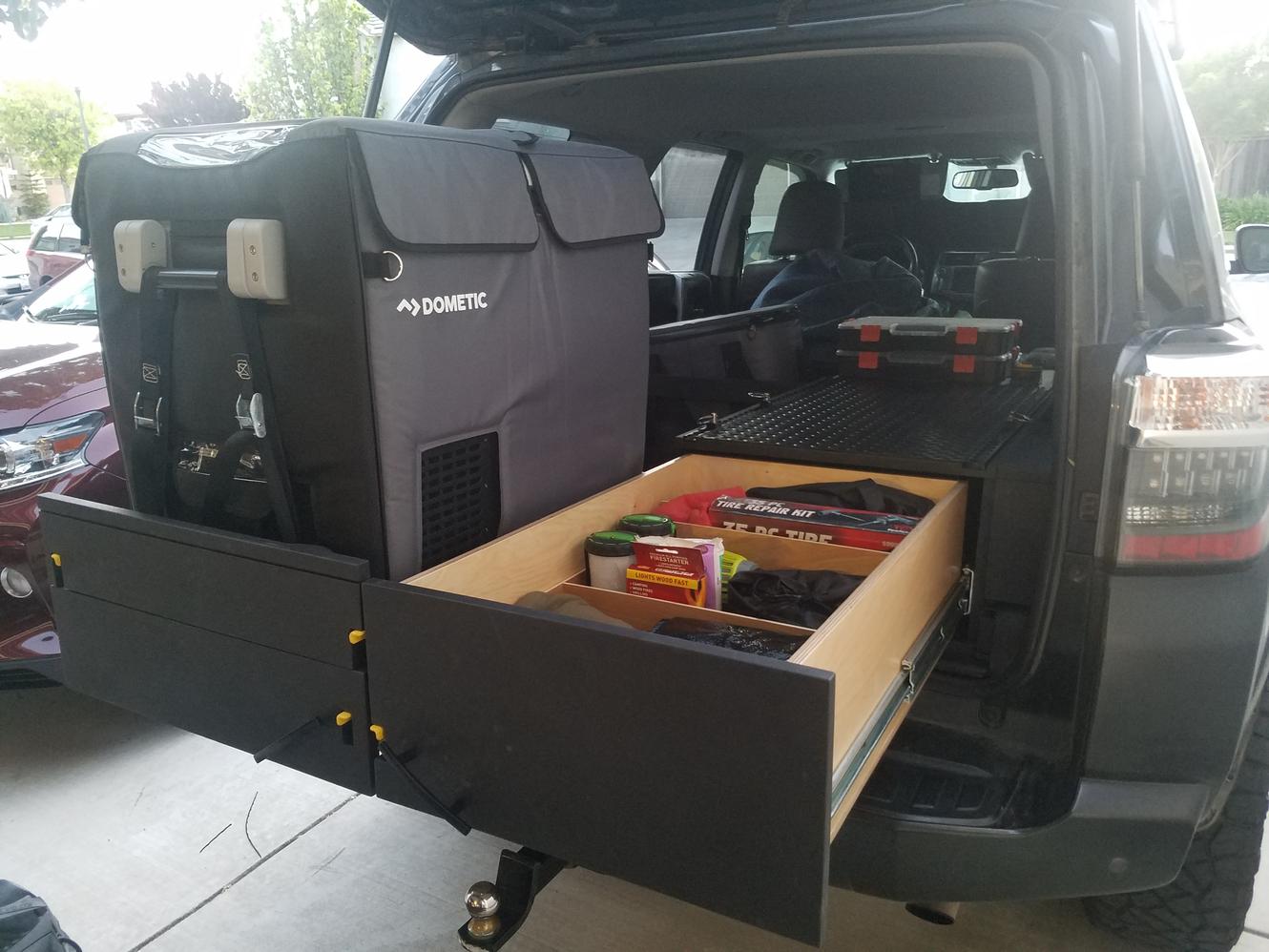

So, I've been itching to upgrade my drawers that I've build a couple of years ago. It wasn't robust to my needs and being that I have a 3rd row, it didn't leave much room for anything else. So, first thing first, the 3rd row seat has to go. I think I may have use it's like once a year. I was looking into buying one but being this is a 3rd row delete, choices were limited. Trexboxx was an option but the price is $3k and their 3rd row is still in progress. After countless days of resesearch, I decided to see if I could build a higher quality version by myself. So, the result is inspired by a combination of other's builds I found on ih8mud, Goosegear plate system, and Trekboxx. Let me say, building this was not cheap but very rewarding. My last build was pretty straight forward, everything was put together with standard plywood and wood screws. I wanted this to be more of a production build with higher quality, robust parts: Baltic Birch Plywood, 80/20 aluminum extrusions, Accuride slides, machine screws, threaded inserts, pocket holes, etc.
previous drawers: http://www.toyota-4runner.org/5th-gen-t4rs/213224-3rd-row-drawer-system-part-1-a.html
Future plans: cage and sleeping platform for solo trips

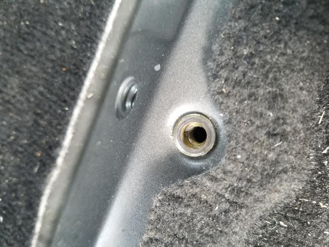

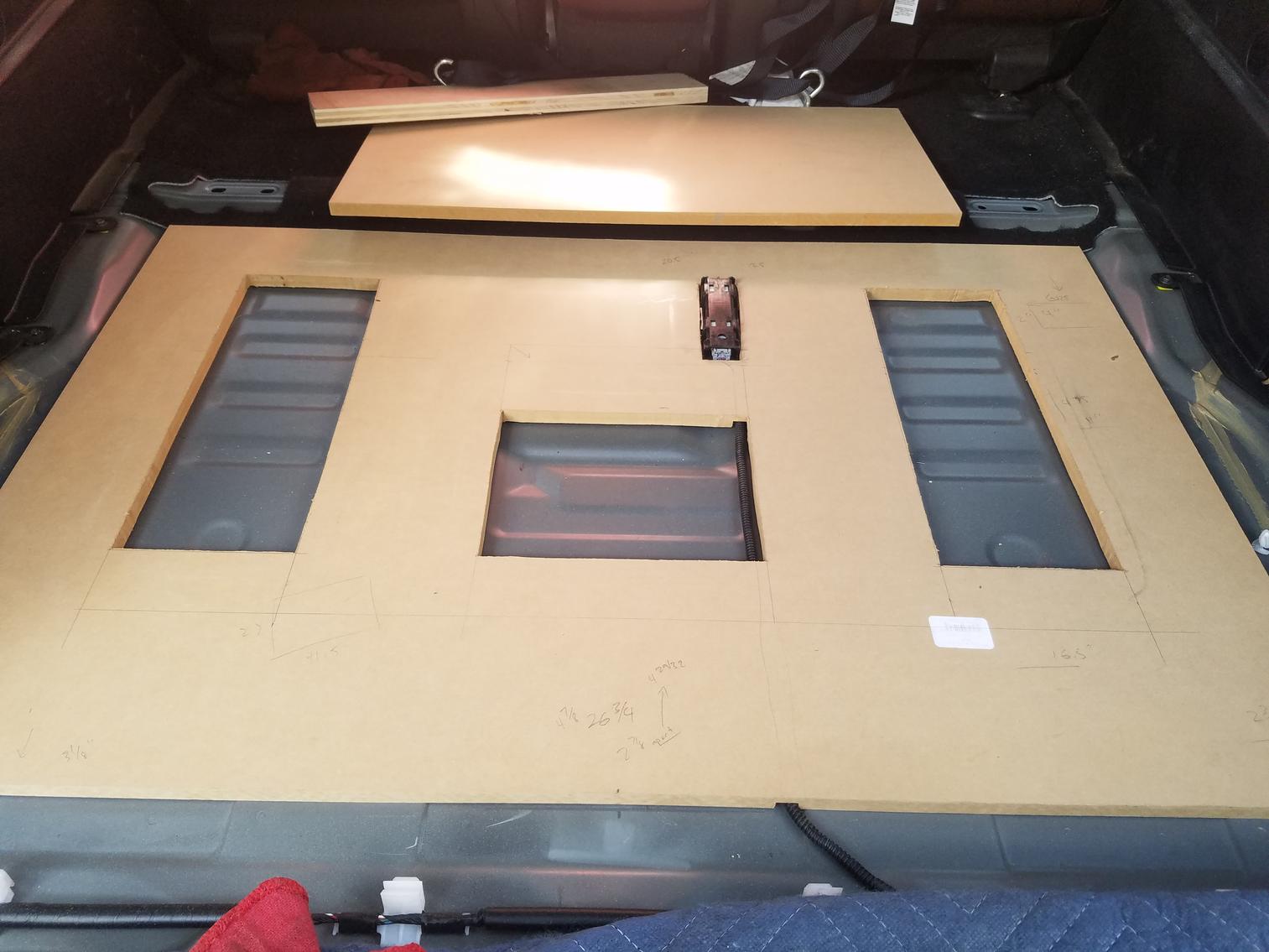

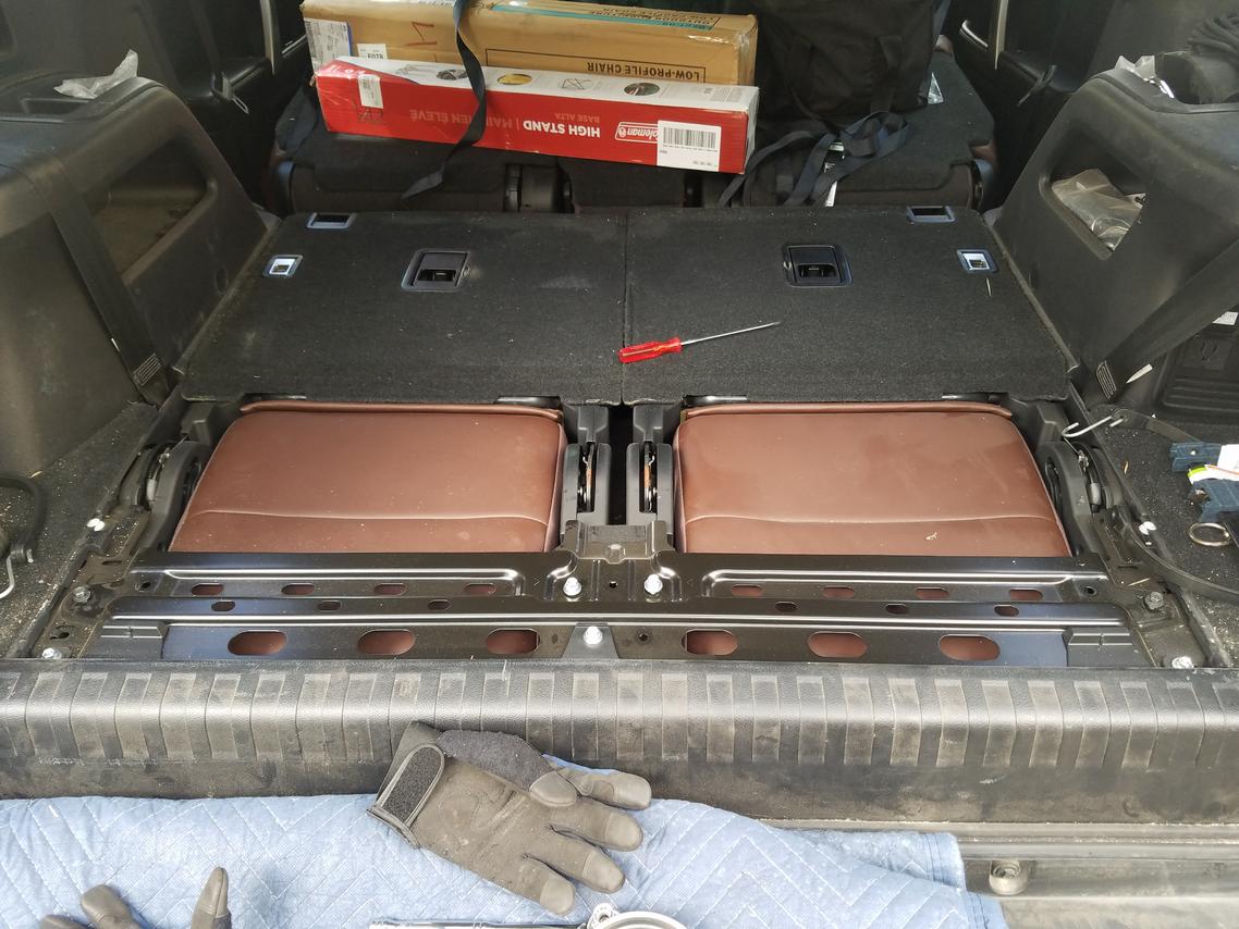

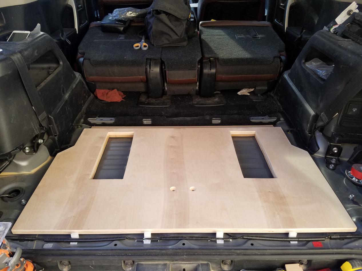

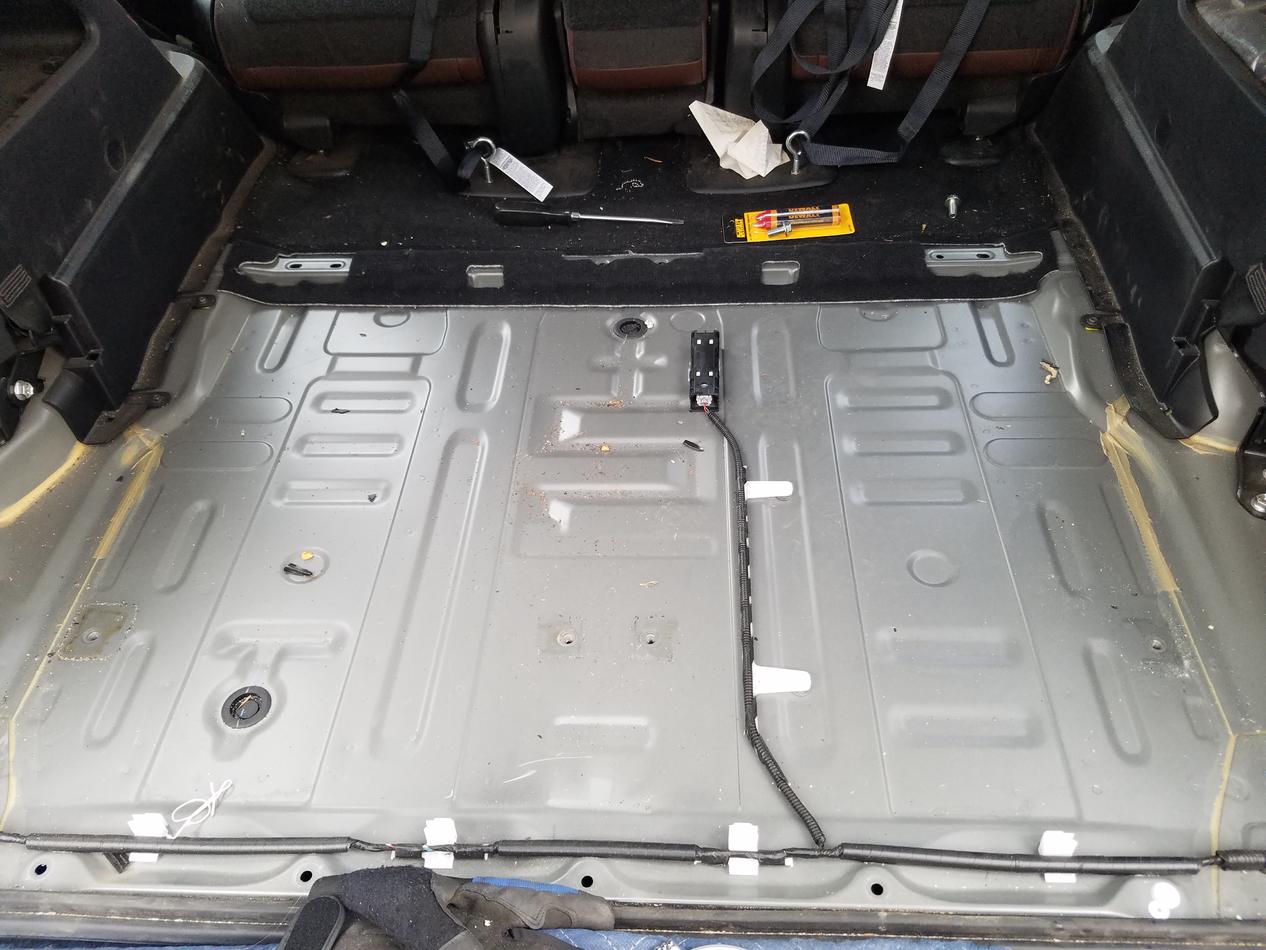

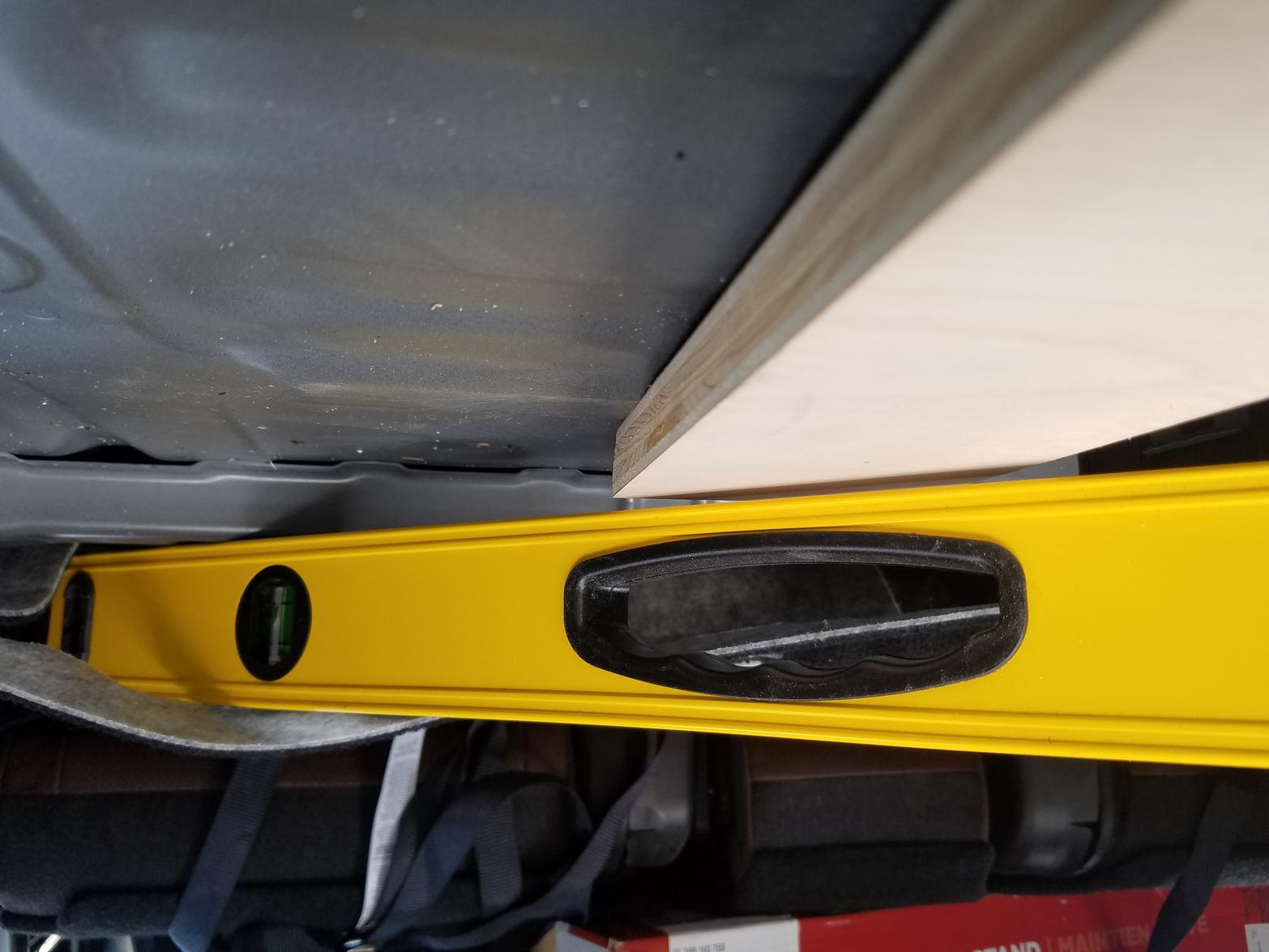

First thing first, 3rd row delete. Removal of the 3rd row was pretty straight forward. I found a "how to"video on YouTube. Those that have the 3rd will discover that you don't have to drill the sheet metal out to find all the pre existing factory holes. This made things a little easier. Still I had no clue how I was going to tackle this. All I know is, I longer wanted the 3rd row and needed the extra space. Here's the 3rd removed and the support for the platform plate system. Comprise of 2 pieces, I could have cut a few more opening to save on the weight but didn't think it was necessary. I did add a few rivets nuts to help secure the top platform.

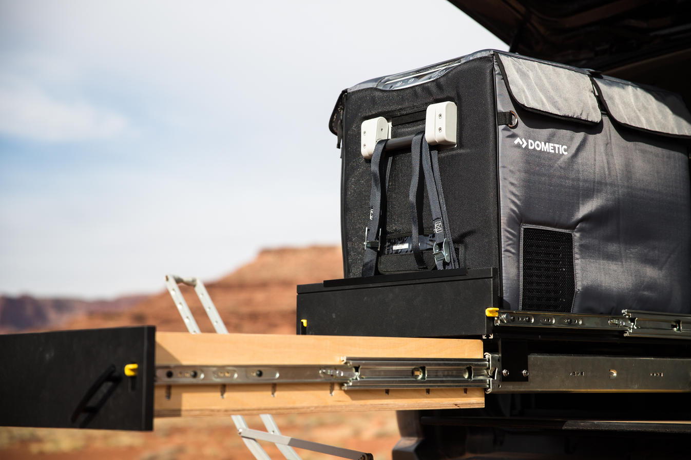

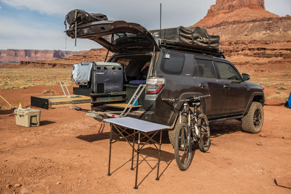

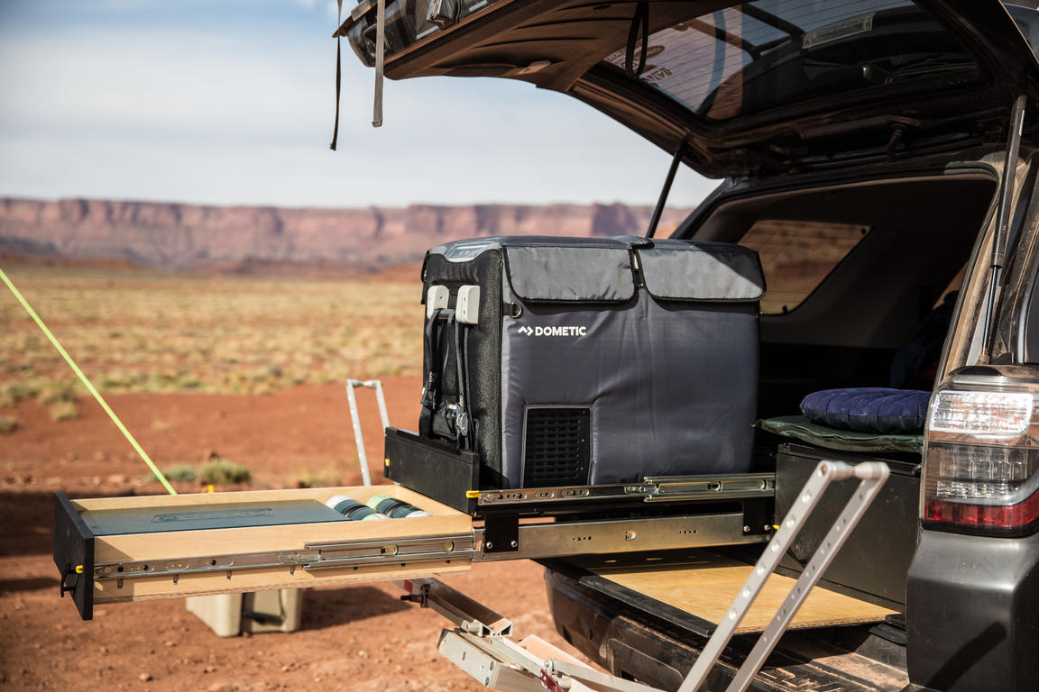

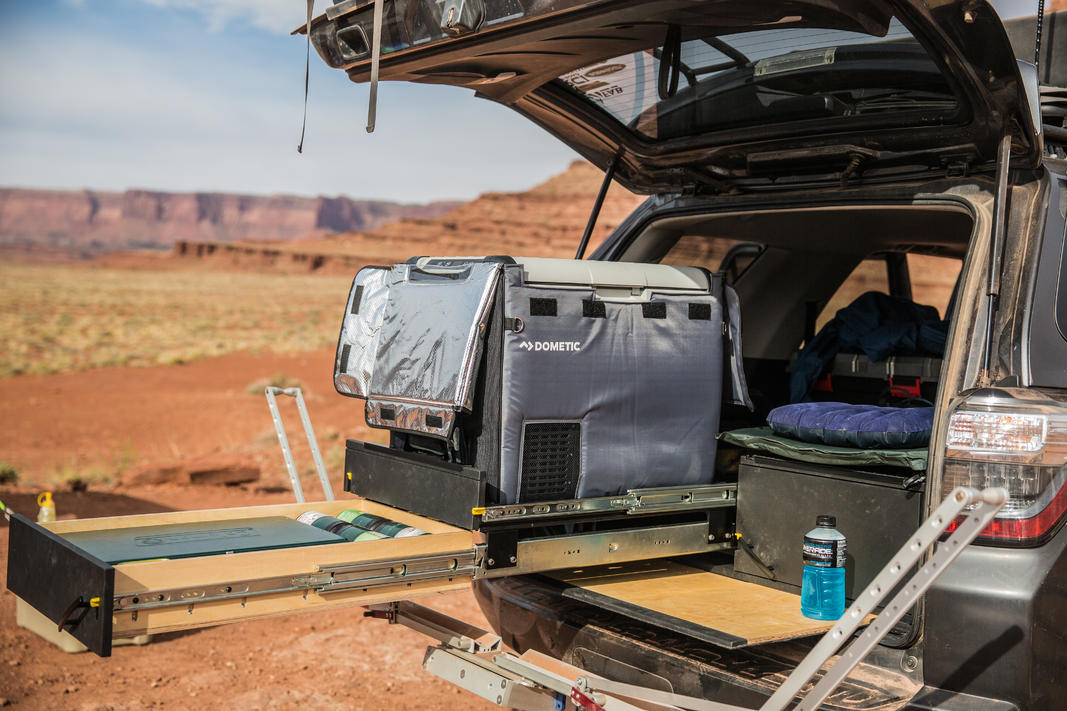

Worked out perfectly on my trip to Moab. Survived the 80+ white rim trail, still quite and solid

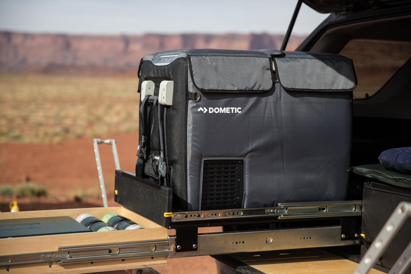

Man those look great! Are you using the aluminum for the frame?
the aluminum is for the fridge slides

Which model accuslide did you go with?
9308 lock in lock out
What are those accessory slot rails beside the fridge called? you have some looped attachment points fitted in it.
Took me forever to find the actual name, even places selling them would just call them tie down rails, which did me no good. They're called S-Track or L-Track (I believe there is a difference but its negligible) or the more generic 'Flanged Airline-Style Tack'
Very nice. I've taken some thoughts and inspiration from your first build into my own design; been in the design stages since October and in s-l-o-w fab for a few months now myself. Curious to see some more of the build, good stuff.
EDIT: I hadn't realized on my phone that you removed the lower sill section out back. Looks like that netted you a significant and impressive amount of extra space. Nice!
If those are "semi professional" then my hand built drawers are full mediocre. Wow...amazing craftsmanship! Post up some more pictures, I would love to see the full design.
What the 2 below said, L track, gotten them off eBay
Bought mine here L-Track Tie Down - Airline Track Cargo Tie Down Rails & L-Track Straps
they come in different colors as well. buy more tie down hooks then you think you'll need. Home depot sells them in 12" lengths and the quick attach hooks as well. The "double stud with o ring" ones are super solid.

Yeah, I had planned to take my time on this and didn't want to rush like my first drawers. But with my Moab trip in May, I need it done sooner. Took me about 5 weekends. I had 1 small piece that held me back over a week. Yes, I gain quite a bit of space from the 3rd delete and that was the while intention. I couldn't stand the limited space with the 3rd row. Heck, I can even sleep in the back if I had to since I gain an additional 4" vertical space.
