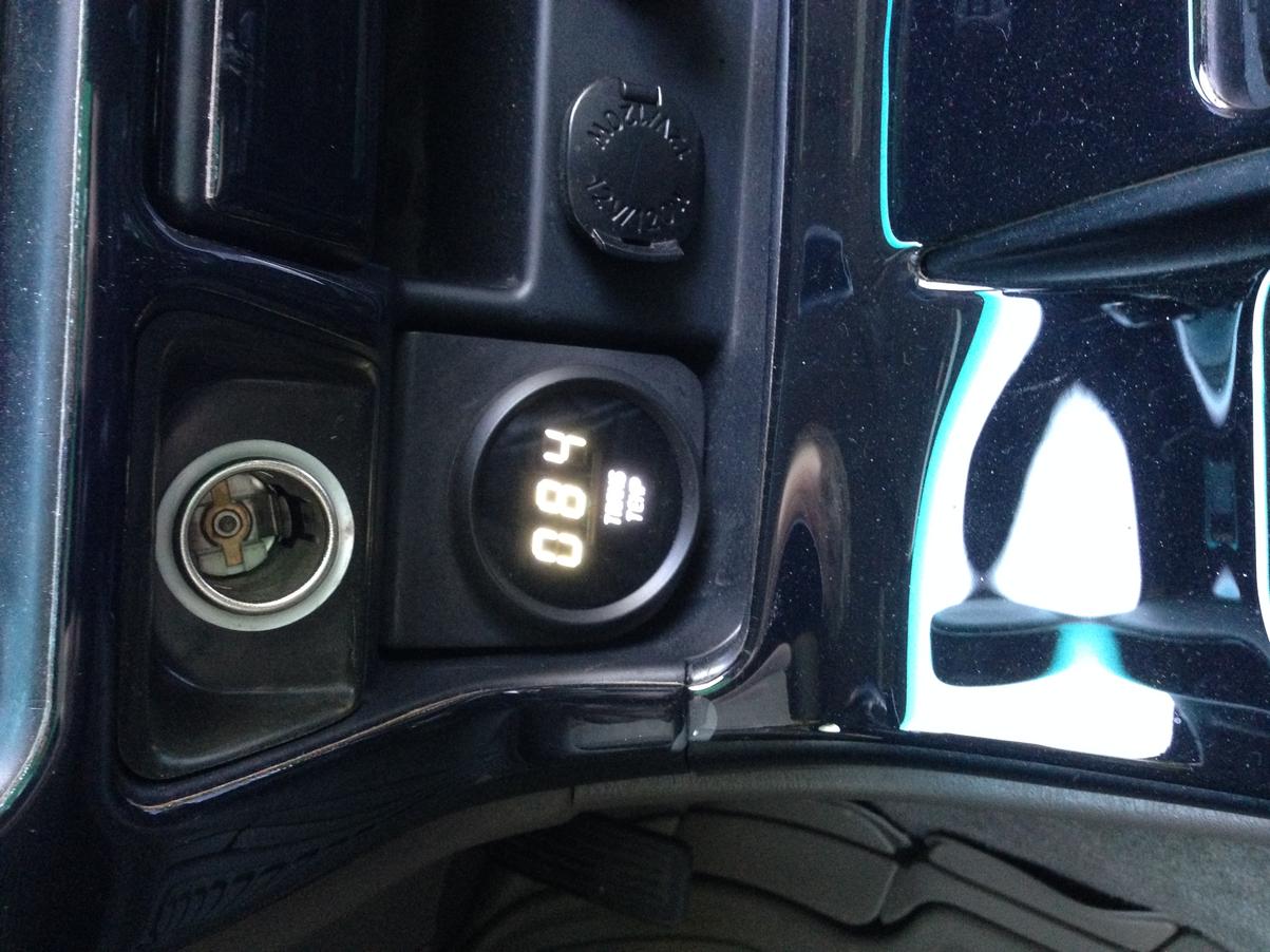

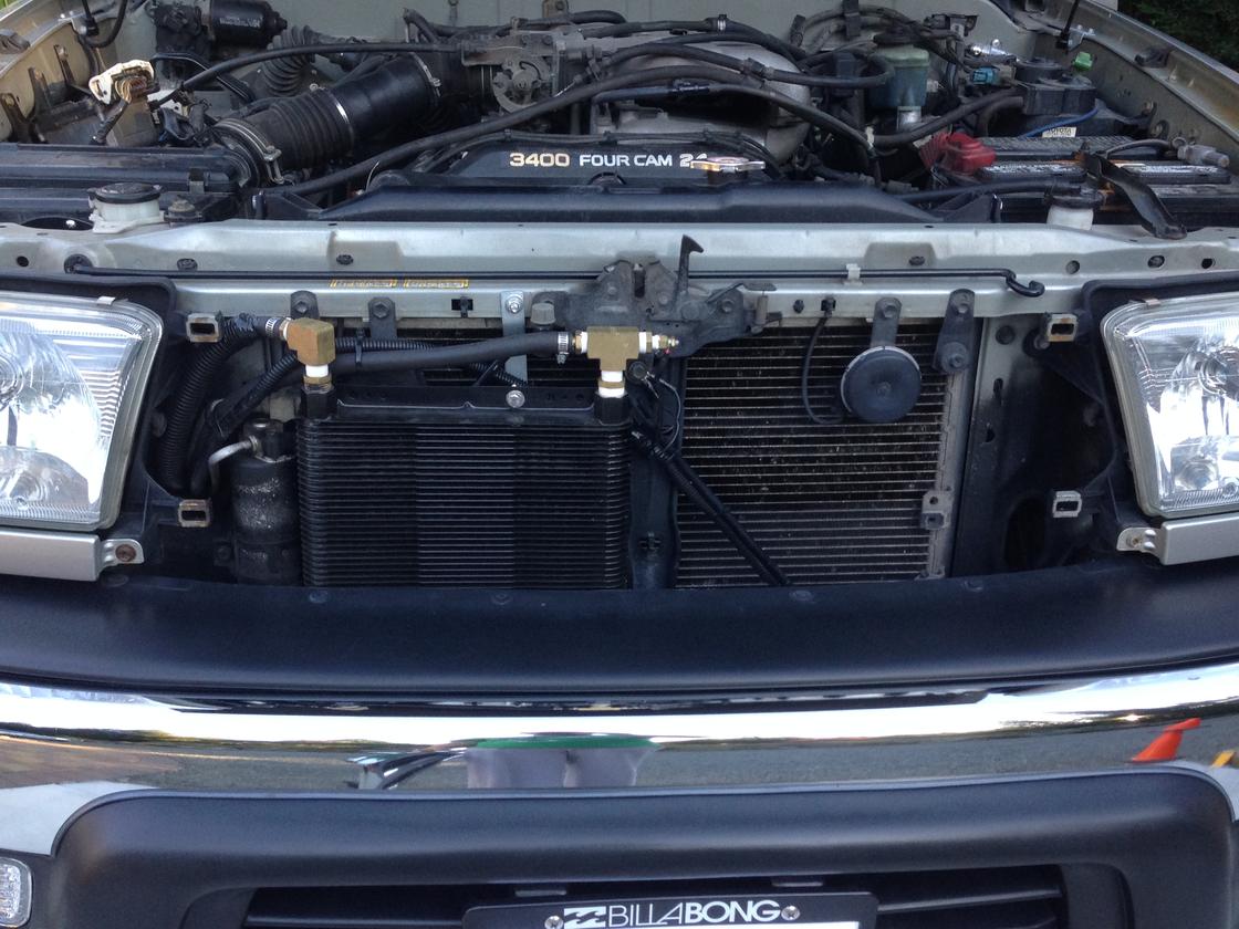

I run a B&M 70274, its got a 29,200 BTU rating. I really gotta push her to get over 200F..... and thats loaded down too. Generally see temps under the mid 100F.
Couple pics there with the cooler and the temp gauge i set up.
