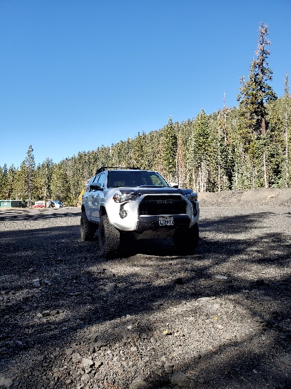

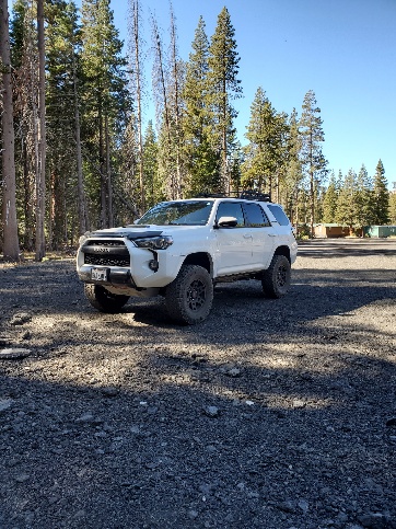

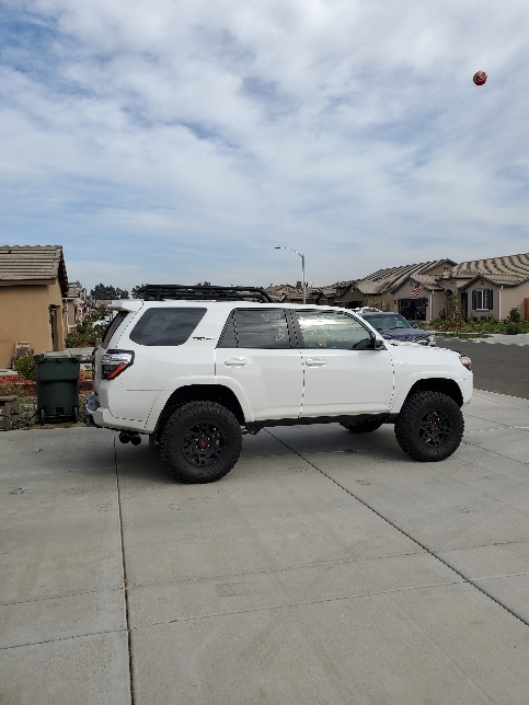

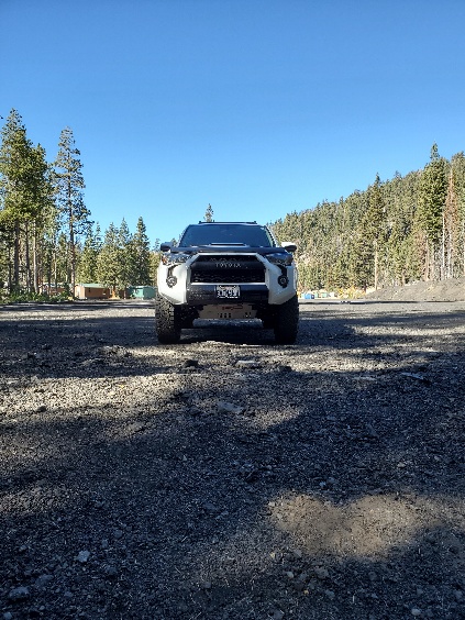

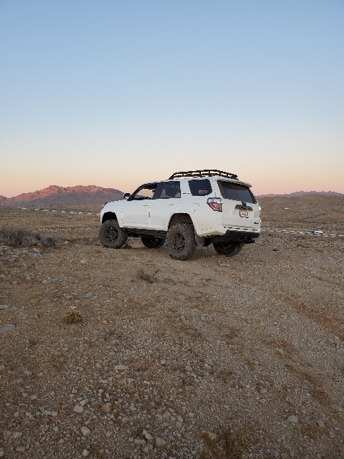

Hey guys! So I actually did it when no one else would and it worked beautifully.
I have a custom 3" front and 2" rear lift and to help with alignment/CV/axle i got a bigger stronger UCA and differential drop kit.
The 295s are now not even rubbing when offroading at full turn, the truck drives the same as stock and the alignment is absolutely perfect.
I'm told Jason is putting together a package to make this option available to all 2019/2020 TRD Pro owners. The shop owner even said 305s could go under there now if I wanted.
Enjoy! And hope this helps all TRD Pro '19+ guys out there looking to turn there stock truck into something that turns heads even more and performs even better off road.
