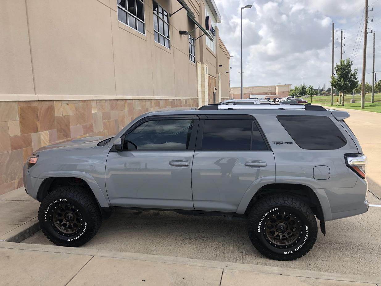

I ran spacers on my 2006 SR5 for like 8 years and never had a single issue. However, on my 2006 SR5 I did notice that the ride got a lot stiffer, I had more body lean, etc. Overall I sacrificed ride quality but it looked a lot better so it was worth it to me. On my TRD Pro that is not the case whatsoever. I didn't notice a single change in ride quality, body lean, etc. It drives exactly the same so I wouldn't worry about it. However, I only did 1.5" in the front and 1" in the rear to give me a total of 2.5/1 because of the TRD Pro 1" already. My 2006 was 3/2 with a 1" body lift so the springs were compressed more which probably contributed to the change in ride quality. As long as you don't put huge spacers in there I wouldn't worry about the ride quality or issues with parts.

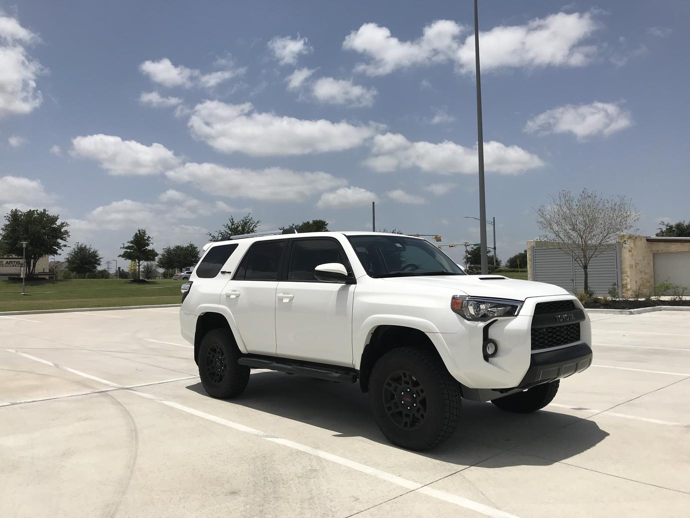

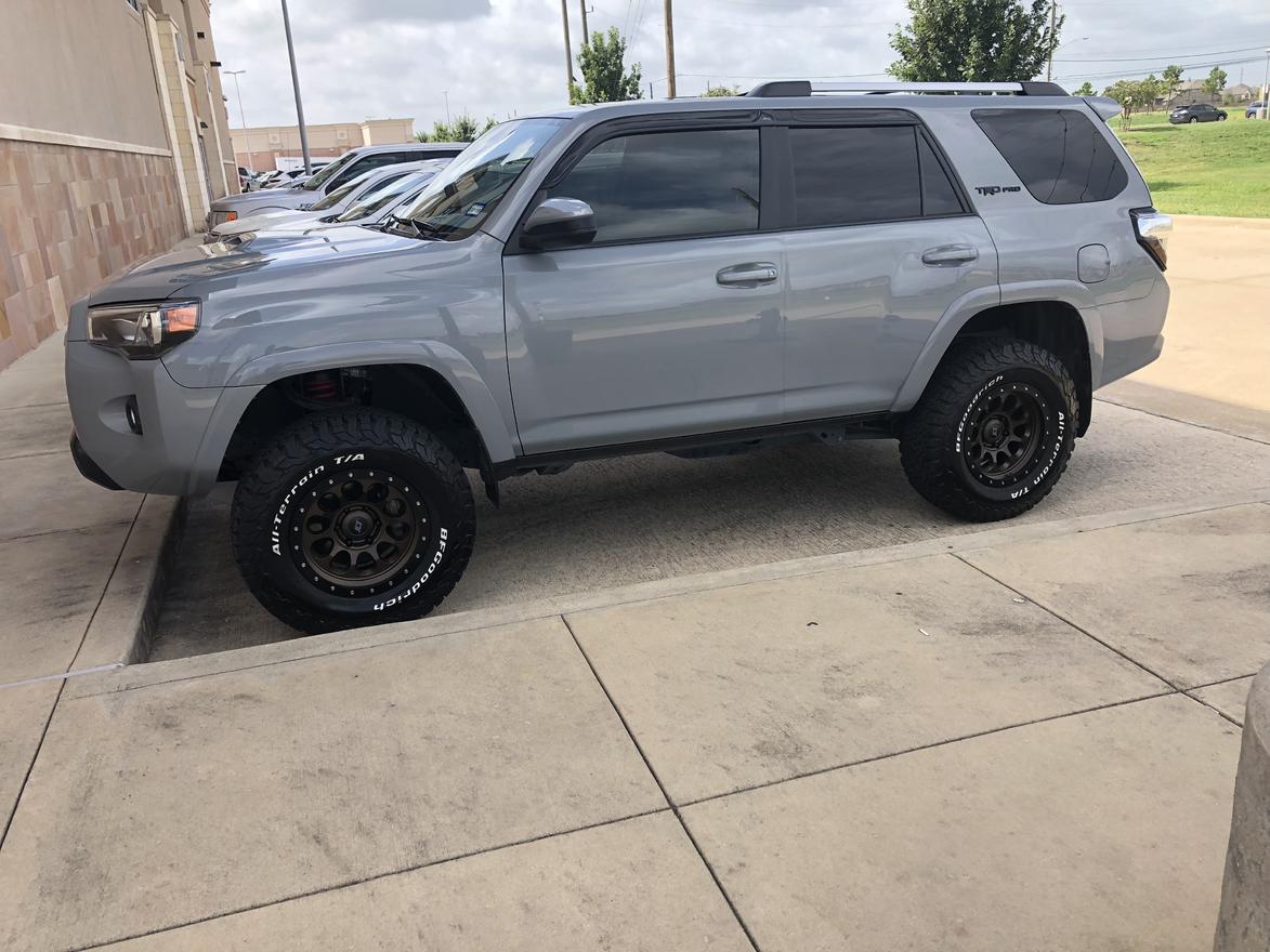

Here's an updated photo with 4 of the same sized tires lol. I love how this sits now!
Above is the 1.5/1 we sell, on the pro.

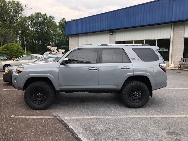

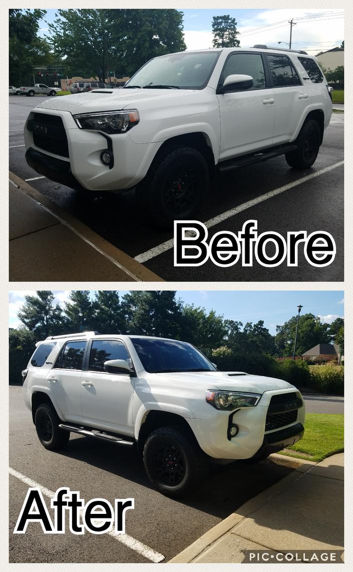

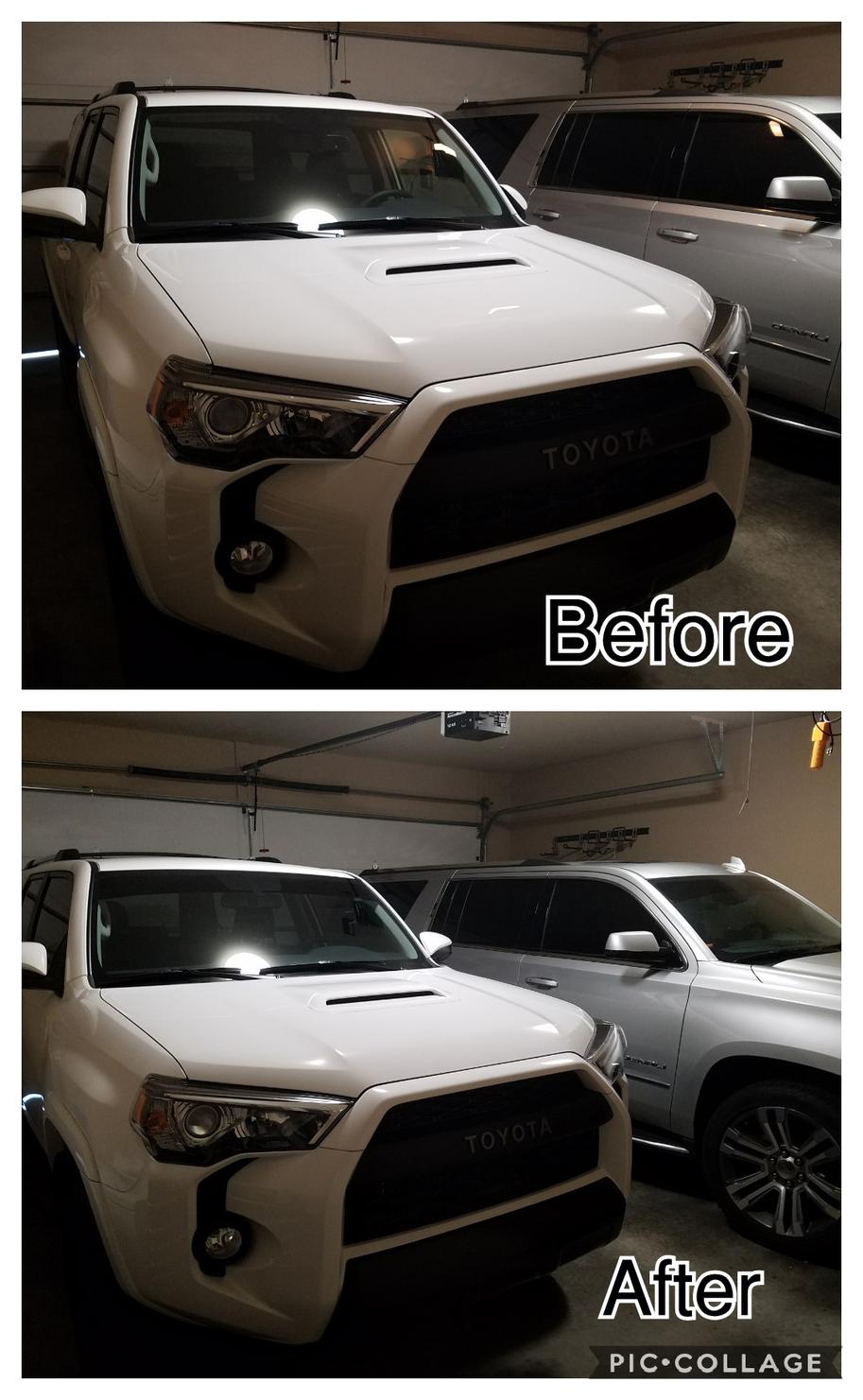

Thought I'd show you guys a recent install of our 2/1.5 kit, on TRD pro stock wheels and tires.

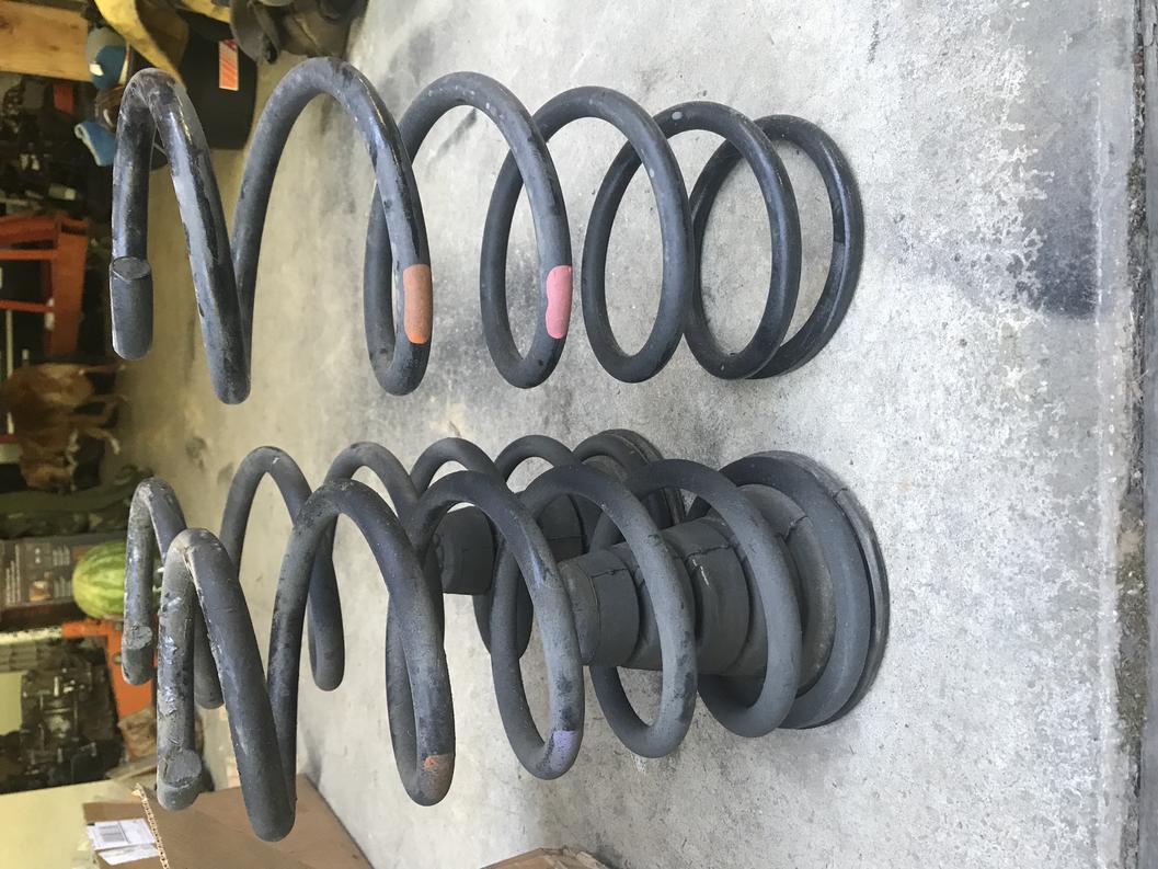

Here is the rear le spring vs trdp, mileage varies a lot between the two but the front was sagging more than the rear for sure as we never really have any cargo in our vehicles nor continuous added weight.

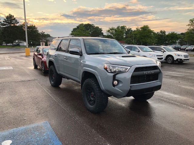

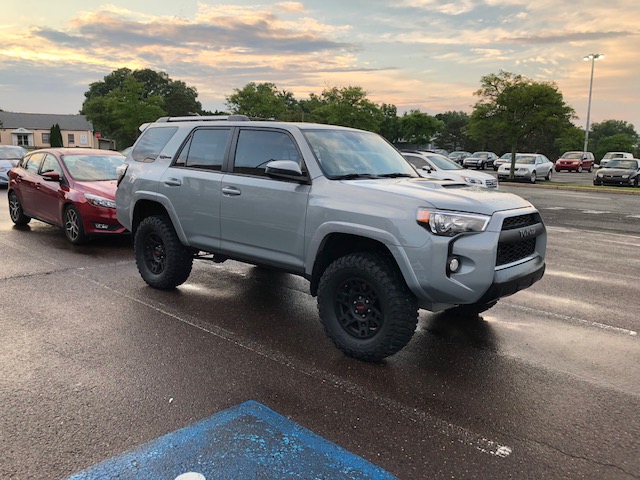

Cornfed 2/1.5 Spacers. BFG KM3s. 285/70-17s. Perfection.
