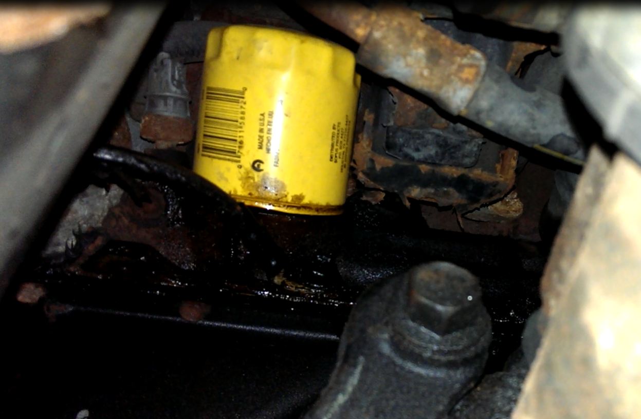

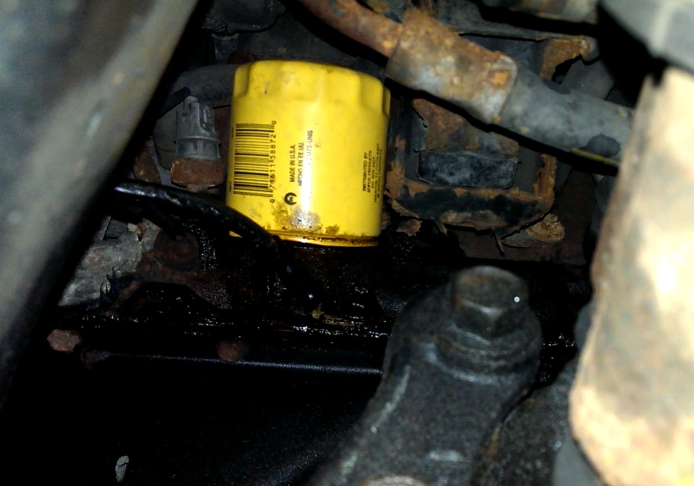

My friend changed his oil once and the old oil filter gasket stuck to the block and of course didnt seal when he put the new filter on, almost lost his eng.

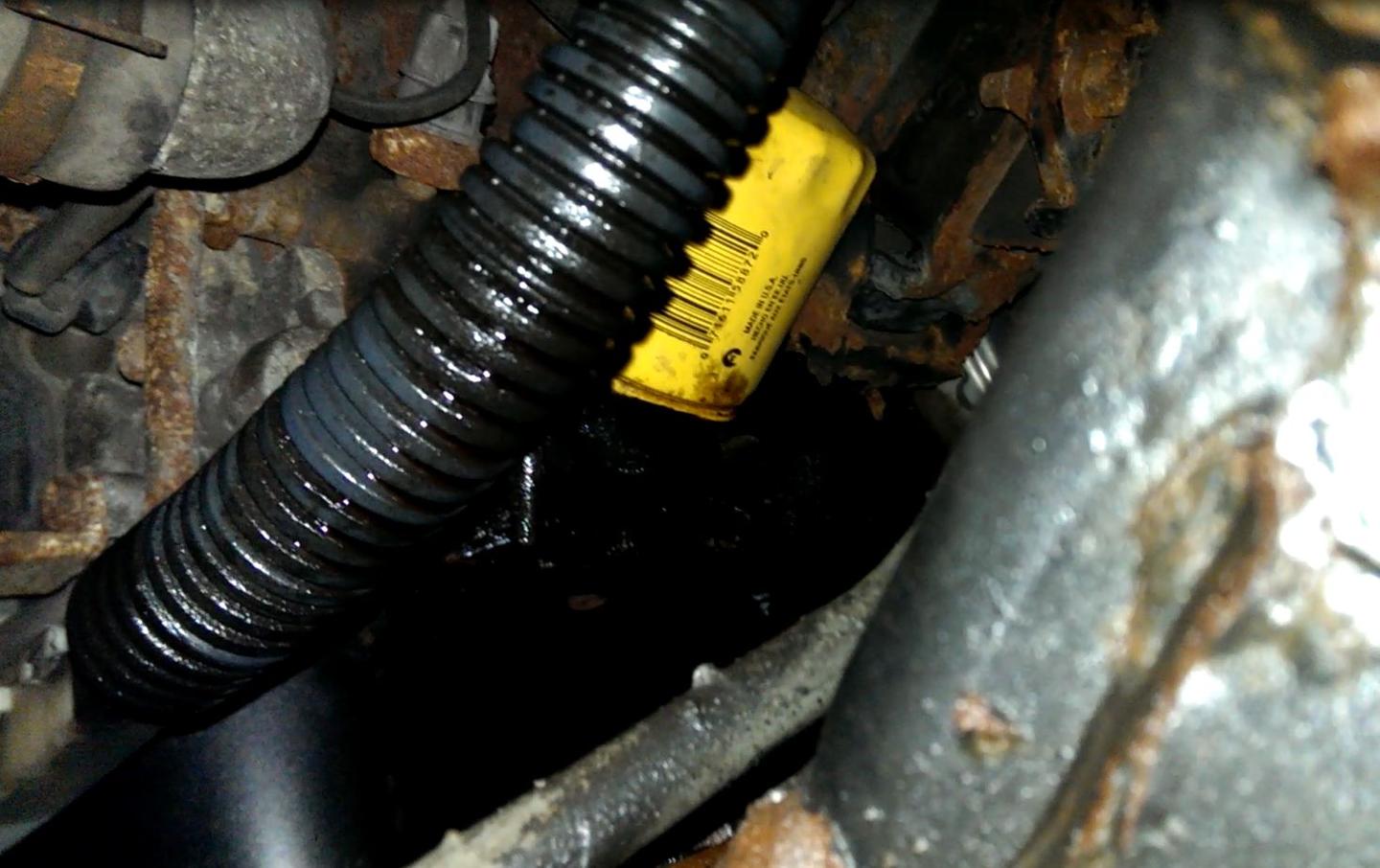

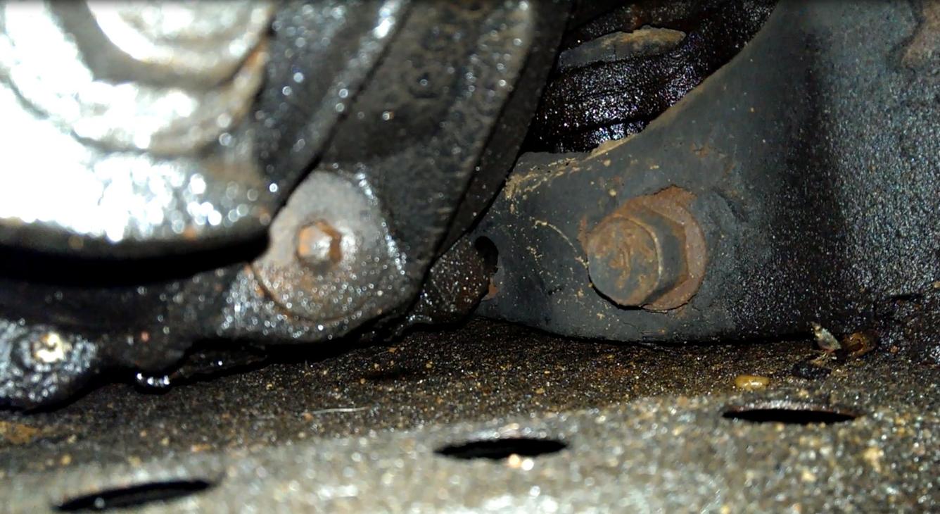

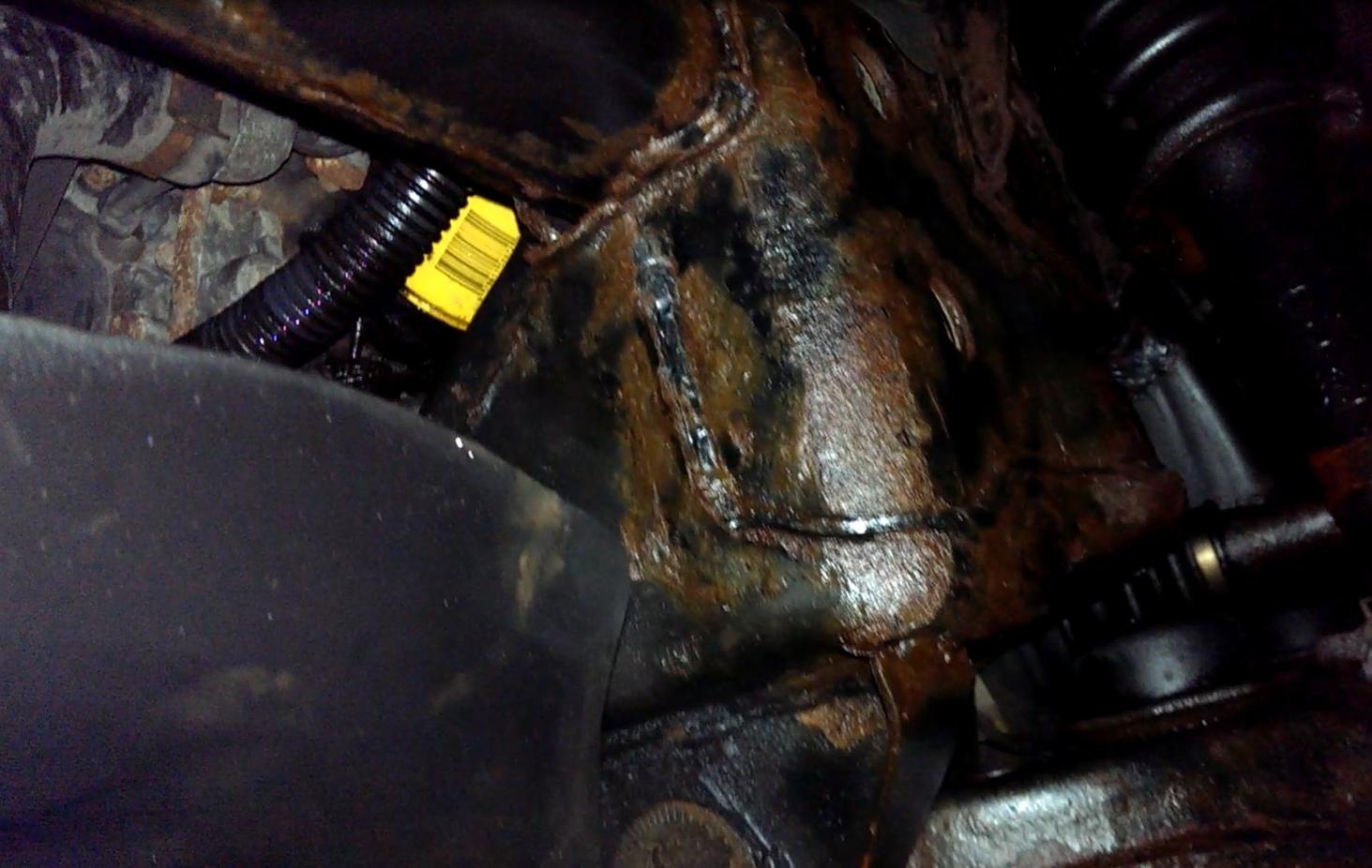

I've got a brief update.
I was able to crawl under the truck tonight and poke around.
I'm leaning toward it being an oil filter leak (for a few reasons).
- Brakes feel good- brake fluid booster/reservoir is full
- Garage floor is stained & water beads on it (sure looks/behaves like oil). When I put enough water down to puddle, there was a thin layer of pearlescent/rainbow oily fluid on top
- Power steering feels good (very light) and fluid level is normal.
- Turning the wheels full-stop produced no fluid under the truck near the bars or boot
- Didn't see any fluid leaking from the R&P
- I'm not ruling out the diff, but there is fluid well above the diff on the left side of the eng. block (below the oil filter)
Here's a video I took while under the truck: The Leak - YouTube
(Video is still processing so give it a minute if you're viewing shortly after post)
I've attached some stills from the video as well.
I'll pull the skid plate off tomorrow and do an oil & filter change. I should know pretty definitively during the filter change if that was the culprit.
Thanks to everyone for the input. I'll update again after a filter change and some light driving.
P.S- How bad does that rust look? I've only had the truck for about a month, and it's my first 4Runner, so I'm not sure how much rust is "acceptable". It appears to be surface rust, but I'd like to know if I should be worried...

To the OP - What a mess. Better than CV axle money shots. Hope your filter fixes it. The rust looks a little worse than my '96. Don't want to be a Debby Downer but have you checked the inside of the frame on the rear passenger side where the muffler is? Please tell me there's not a rust hole there.
