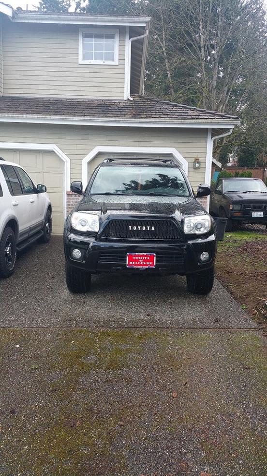

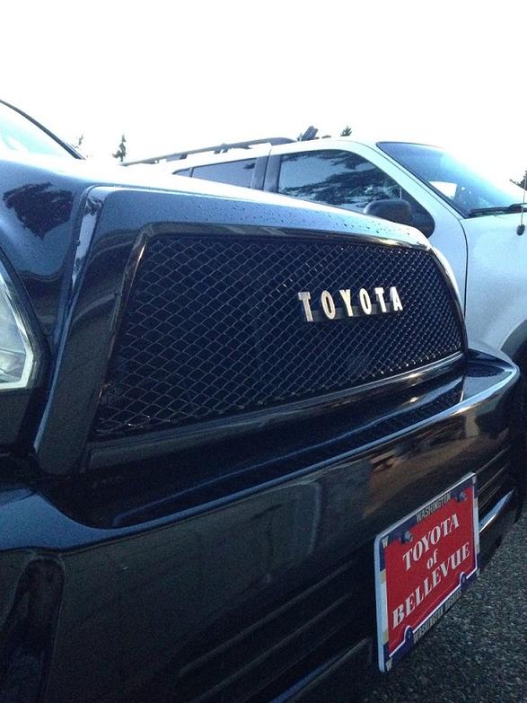

Went relatively well, i had about 4 very brittle plastic stand offs behind the metal bottom rail that broke just by unscrewing their self tapping screws. Had to repair and i did some other mods to it but it is very stiff now. Anyways here are my results:
Looks great! You did an awesome job! How long did it take from start to finish? Thanks for sharing :)
probably 5 hours or so of actual working, then letting the epoxy on those standoffs cure overnight and part of the next day about for about a total of 18 hours. I used really heavy duty epoxy tho, could have gotten away with less im sure. More pics in my build

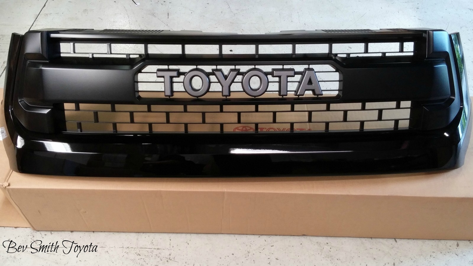

Wish these weren't $250 bucks, would love to see the large center bar with the Toyota molded into one of our grills. I don't know why but I think it would look awesome. (I am new maybe its been done already)

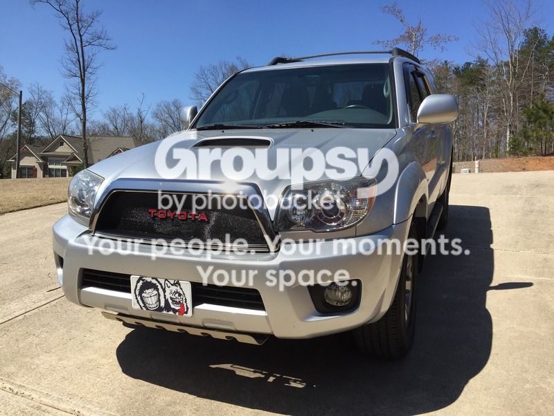

Thanks again, Terri, for the inspiration, encouragement, and for so kindly sharing your knowledge. Love the outcome!
