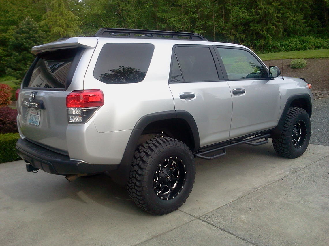

The N-Fab Steps are great for every day use, As far as going hard core 4wheeling in Rocky Terrain I would get a set of Rock Rails. They all are pretty easy to put on. N-Fab does have the rock rail with the removable steps that could be a good option. I like the what I have but am debating going to a Full on Rock Rail for serious off road during Hunting season. But 10 months out of the year it sees pavement the majority of the time and these steps are Excellent and are in the right place. I have a 3 Inch lift so it is quite a bit higher than a stocker with smaller wheels. :ak472:

Nice rig. I like the lift. Unfortunately, I don't have a TE, so the wheel to wheels don't work unless I mod them, as Airwolf and Keemonrunnin have done. I'm still contemplating it.
